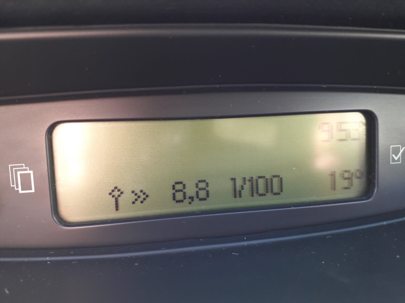

Hi folks and thanks for all the mathmatical discussions. I'm afraid maths just isn't my thing, so I took a photo of the LCD today after a trip out. Here are the characteristics of the trip:
- Cold start-up
- Avg speed probably 60 KM/H
- Country roads
- Combo of 3rd, 4th and 5th gear
- Distance about 7.5 KM
The read-out is as in the photo showing (I think!) the average consumption. Looking at Marc's table, it looks about right, wouldn't you say? But I will certainly look at the plugs, air filter and injection areas discussed.
Cheers guys
John

- Posts: 21355
- x 8158
Re: John's Greek C5
Yes that works out to 32.1mpg which is about right, so the fumes are your only fuel issue to resolve.
