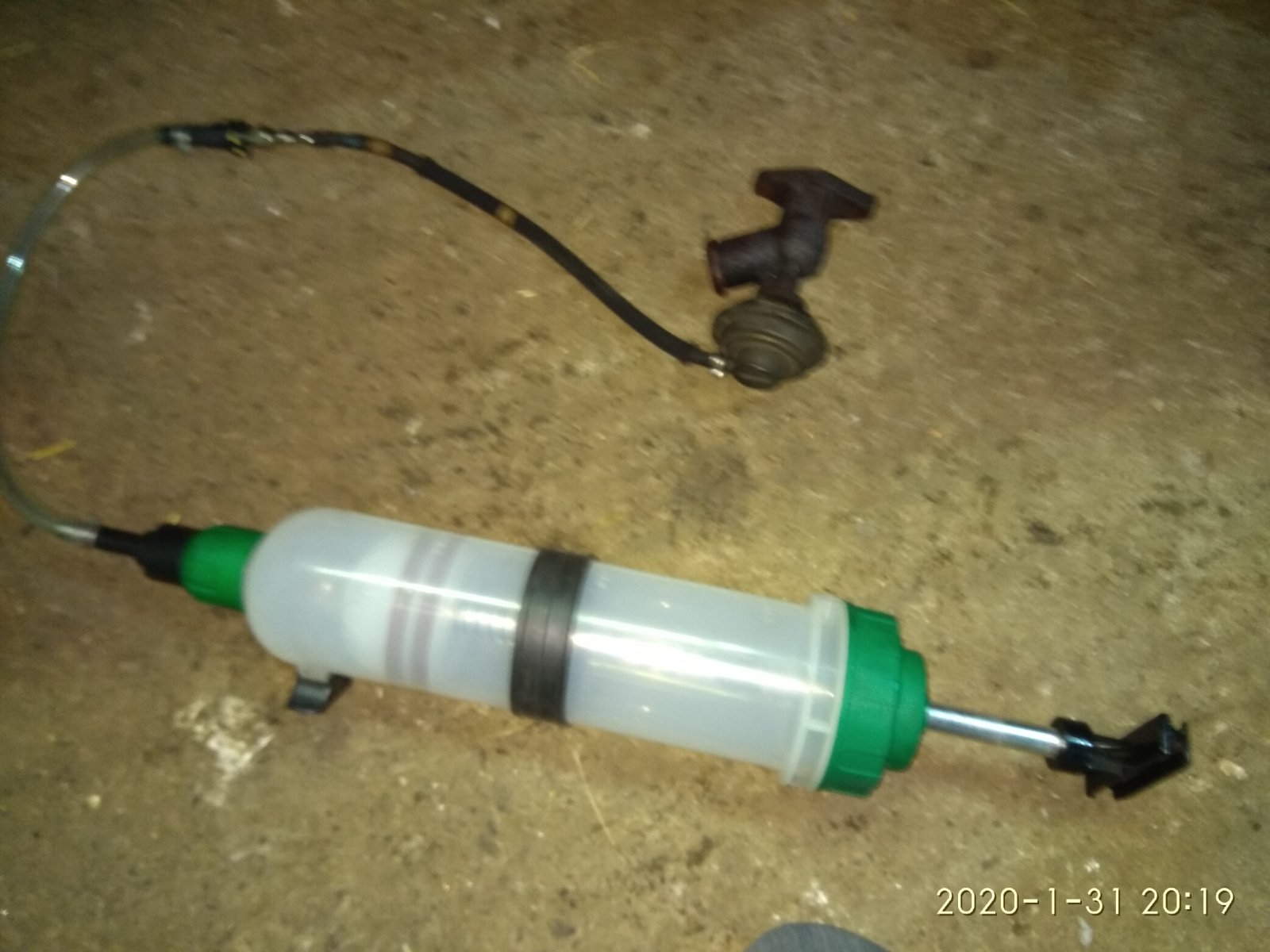

Is there a way to determine the required vacuum for opening the egr? Is it in the specs anywhere - I've tried to manually open it and the return spring is really strong.
I also tried the below and was barely able to move it.

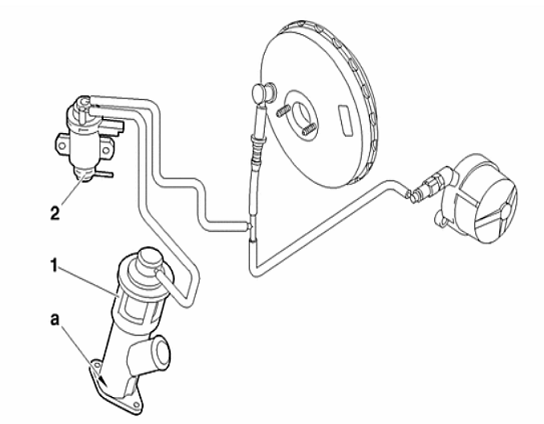

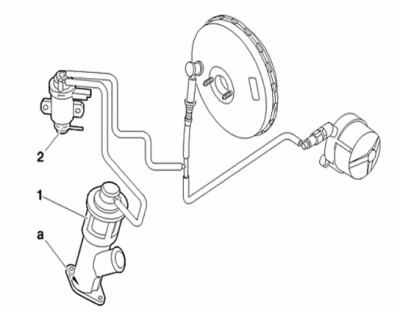

This is what I have:
Connect a vacuum pressure pump to the valve union (1).
Apply a vacuum of approximately 0.6 BAR several times in succession in order to activate the shaft "a".
When the vacuum is suddenly cut off, the valve should click as it returns to its seat.
EGR Electrovalve check:
A vacuum check can be carried out between the electrovalve (2) and the EGR valve (1).
Connect the vacuum pump between the electrovalve (2) and the valve (1).
Compare the values read with those of the table below.

Back on the road again. Idle is massively improved now. Almost no hunting at idle now. Car seemed a bit more sooty at idle though. Checked egr before putting it back on and was able to be driven open by a vacuum of less than 7psi and was able to hold the vacuum (gradual lid off vacuum, but that is accepted according to the you tube videos).
Took it out for a drive and the acceleration seems better, although that might be placebo affect.
Still to clean out the inlet but the spray hadn't came through yet, so that will be done next week.

Whilst diagnosing the P0110 fault (which is part of another thread) I decided to test egr electrovalve with a newly purchased vacuum tool just to see how it works.
At idle, there is no vacuum being produced. On the out from the electrovalve into the egr. There is a very healthy vacuum being produced from the engine up to input.
Is there any additional criteria for this electrovalve to be activated?
Marc's post defined that at 780rpm it should produce 0.5bar, but no additional steps in the test.
I have run the test from Lexia on the egr electrovalve and all it seems to do is fire up the relay unit beside the electrovalve.
