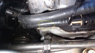

I had another look at this today, and noticed (the bleedin obvious) that the low pressure fuel line is damaged:
I can't actually detect any fuel coming from the visible split, but it is in the general area, and I can't find a leak anywhere else...
I don't know whether this is a single or double wall pipe, and I don't know if it is practical to fit a new length of hose to the fittings, or whether to take a deep breath and find a proper replacement.

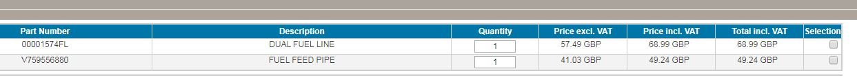

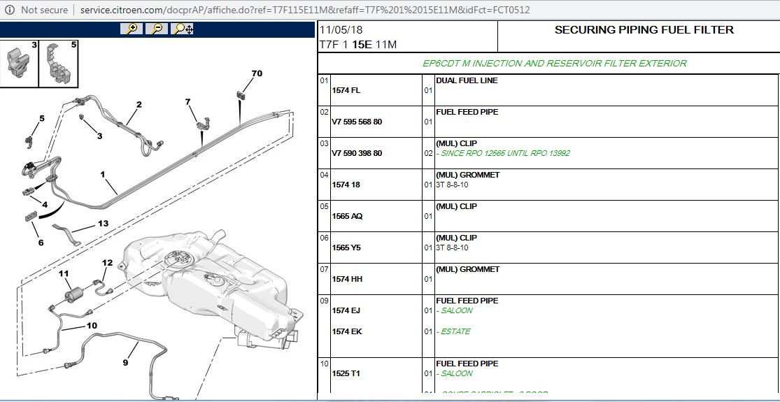

If in doubt always look for the obvious!
Appears to come as a pair, not clear from your pic whether it's the short bit across the engine, or the long bit from the tank, neither are too expensive (well, in the UK anyway!)

It is the short pair that run behind the engine.

I have again had the manifold off to find the fuel leak, and I am fairly sure that the low pressure pipe, although visibly damaged is not the source of the leak.
Firstly I wrapped the damaged section of pipe with some wide plastic conformal tape, not because I expected it to hold in 5 bar of pressure, but because any leak would find a way around the tape and make itself more obvious. It hasn't.
