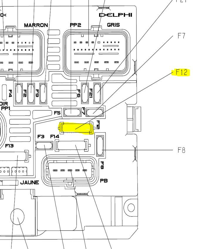

Re: X7 intermittent wipers - fixed - I hope.
Unread post by Peter.N. »
According to the handbook the fuse for the wipers is 'F12, 30a' in the engine fuse box. There are two 30a fuses but I cant see any indication as to which is 'F12'. While I was investigating the wipers started, I tried pulling both fuses but they still went on working. :? :( :oops:
x 6961
I've marked it in yellow for you:
Posts: 11774
Joined: 02 Apr 2005, 16:11
x 1240
Thanks for that Marc, I will have another look - when it stops raining.
