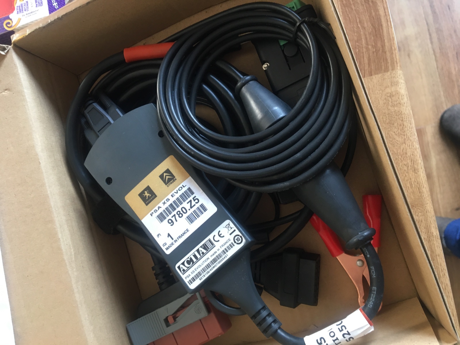

I wonder if my mates old Lexia will work with my 2008 C5?

Can you try it out? You’ll soon know, once you hook it up and run a global diagnostic. If it shows communication with all the ECUs, then you’ll. be good to go.

I’m picking the Lexia up tomorrow morning. The existing software disc is labelled.........
V22.14 and V45.
V22.14 and V45.

Right. Just picked up the Lexia programming interface from my mate. I’ll get the software set up and see where we go. If I can open the interface casing I’ll have a quick look as I’m curious re the CAN interface chips.

It will be easier to just attempt a global test without opening it up - if there is no communication with ECUs then it won't be compatible. Bear in mind there will be some entries that may show - like a Trailer BSU unit - which is fine as the interface is there but unless fitted, won't communicate. We're more interested in ECUs like the ABS ECU, the BSI, the Suspension ECU etc. These are the usual ones that will not talk with an older interface.
Opening up the unit, can in some cases cause issues (strain on the wiring / solder joints). So I would suggest you don'y open it up for this reason alone.
