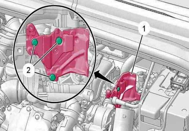

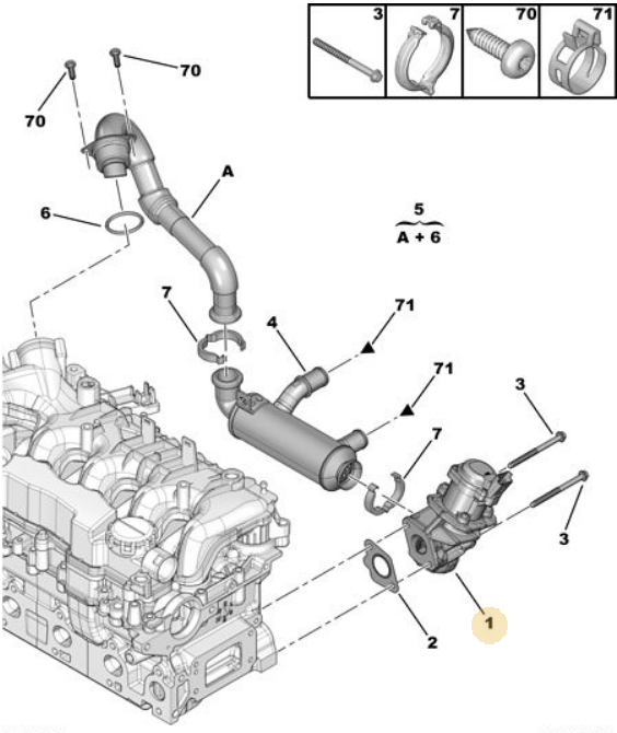

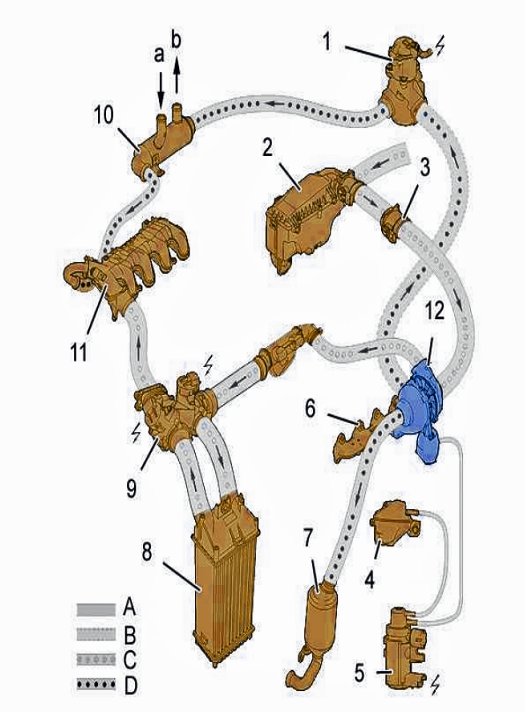

Could you tell me the part number for the electro valve please Marc , and whereabouts it’s located on the vehicle?
- x 6957
Re: EGR valve v new turbo

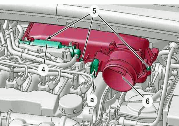

Part number is: 1618NR Item (1) below:

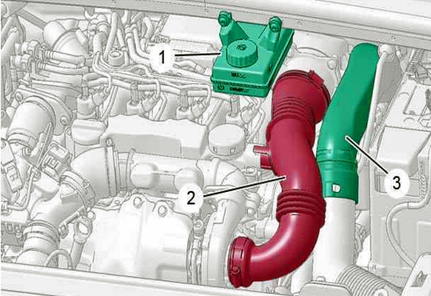

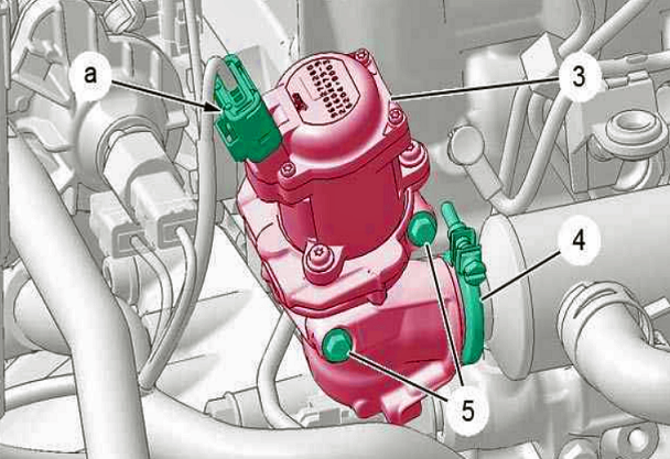

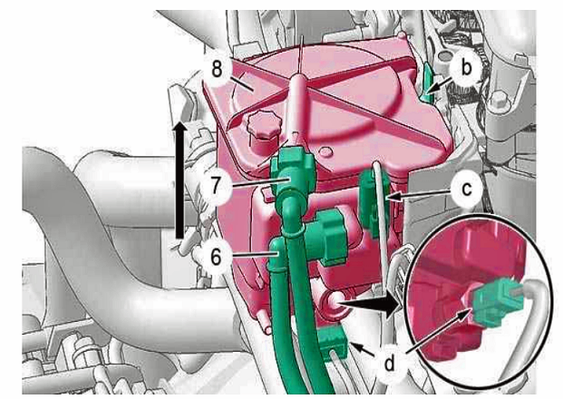

To get to it you'll need to remove the upper air intake hoses and the Fuel Filter. Always replace seals with new ones.
Disconnect the battery following the procedure:
BSI Reset / Battery Disconnect / Reconnect Procedure

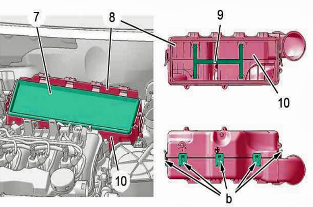

| Remove and move aside the brake fluid reservoir (1). Remove:
| Unclip and move aside the manual priming pump ( 4). Move aside the manual diesel priming pump support. Disconnect the connector (at "a"). Remove:
Remove:
Separate and remove the components (8), (10). | Disconnect the connector (at "c"). Clean the unions (6), (7) using SODIMAC degreasing solution. Uncouple the connectors (6), (7). CAUTION: Plug the openings when a union is uncoupled, using a plug kit. Close the pipes on the fuel filter using a plug kit.
Remove:

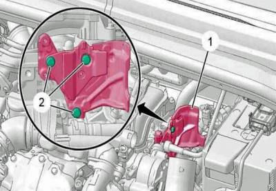

Sorry Marc I think I may have asked for the wrong part , what I meant was the part (number 5 in your diagram).GiveMeABreak wrote: 16 Nov 2019, 12:49 I'll just add a further thing here as simple as I can.
The only other thing I can think of with the Turbo is the vacuum circuit. The electrovalve number (5) in the circuit below.
You've already identified oil - that may be the oil lubrication pipe not fitting properly (or wrong part supplied) or the seals. But I though to mention that if the vacuum circuit is not providing sufficient air, or the filter on the electrovalve is blocked - that can affect the operation of the Turbo.
Key:
A: External pipe.
B: Duct internal to the engine.
C: Air.
D: Exhaust.
Reference Designation a Coolant Inlet b Coolant Outlet (1) Exhaust Gas Recycling (EGR) Regulation Electrovalve (2) Air Cleaner (3) Air Flow Meter - Air Temperature Sensor (4) Vacuum Reservoir (5) Turbocharging Pressure Regulation Solenoid Valve (6) Exhaust Gas Manifold (7) Catalytic Converter - Particle Filter (FAP) (8) Air/Air Heat Exchanger (9) Butterfly Double Air Metering Device (10) Exhaust gas recycling (EGR) Heat Exchanger (11) Air Inlet Manifold (12) Turbocharger

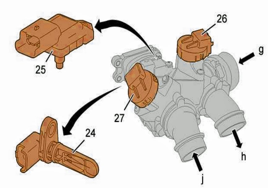

Here is the function of the Air Dosser on this engine for reference:admiral51 wrote: 17 Nov 2019, 16:10 If i have read the diagram correctly item #9 is the air doser, the double butterfly valve that i had on my old C5 now with Mike T( not sure if you have the Vin for that still Marc)
If the air doser butterfly valves are sticking could it cause the fault P0401 ie it works most of the time but when it sticks it could allow more/less air than expected ?
I still think the main issue is #5 the solenoid valve, once that is sorted i think it should be easier to narrow down other issues
Butterfly double air metering device (26) and (27)
Functions of the double butterfly air meter:
- Exhaust gas recycling (EGR)
- Help in particle filter regeneration (FAP)
- Stopping the engine
| Reference | Designation |
| g | Turbocharged air (hot air) |
| h | Output: Turbocharged air to the air/air heat exchanger |
| j | Input: Turbocharged air cooled by the air/air heat exchanger |
| (24) | Inlet air temperature sensor |
| (25) | Inlet air pressure sensor |
| (26) | Inlet air heater throttle (hot air meter) |
| (27) | "EGR" throttle (cold air meter) |

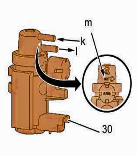

As for the Turbo Pressure regulation Solenoid, the regulating electrovalve controls the boost pressure waste gate.
Role of the boost pressure regulating electrovalve:
- Regulate the boost pressure
- To limit the boost pressure
As for the specifics of the Turbo Pressure Regulation Solenoid:
(30) Electrical connector.
k: Pressure drop inlet for the vacuum pump.
l: "user" outlet.
m: White marking.
N.B.: The white marking indicates the outlet aperture for the turbocharger regulation control.

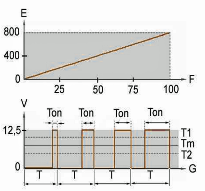

The solenoid control is an OCR (Opening Cyclical Ratio) type control.
The proportional electrovalve controlled by an OCR voltage is connected to the following components:
- Atmospheric pressure
- Vacuum supplied by the vacuum pump
Electrical special features
Features of the OCR signal:
- Supply voltage: 12,5 Volts
- Frequency: 140 Hz
- Fixed period: 7 ms
- Resistance at 20 °C: 15,5 ± 0,7 ohms
- Maximum vacuum: 800 mbars
F: Open cycle ratio (OCR) (in %).
G: Time (ms).
V: Voltage In volts.
T: Fixed period 7 ms or 140 Hz.
Ton: Variable time.
The open cycle ratio (OCR) is determined by the ratio of the variable time ( Ton) to the fixed period (T).
% OCR = (Ton/T) x 100.
The mean voltage (Tm) supplies the turbo pressure regulation electrovalve (1233):
- The greater the OCR percentage, the higher the mean voltage (T1)
- The smaller the OCR percentage, the lower the mean voltage (T2)
- Full supply (maximum OCR) = Maximum vacuum (800 mbars)
- No supply (minimum OCR) = No vacuum (atmospheric pressure)

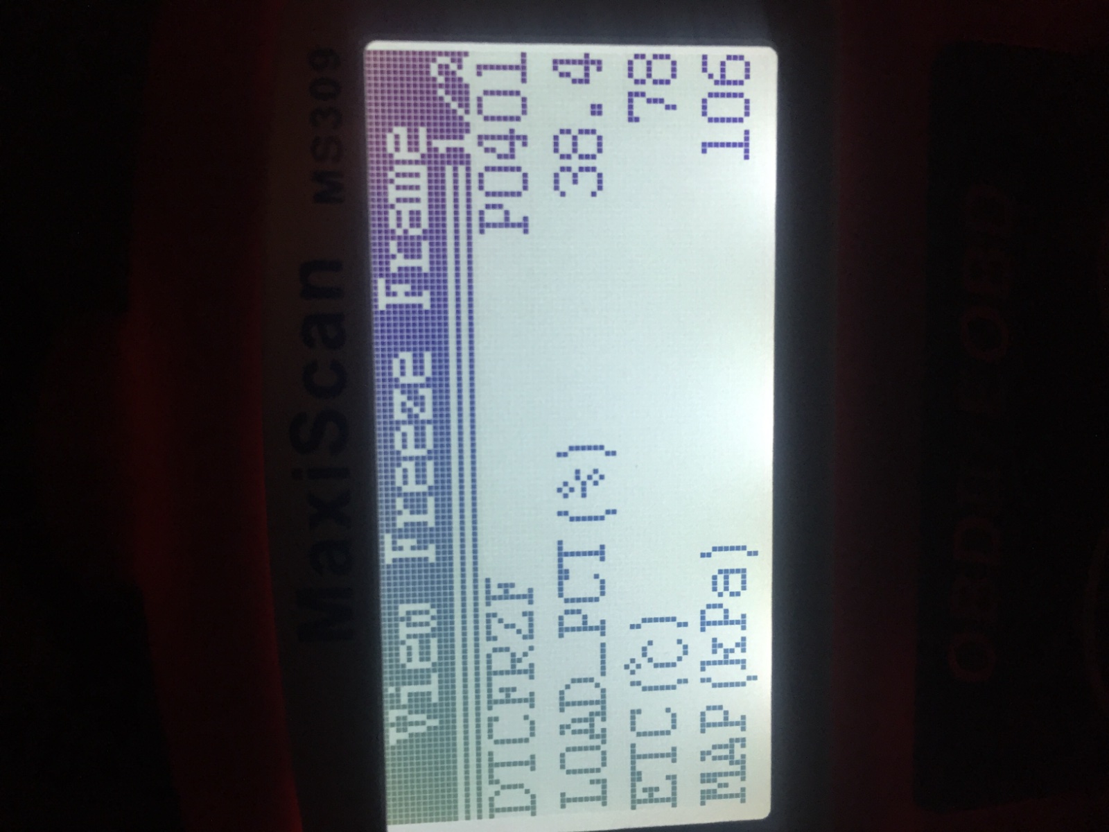

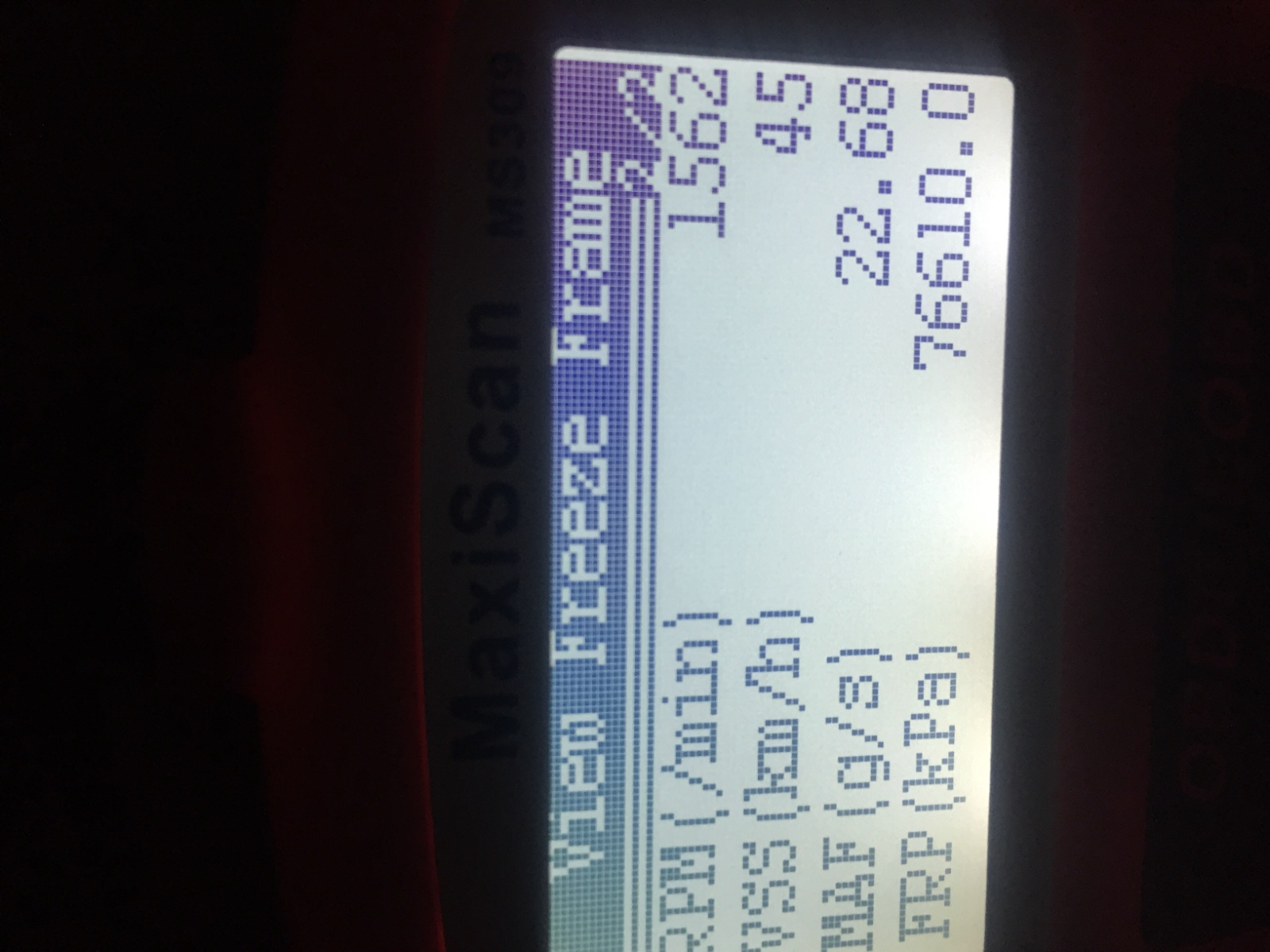

Does this mean anything to anyone ? I know it’s not Lexia, but it’s all I have at the moment.
- Posts: 12585
- x 1488
That's not being too helpful - you really need to get it on Diagbox so you can see what the live flows are, and what the reference flows are, and also check the outputs and positions of the relevant sensors and how they are behaving.
Benscab123
- Posts: 158
- Joined: 09 Jul 2019, 20:33
- x 3
Yeah I thought as much, I’ll try get it on diagnostic in the next few days. Do I need the data to show the instance the underboost occurs ?
