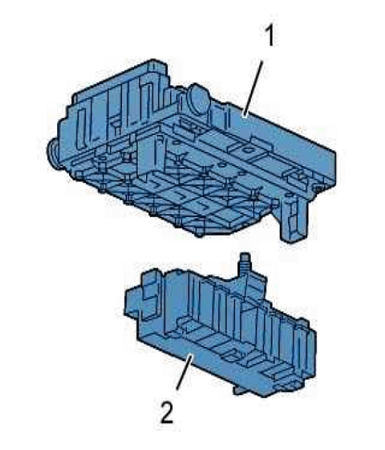

To get to the Maxi Fuses, you will need to disconnect the battery / remove it for better access, and remove the engine fuse box - the Maxi Fuse module is shown as 2 below:
