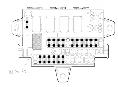

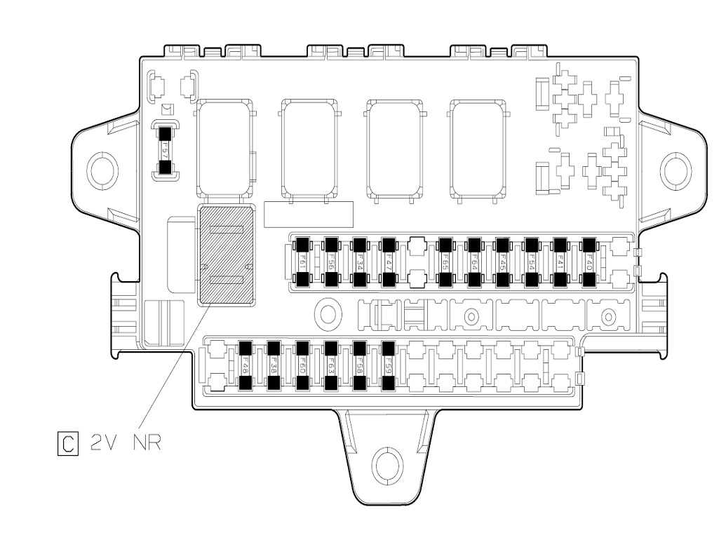

The only fuse F38 I can see is listed under the PSF0 box Dave - but knowing how they love to change things - it may be in another one - so check all of them - but should be a 20 Amp.
Here's another picture of the box - showing the other fuses - so see if you can match it up with the others as a reference: F38 is second from bottom left.

Ok so That fuse on mine is located in the fuse box on the drivers side and is fine although I will try a different one in there as have plenty of spares.

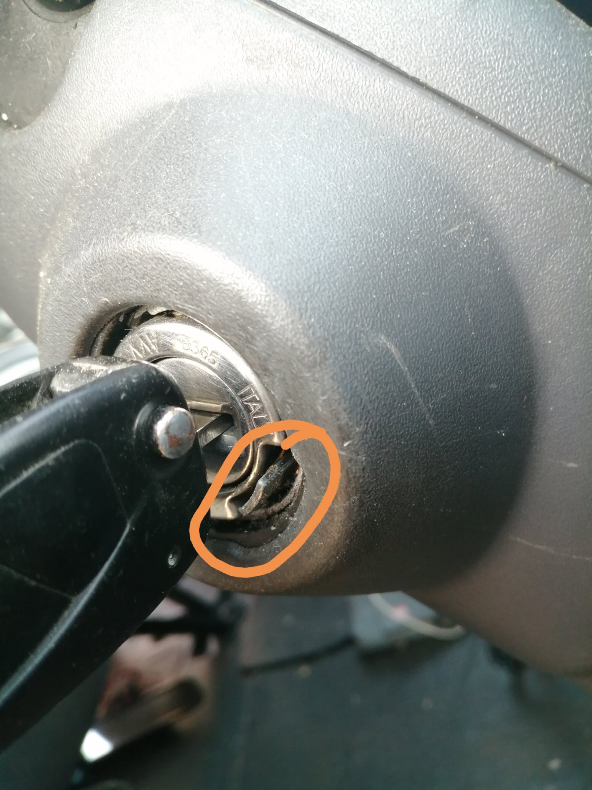

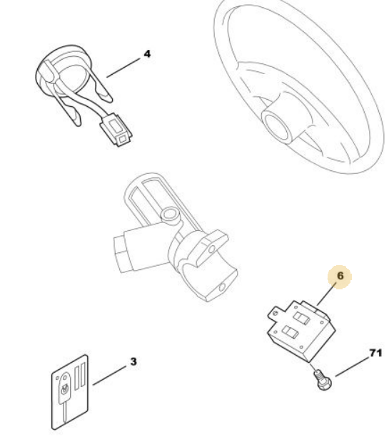

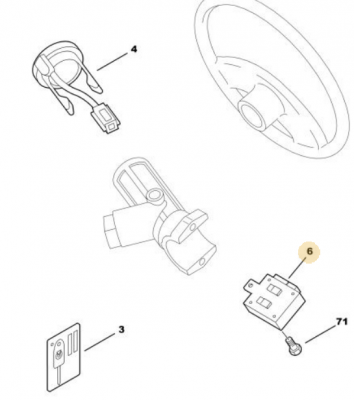

The barrel / key blade is independent from the immobiliser. Just be careful not to knacker the transponder ring shown at 4.
The key fobs contain the transponder chip. You can't code a new fob with a generic code reader.
These Relay IIs have a different synchronisation procedure of the keys....

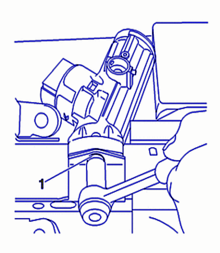

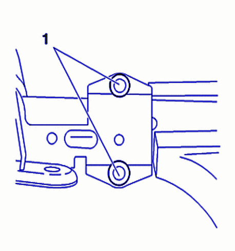

There is nothing I have on the tags of the ignition barrel, but this is what is involved in replacing the lock only: Note, that to get to this part below, the steering wheel, steering wheel controls, and steering column etc. also need to be removed. I haven't put those procedures up now as they are a bit involved unless you specifically need them - let me know.
Do you have breakdown / recovery cover to at least get it looked at or recovered home / to a garage?
Steering Lock Replacement only: (requires additional component removal beforehand).
Disconnect the battery.
Remove the steering column (see the relevant operation).
As for the codes - Yes, those are the ones that a diagnostic system would need for the operations described in my last post.
As for the steering lock, I know you probably have already, but try some very gentle movements to the left / right as you try the key.
| Removal: Place the steering column in a vice with soft jaws. Punch an initial indentation on each bolt head. Drill and extract screws ( 1). Remove the ignition switch (mark the direction of fitting). | Refit:
Refit the steering column. Reconnect the battery. |

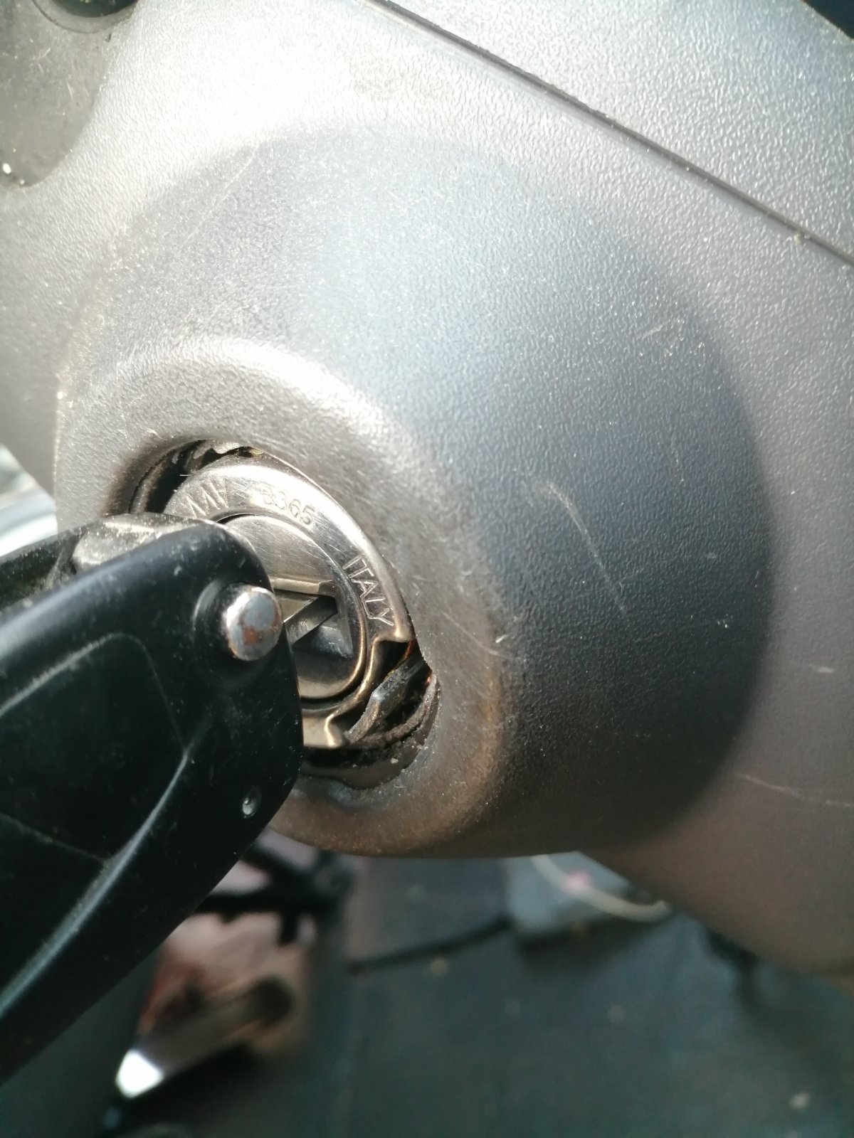

This is getting weirder now, I can turn the key as far as the ignition coming on, dash lights on, systems boot up but if I let go it all goes off again. Still unable to start the engine. Think I'm going to drill the lock today so I can at least take it somewhere.

Didn't need to drill it in the end as I realised I could just pull the whole barrel out of the casing.
If I where to change the complete ignition assy would I be able to get the existing chip changed from the current only key I have that deals with the immobiliser or am I still going to have problems starting the van? This morning I got the key to turn the ignition on but it wont turn the engine over, battery is fine the ignition barrel is knackered.
