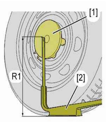

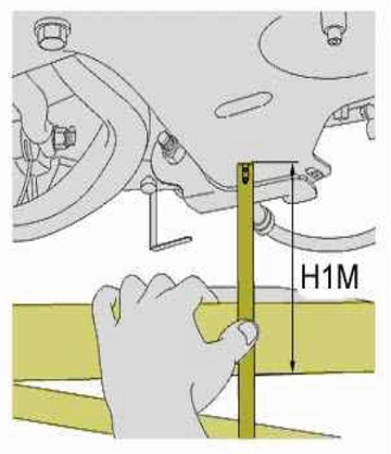

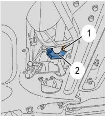

Check you have the positioning correct - one member recently had the thing attached back to front .....
For the front:
Wheel radius measurement
Measuring the front height H1M
Calculating the front height H1C
H1C = R1 - 140 mm .
R1 = Front wheel radius ( mm).
Compare:
The value measured H1M
The value calculated H1C
Adjust the front height if necessary.
This is the nechanical pre-adjustment - you will need a Lexia diagnostic tool to programme and fine tune the height correction. But this should help ensure you have at least got it where is should be:
Tighten the bolt (1) to 0,6 daN.m.

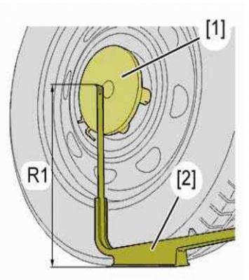

For the front:
| Place tool [1] (or similar) over the wheel screw heads to determine the wheel centre. Measure radius R1 with tool [2] (between the wheel centre and the ground). |

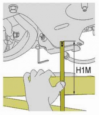

| The front height H1M is measured between the ground and the subframe, at the rear of the suspension arm front fixing yokes. |
H1C = R1 - 140 mm .
Compare:
- Loosen by one turn the screw ( 1) on the collar (2).
- Retighten the screw by hand.
- To decrease the height, turn the collar ( 2) towards the front of the vehicle.
- To increase the height, turn the collar ( 2) towards the rear of the vehicle.
