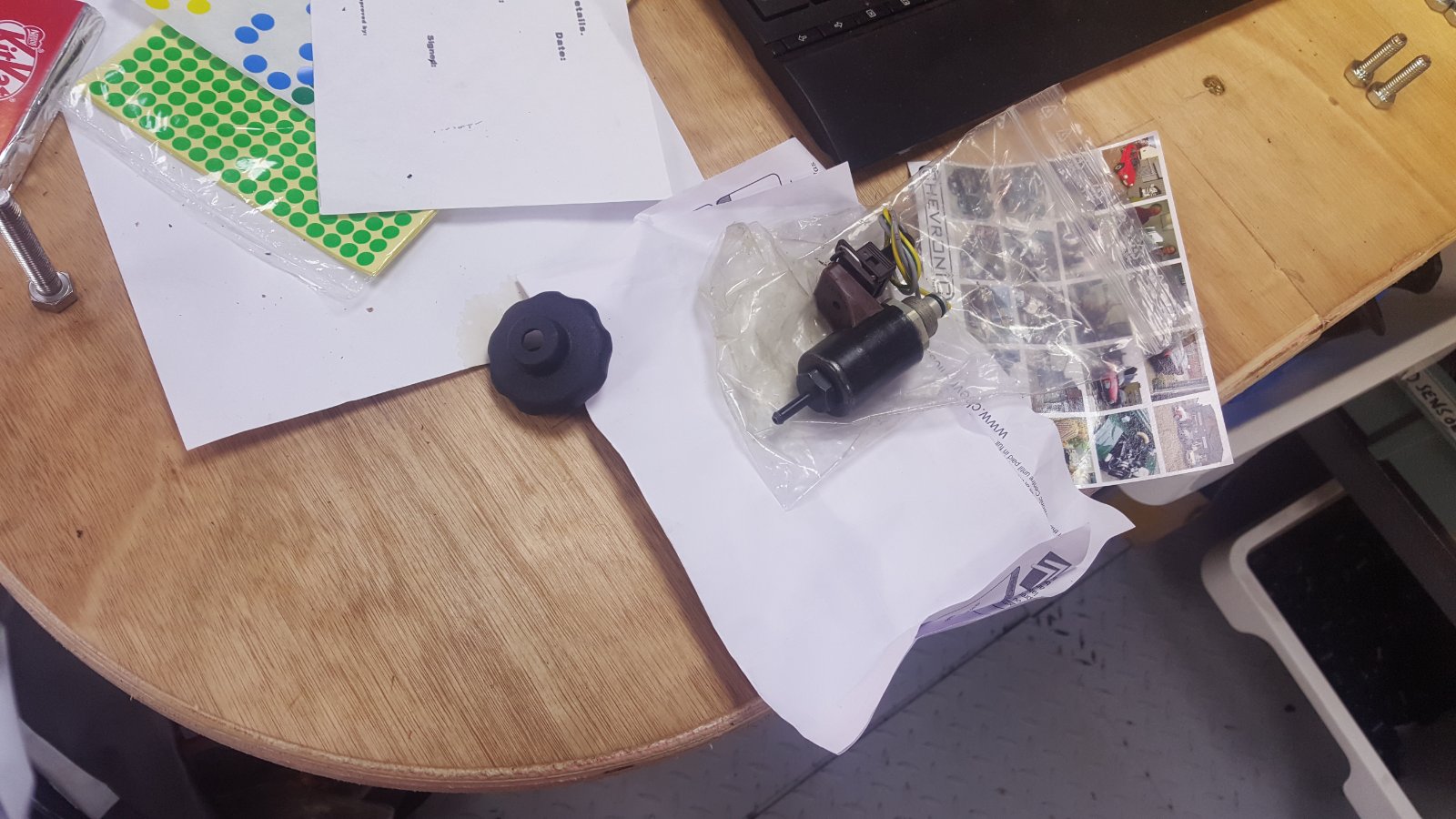

Anyway I have now received the electrovalve from chevronics - nice quick delivery.
Curiously the item is the modified late type but it already had the correct pipe union fittings as i tried the pipe in it to check. Maybe someone had already fitted it to an earlier car.

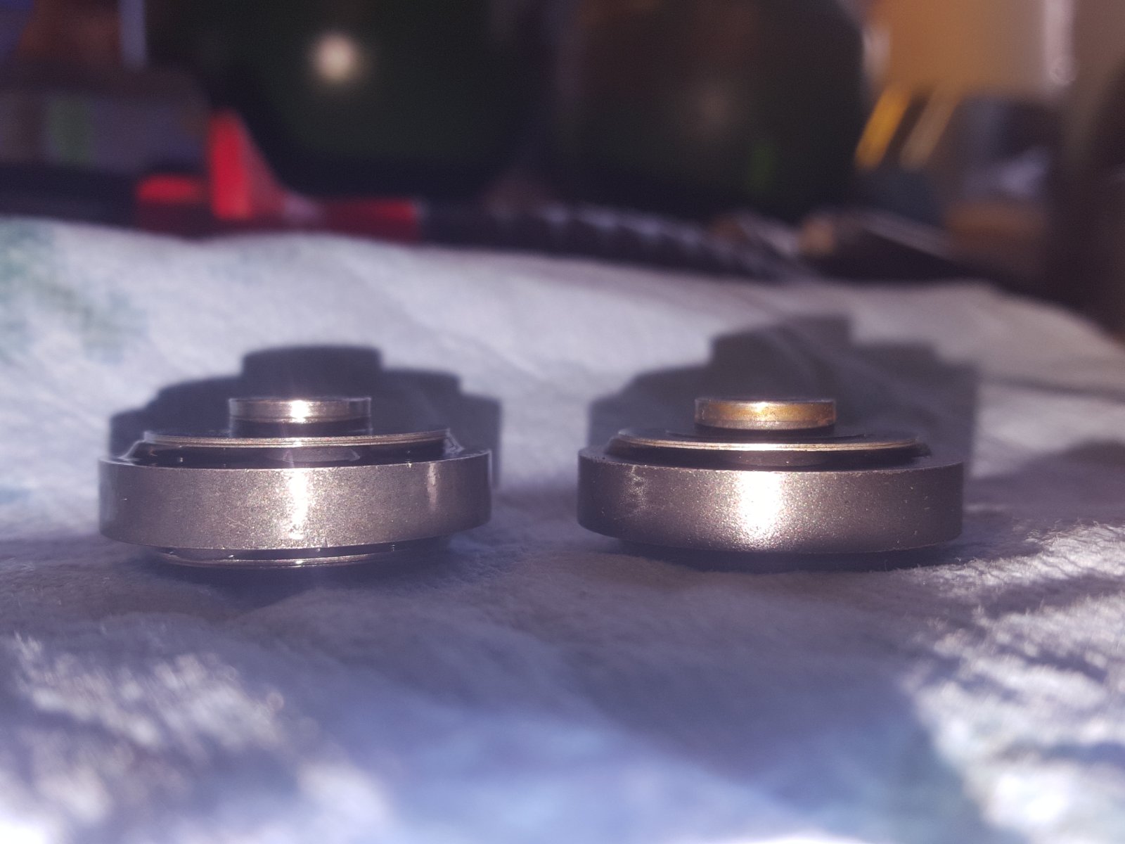

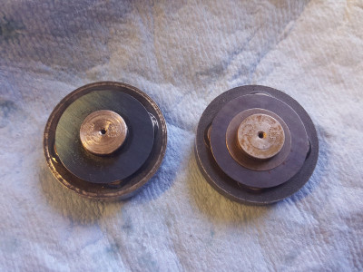

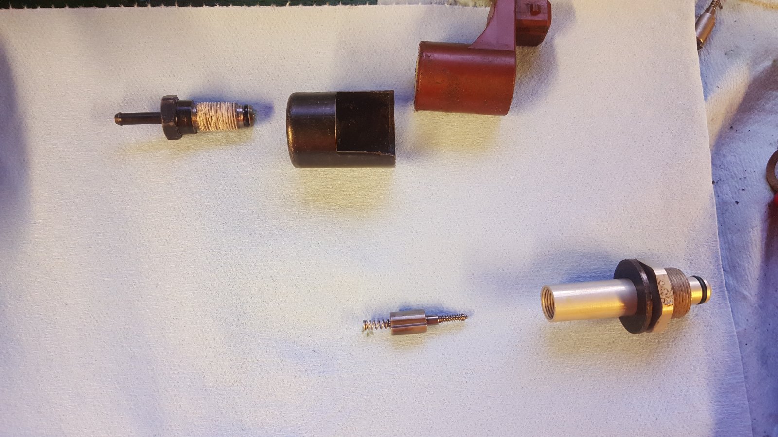

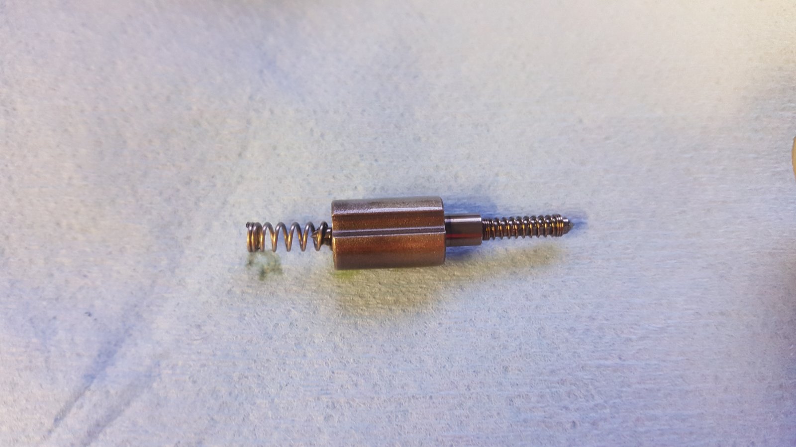

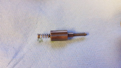

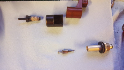

The EV from chevronics has separated lovely and the small spring measures a tad over 9mm.
Soon to refit- I hope that 'plugged' one comes out ok....

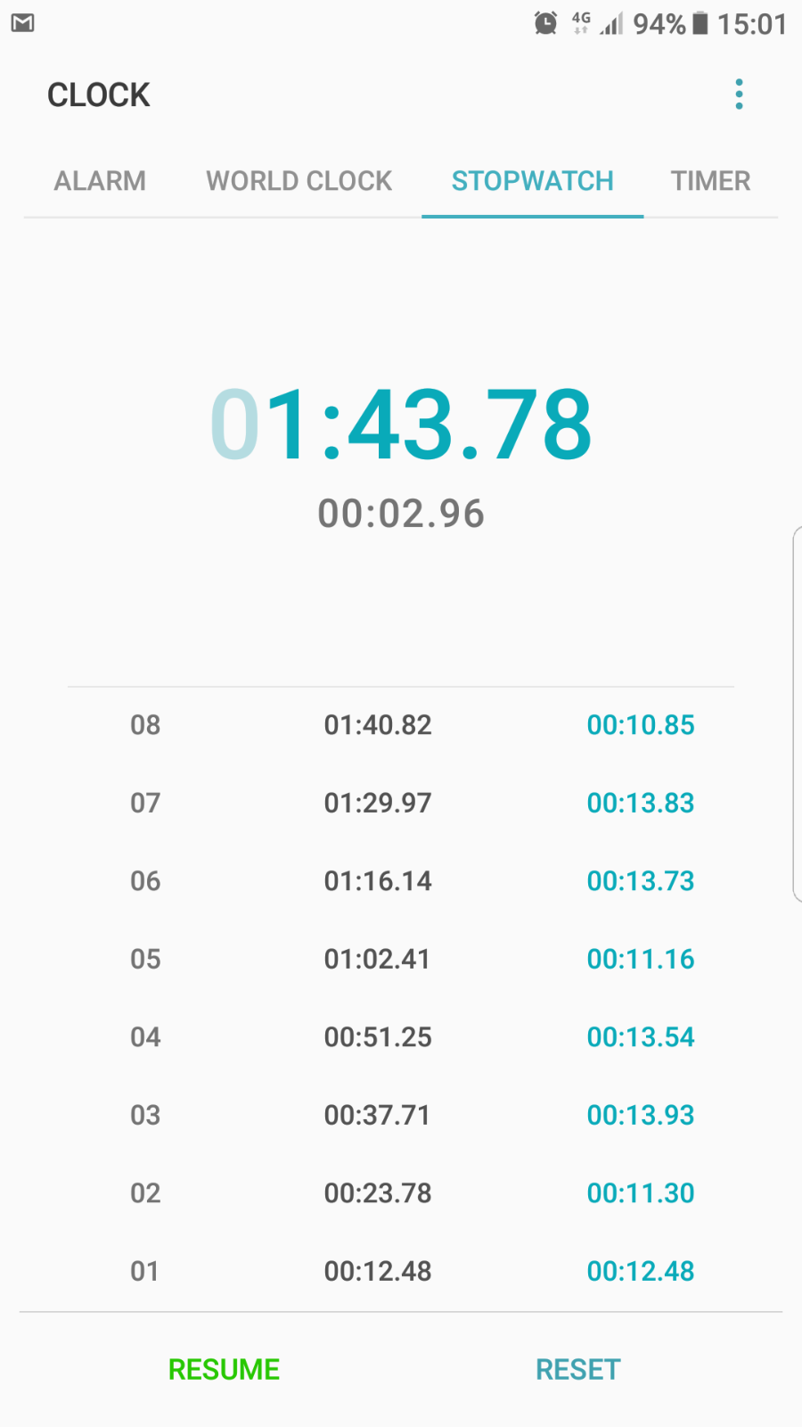

Drove the 20 miles back to home on a variety of roads and it was working well. Nicely smooth and good switching.
Regulator cycle time up to a nominal 24 sec which is ok.

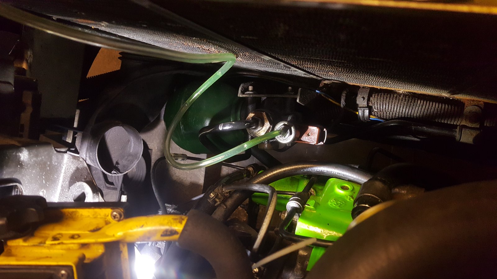

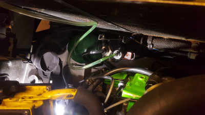

Yes it was Looking good when the clear tube on the front EV was showing no leakage.

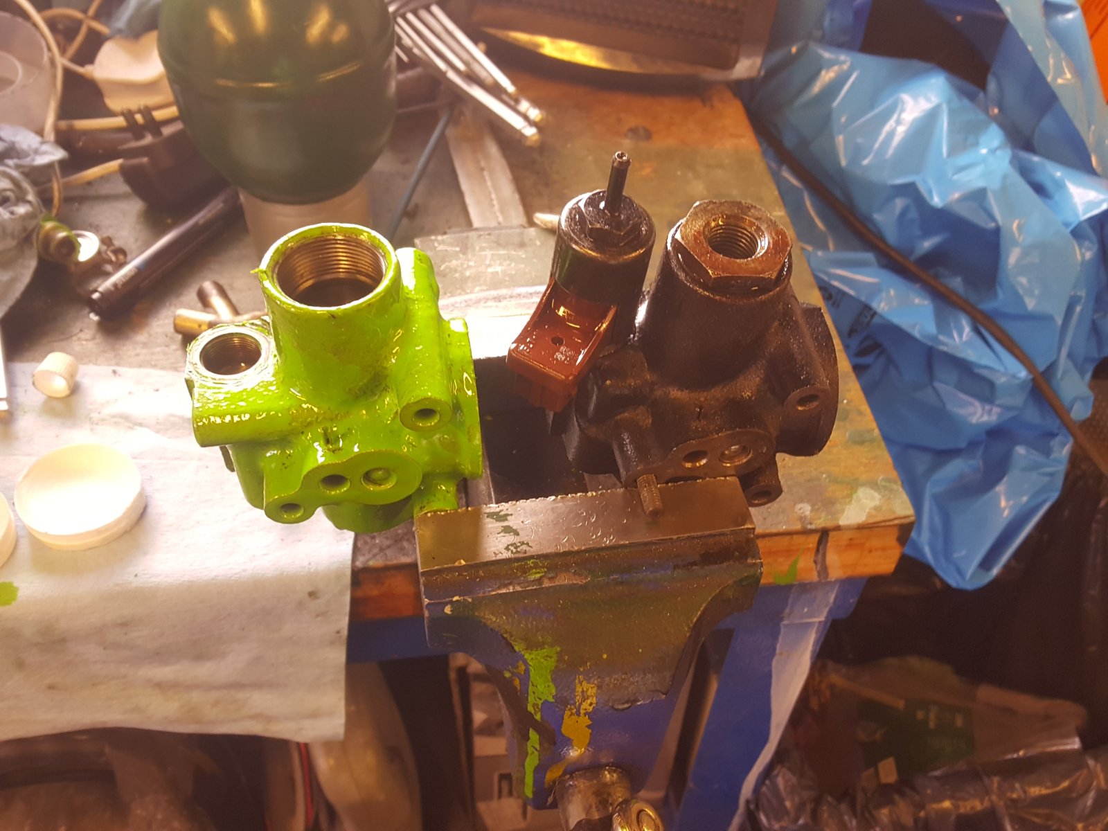

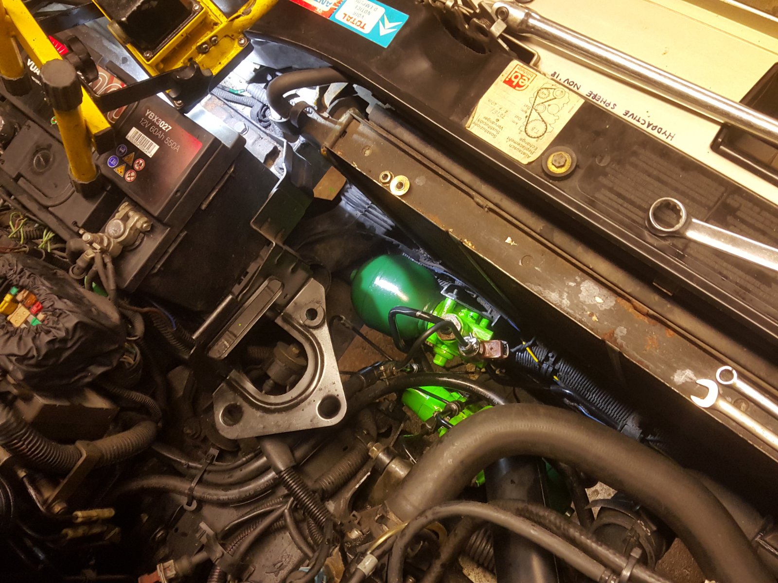

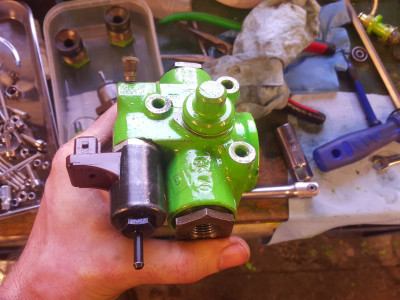

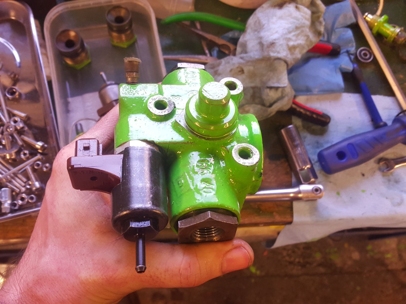

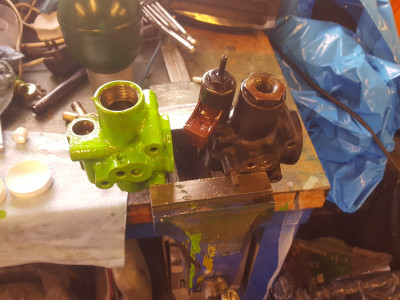

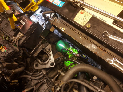

Update on the Hydractive investigations.
After some investigation I decided to keep the ebay firmness regulator and fit it to the front of the car using the new electro valve. It has been thoroughly cleaned of any sand with several shots on an ultrasonic cleaner and compressed air.
It has been covered elsewhere, but the revised version of the firmness regulator has one hydraulic pipe fewer. The challenge was to trace the routing of the pipe and find the port to plug with a bleed nipple. It turns out the pipe follows the same route as the thick 10mm suspension pipe and also the pipe from the height corrector. They all route together around the LH side of the engine bay. The spare pipe and the height corrector pipe route underneath the LHM tank where they both connect to 2 different pipe unions that were right next to each other making it easy to work on them (after first moving the LHM tank). So, removed the pipe end and plugged with a spare brake caliper bleed. I've left the spare pipe in place for now in case I have to reverse it all at some stage.
So, old regulator out All the bits swapped And fitted As you can see I've got a theme of painting the hydraulic parts that have been overhauled - bright green brake caliper paint..
It is happily working and the bleed nipple that the modified regulators have, showed its worth because the amount of air that bled from it was surprising.

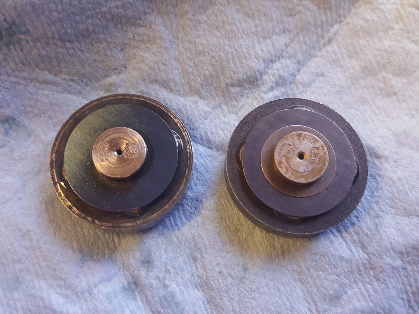

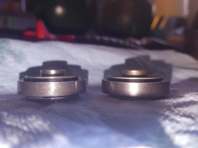

Observation!
the regulator from ebay was a Xantia one for sure because the dampers (removeable) have the same center hole size and the same etch marking '2.6'. But! I noticed that the disks of the dampers are different. The dampers from the late type modified regulator have fewer disks as seen. They have a smaller diameter top disk on both inside and outside ends of the damper.. I wonder why? Here's the difference between the two damper variations - you can actually see the thicker stack of damper disks from the original damper (left) and the thinner stack of the late type (right). All other aspects of the damper are identical. I decided to fit the later type of dampers to the regulator to fit to the car.
So all in, after a fait bit of citaerobics and a play, the front suspension -seemed- softer and a bit more satisfying but that is stationary. Out on the journey home the ride is easily better! The harshness has all but gone. It's decidedly floatier and the sport mode is as taught as before.
Being the modified type of firmness regulator, they suspension switches to soft mode when the door is opened even when the system pressure is at nil as tested by releasing the main accumulator pressure and then checking the soft mode still engages - it does! The back suspension of course, didn't follow suit because it still has the original type regulator at the back.

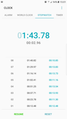

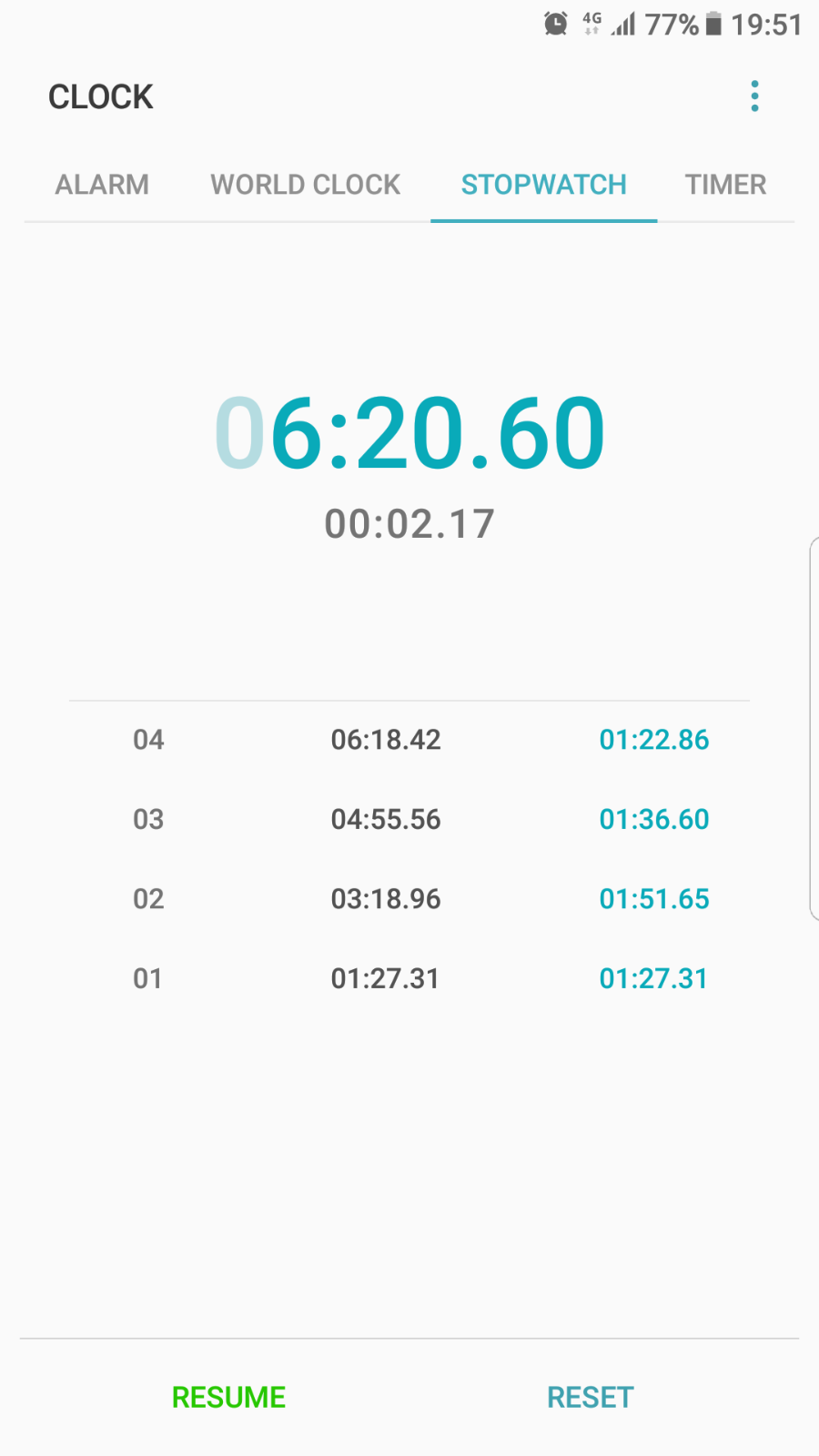

Pressure regulator cycle time!
So the PRV cycle time had been really bad - 13 seconds and the front suspension sinks really quick after parking.
I timed the PRV cycles before swapping the unit. After the new front firmness regulator was changed it was hugely improved: Massive! well over a minute and a half! so much so that I only recorded 4 regulator cut-in/out in over 5 minutes!
Back home this evening and I note that after 20 miles of the improved ride the cycle time has once more returned to faster cycles.... Still not as bad as before but strange that it has crept back to fast tick times.
Anyway, glad it is done and will keep a watch on the performance of the system with this new part fitted.
Observation!
