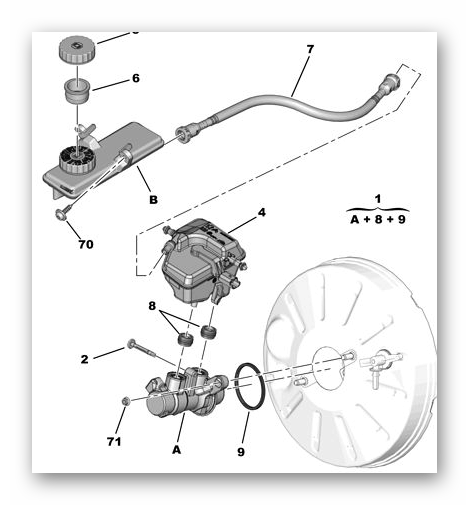

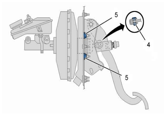

Here's what your servo should look like and the master cylinder:
- x 6945
Re: Why are my brakes so sh**e ?

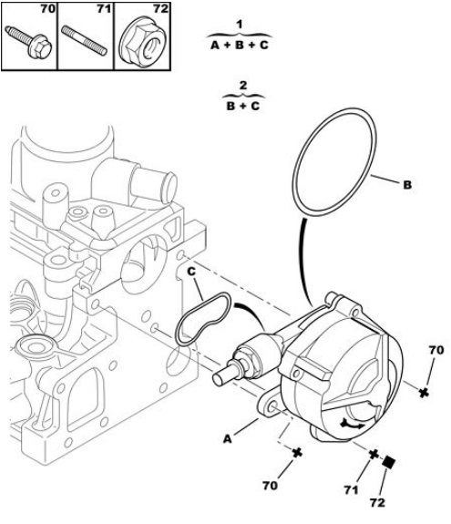

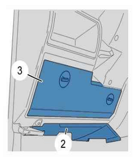

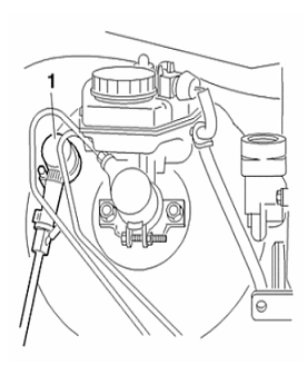

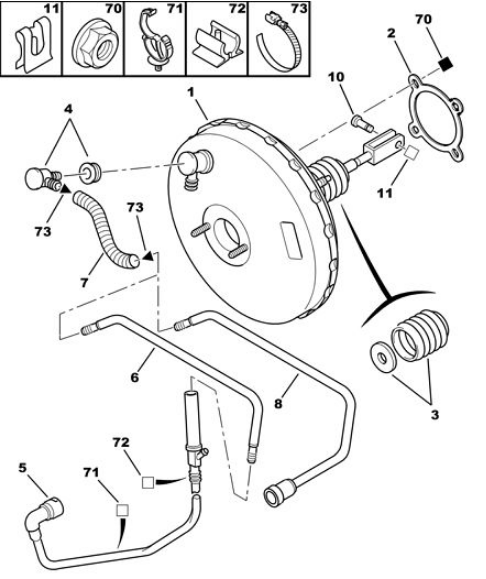

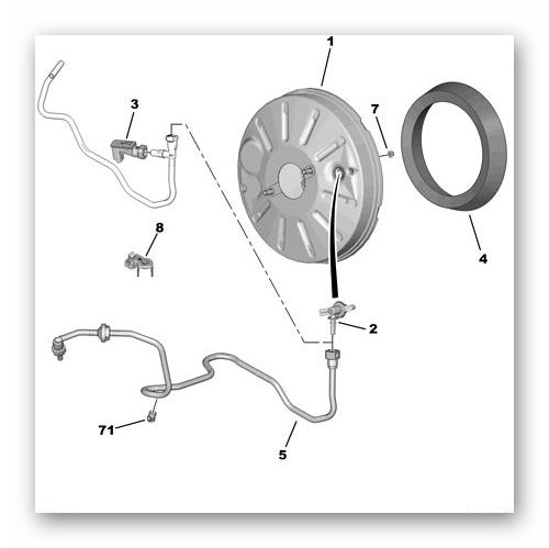

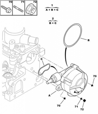

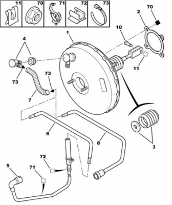

I'm not sure exactly what you are asking for... but here are the brake related components for the servo: (These are for your specific Berlingo).
Removing / Refitting the Brake Servo
Removing
Remove:
Refitting
Proceed in the reverse order to removal.
N.B.: Use a new spring clip .
Tighten the nuts (5) to 2,3 dan.m.
| Brake Servo Unions | Brake Vacuum Pump |
Removing
Remove:
- The battery
- The battery tray
- The ECU
| Disconnect the vacuum pipe (1) from the servo. Remove the master cylinder. | Remove:
Remove :
