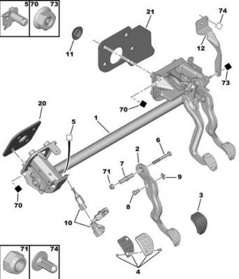

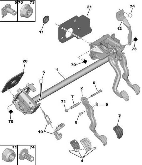

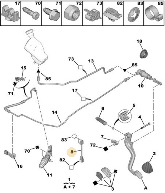

Re: A quick cruise stalk question.
Ok, so bear in mind the Left hand to right hand conversion - so the toe bracket assembly is carried over into the passenger side - behind the trim at the back of the footwell. This is where the brake switch assembly should be.
The clutch switch is item (8) on the first diagram - but is not shown on the second diagram which is the Toe Board assembly.
