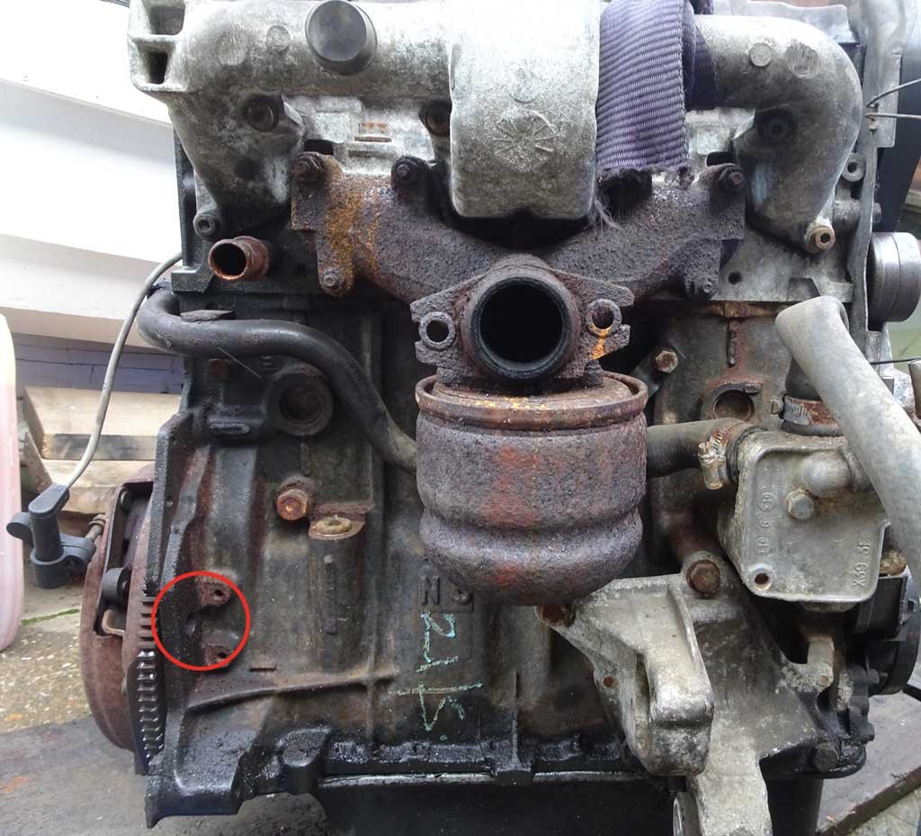

Is this the right hole? It looks about right for where it's dangling in this early photo of the engine as found.

I think that isn't the right hole; the fixings look wrong.
The Haynes photo looks more like the position circled green...
You should be able to find/see the steel peg (or bracket) down the hole that the sensor tip should come close to, just once per engine revolution. Take car with positioning it: you don't want it beheaded!

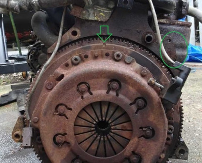

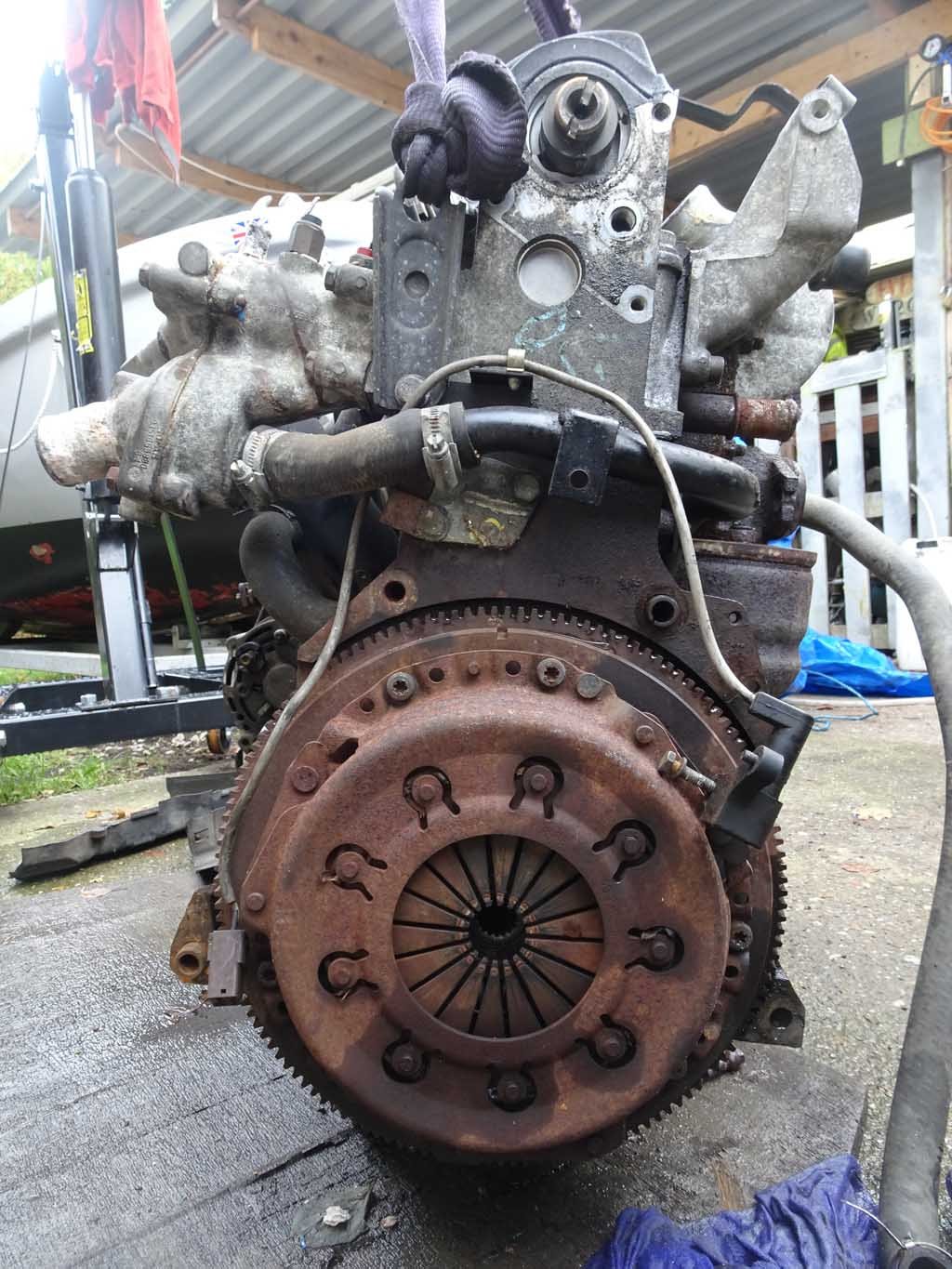

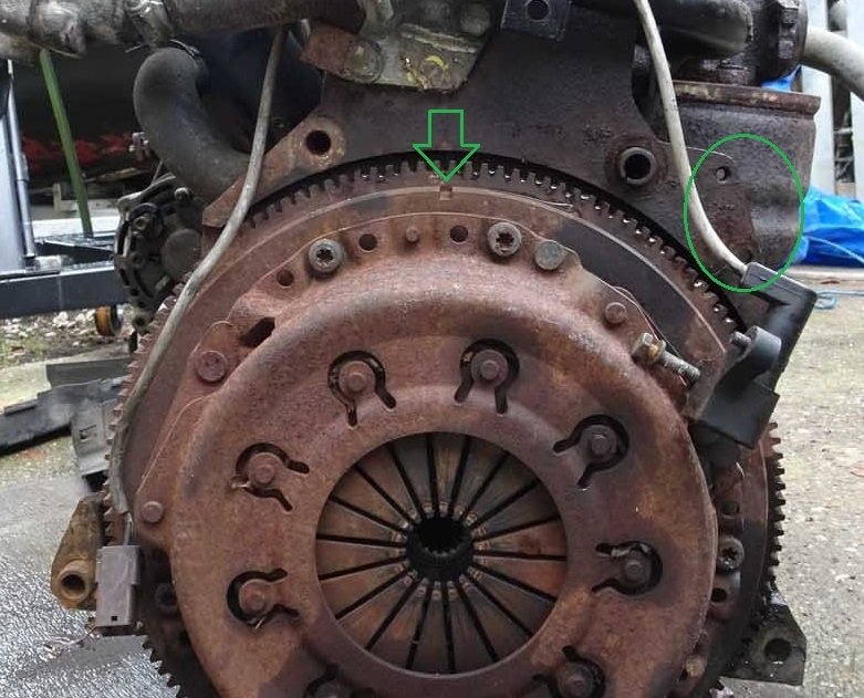

What does that look like, is it on the flywheel or drive plate?
I don't recall seeing anyting like that. All I see on the flywheel is a notch on the edge (at the very top of the wheel in the photo) and I think thre is another the same opposite it.
Note that drive plate is no more, it was replaced with one to fit my gearbox. So if it is on the drive plate, it's gone.

That was the perfect photo to post!
The notch(es) are on/in the flywheel, not the drive plate/clutch cover.
Mounting holes are circled; triggering has to be by the notch (arrowed) - could be two of them, as you say.
The connector on the end of the grey sensor lead is also used as a simple diagnostic socket (simply to measure engine revs).
If the marine gearbox is in the way, I'd forget about the sensor at this stage. You can easily improvise something using the camshaft end (easily accessible and done) later on.
