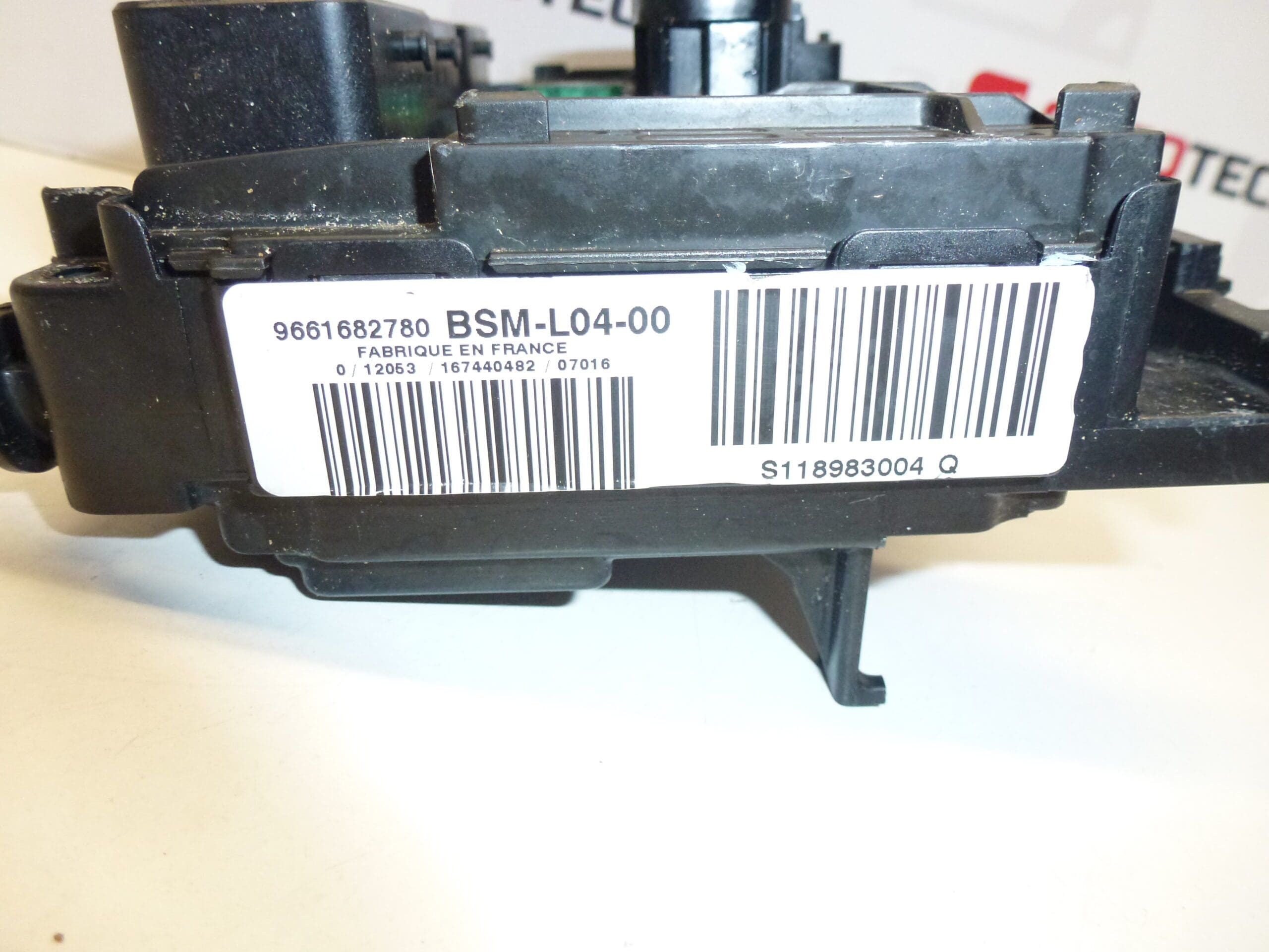

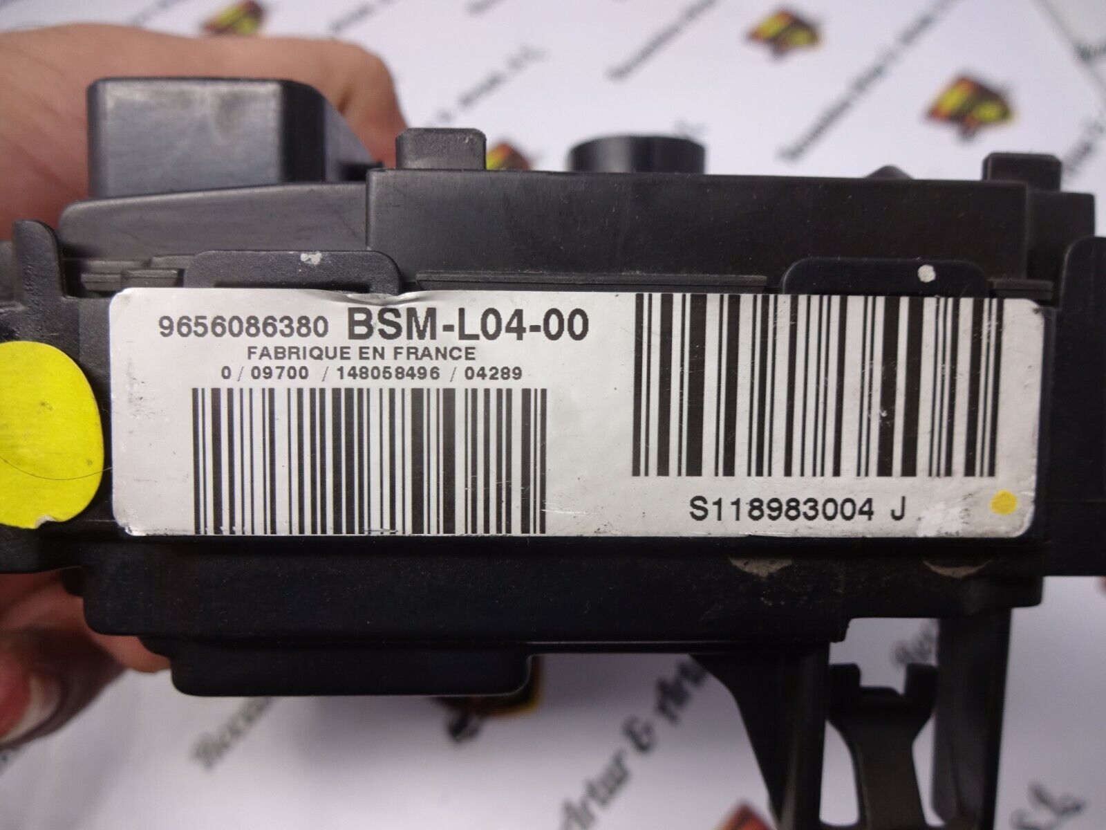

I have Citroen c4 2007 1.6 HDI and my heat blower doesn't work due to BSM failure.
The one that's now inside is BSM L04-04 with SN: S118983004 Q and I've bought one used with SN: s118983004 J
What does letters Q and J stand for? Can I use the one that I just bought?

currently inside (not working)
the one that I bought (second hand)
