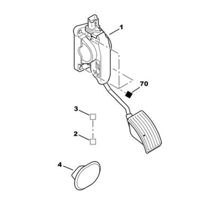

Yes you do have a turbo. All HDi engines have turbos. This engine DW10ATED that you have is quite solid and rarely has issues.
As for the accelerator, both types are shown for you vehicle. The reason being is that some of these were fitted with the mechanical cable, but there was a modification to replace these with the purely electronic ones.
So I suspect you have the cable based one. If there were issues, they would now replace it with he modified version.
Here are both types for you to see:
