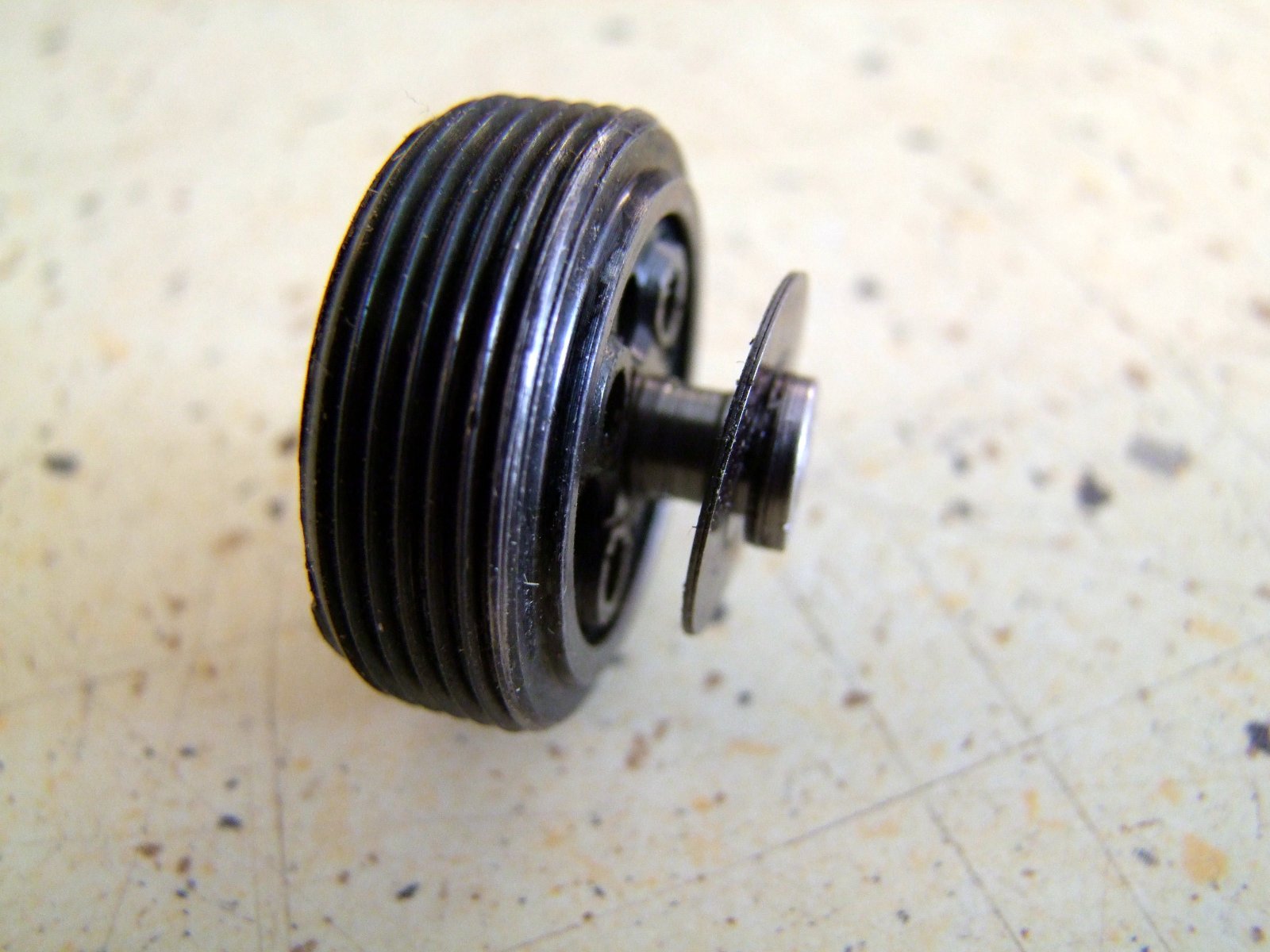

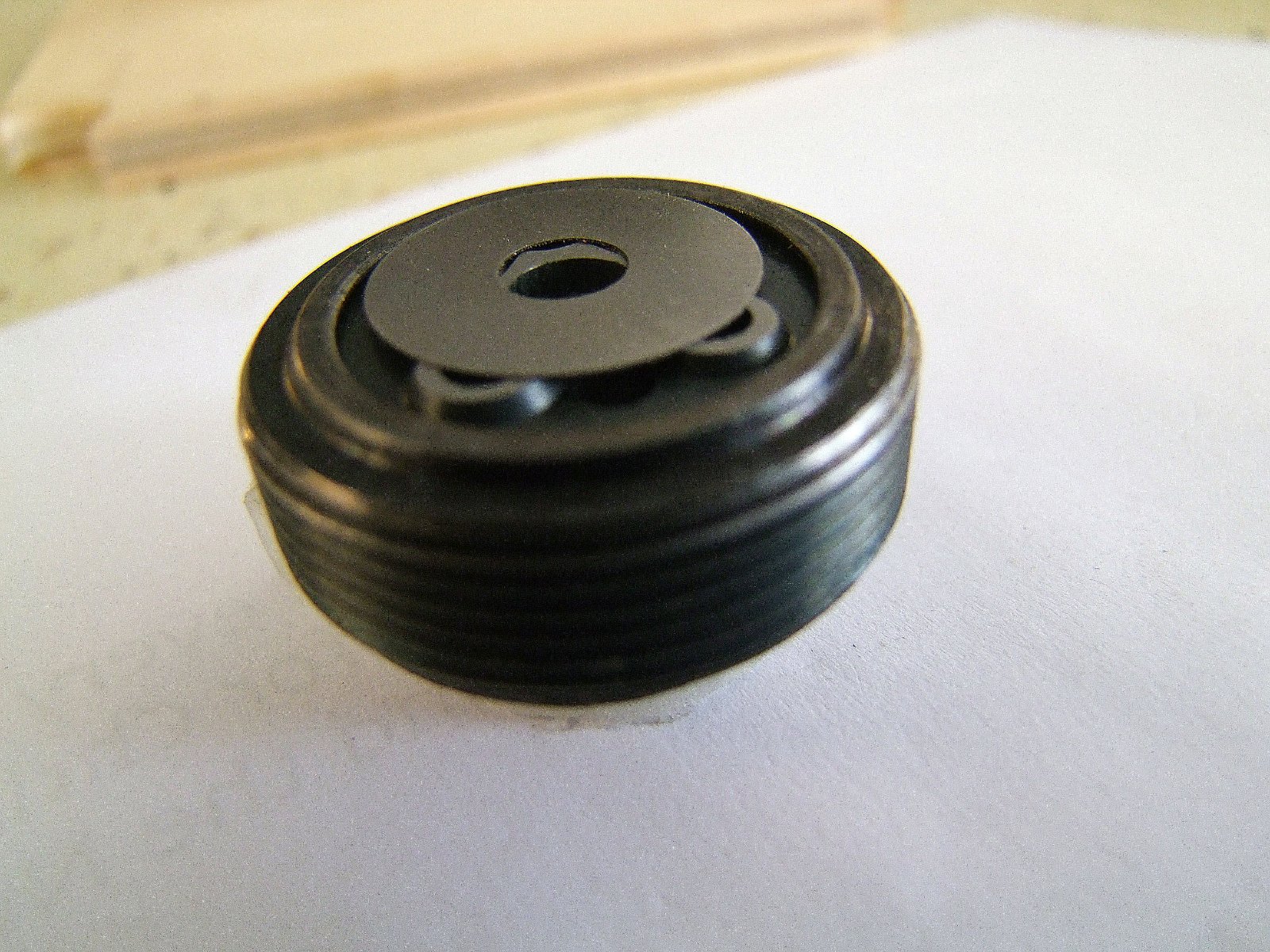

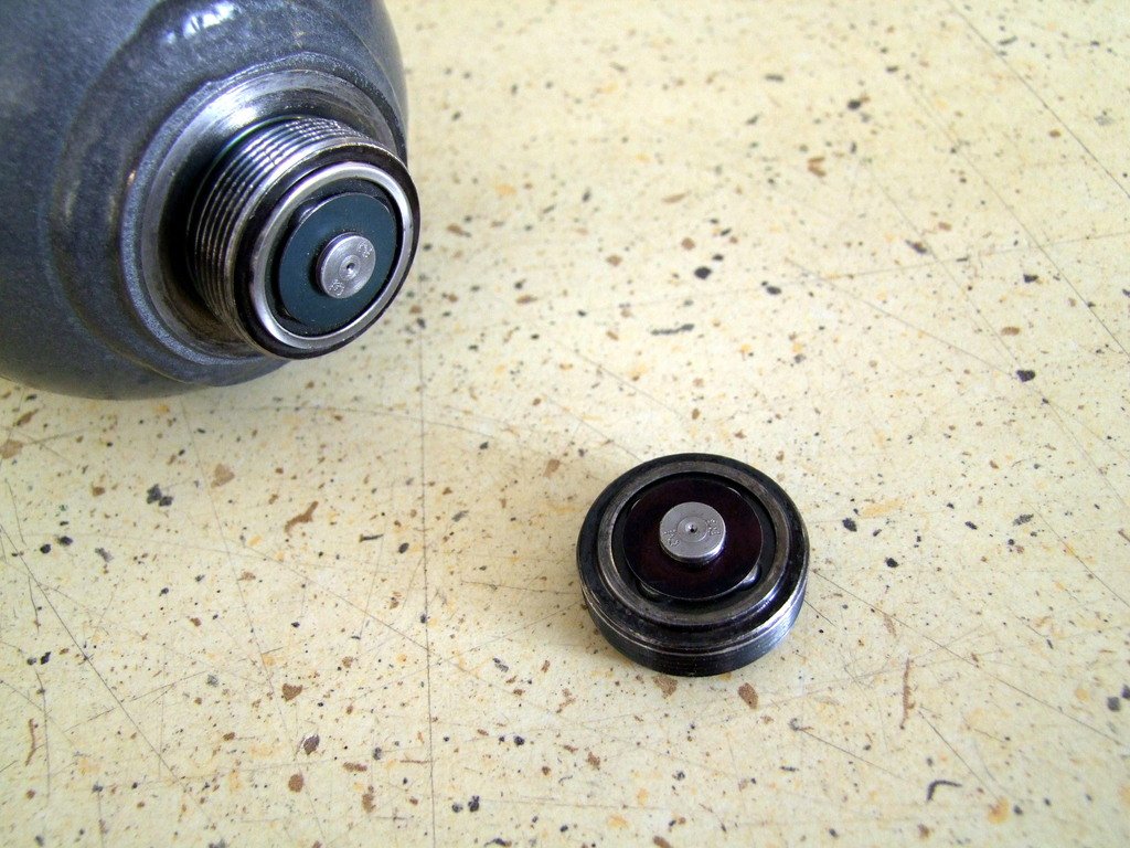

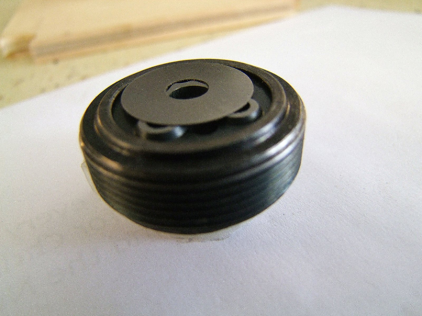

white exec wrote: 20 Aug 2019, 08:12
Mandrake wrote: 20 Aug 2019, 06:35 On the contrary, the washer valves would open on every large bump impact, as the large instantaneous flow rate would demand it . . . Any movement significantly more violent than that gentle rebound needs to flow through the washer valves.
Yes, the washer-valves will open, but never more than slightly. Examined up close, the valve multiple washer stack is in reality an extremely rigid affair, never designed to be fully opened...
...but to be "cracked open", and then to spring back.
As such, they never operate fully open, as that would involve permanent upward deformation.
This is fascinating!
How did you remove the damper? I saw some sphere round section O-rings for sale the other day and wondered where they went. There appears to be a round section O-ring between the damper and the sphere.
So technically are the dampers interchangeable?
