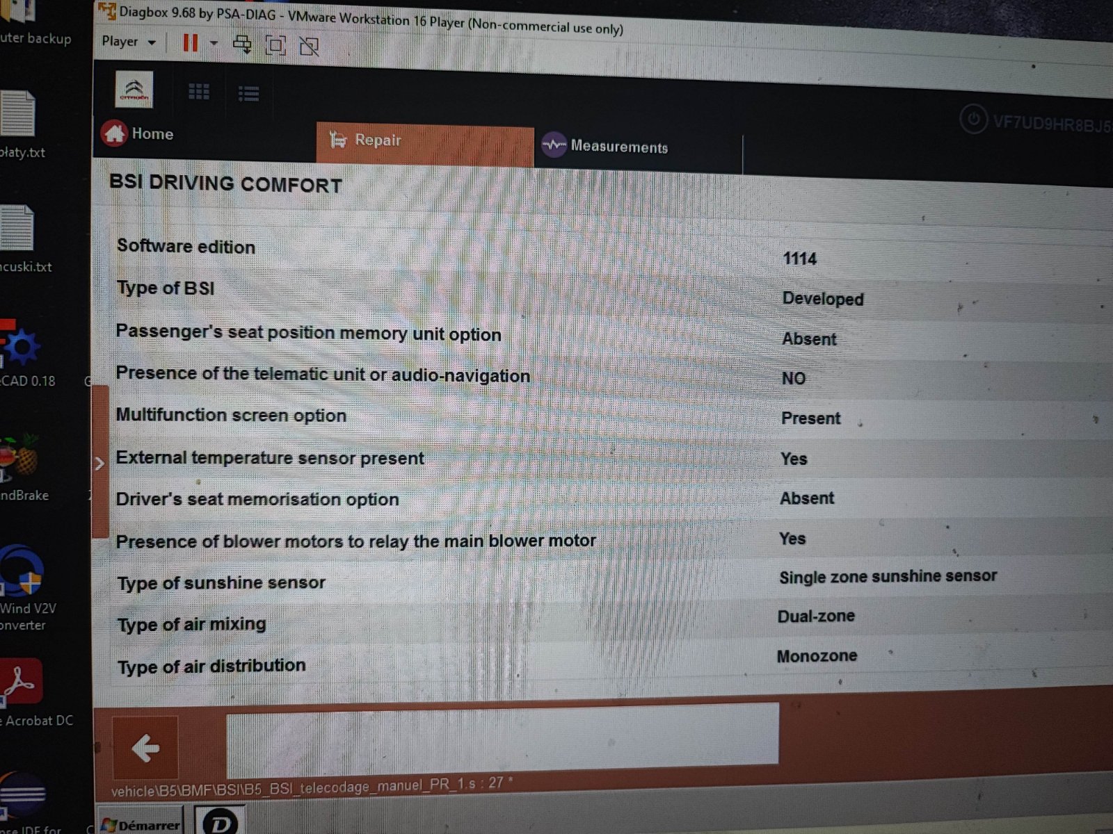

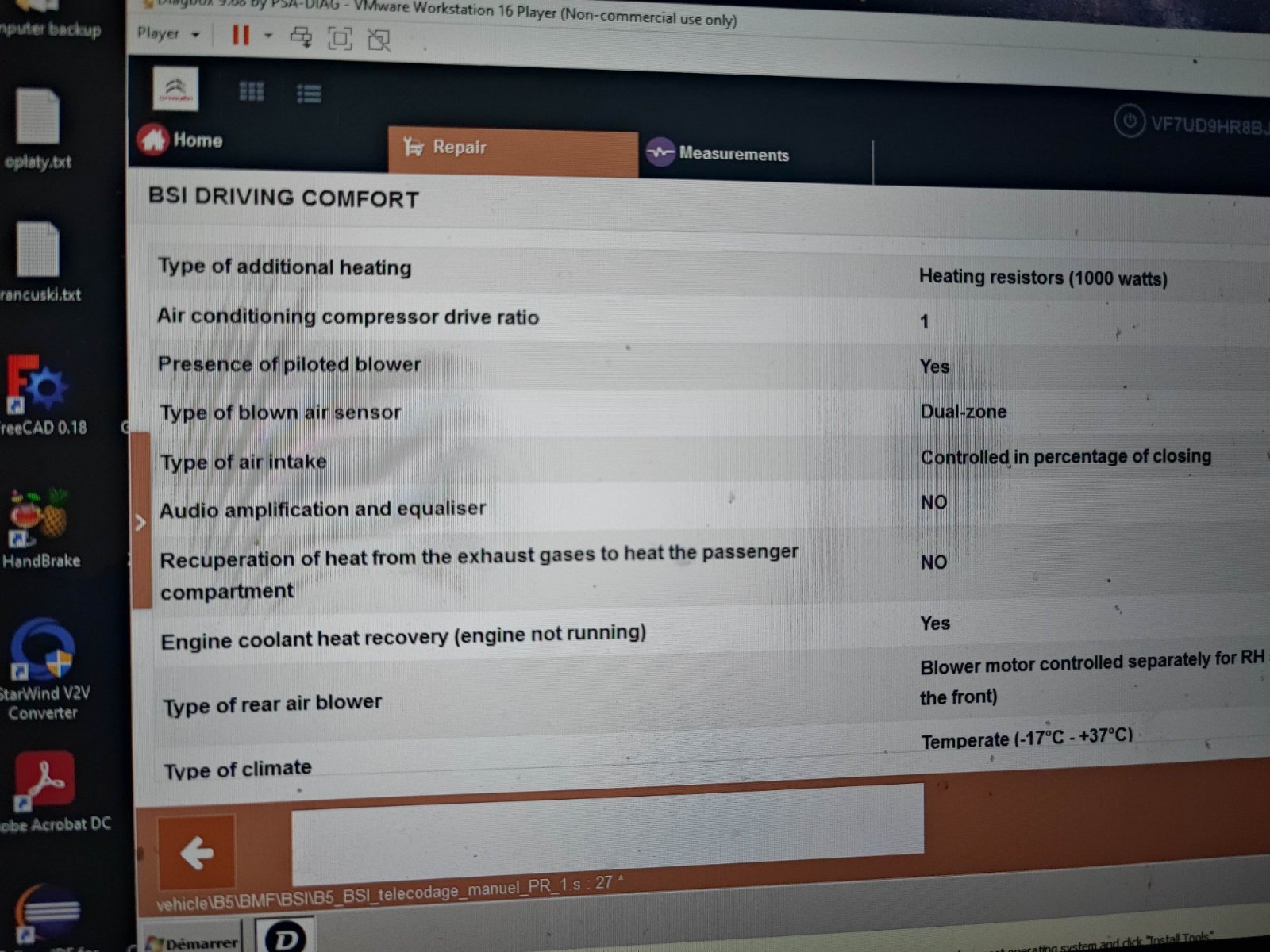

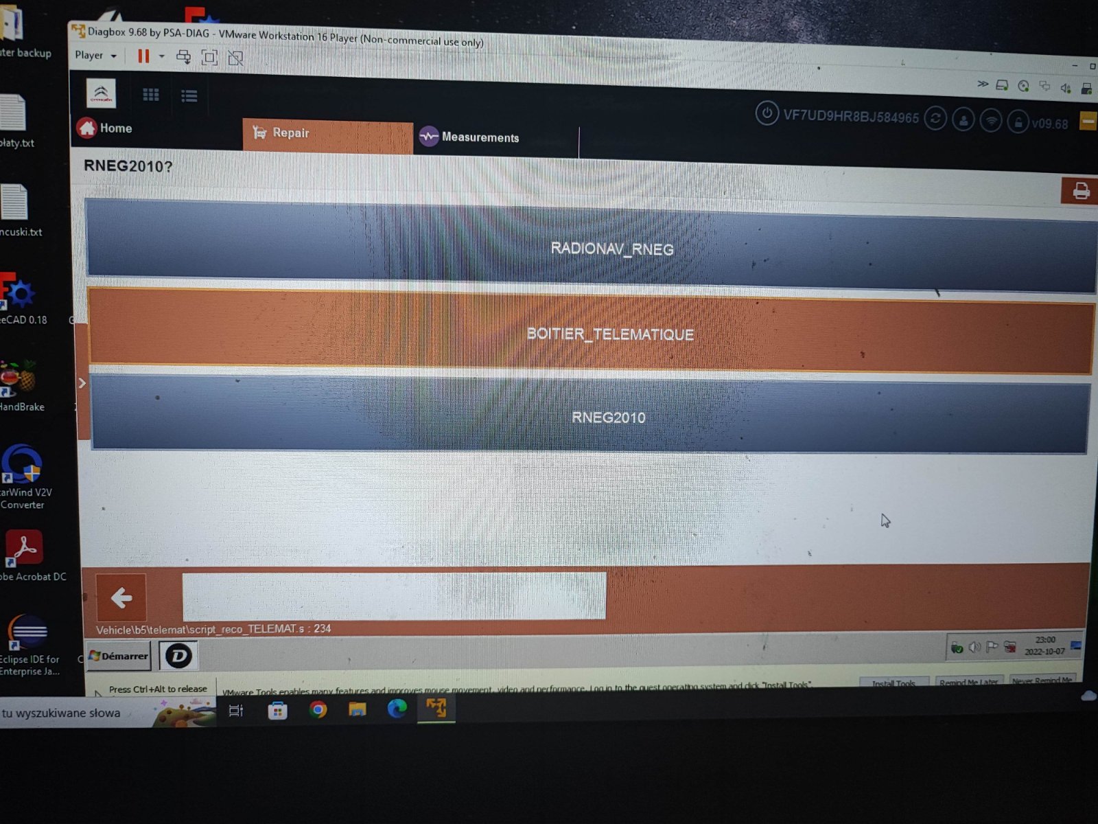

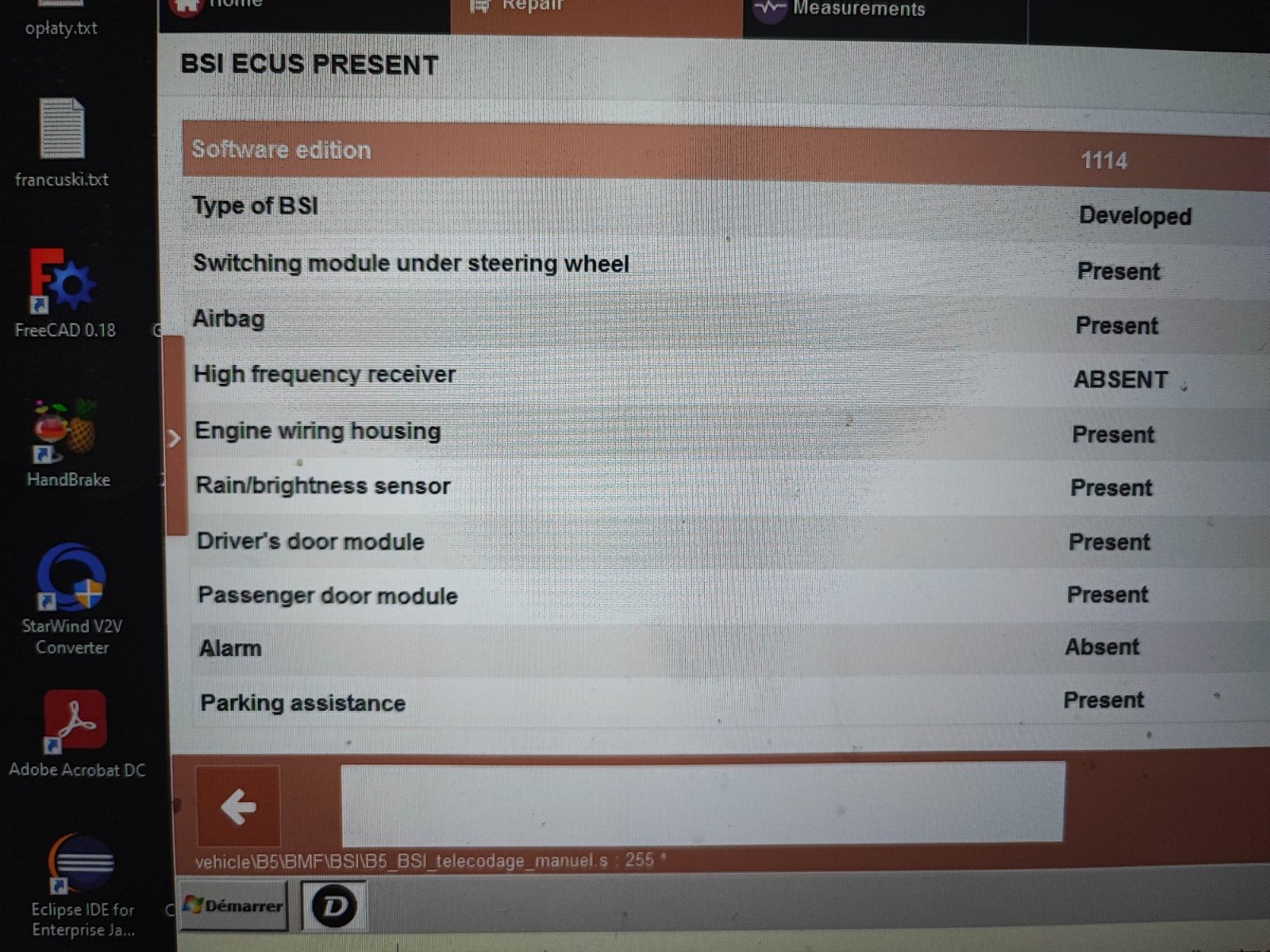

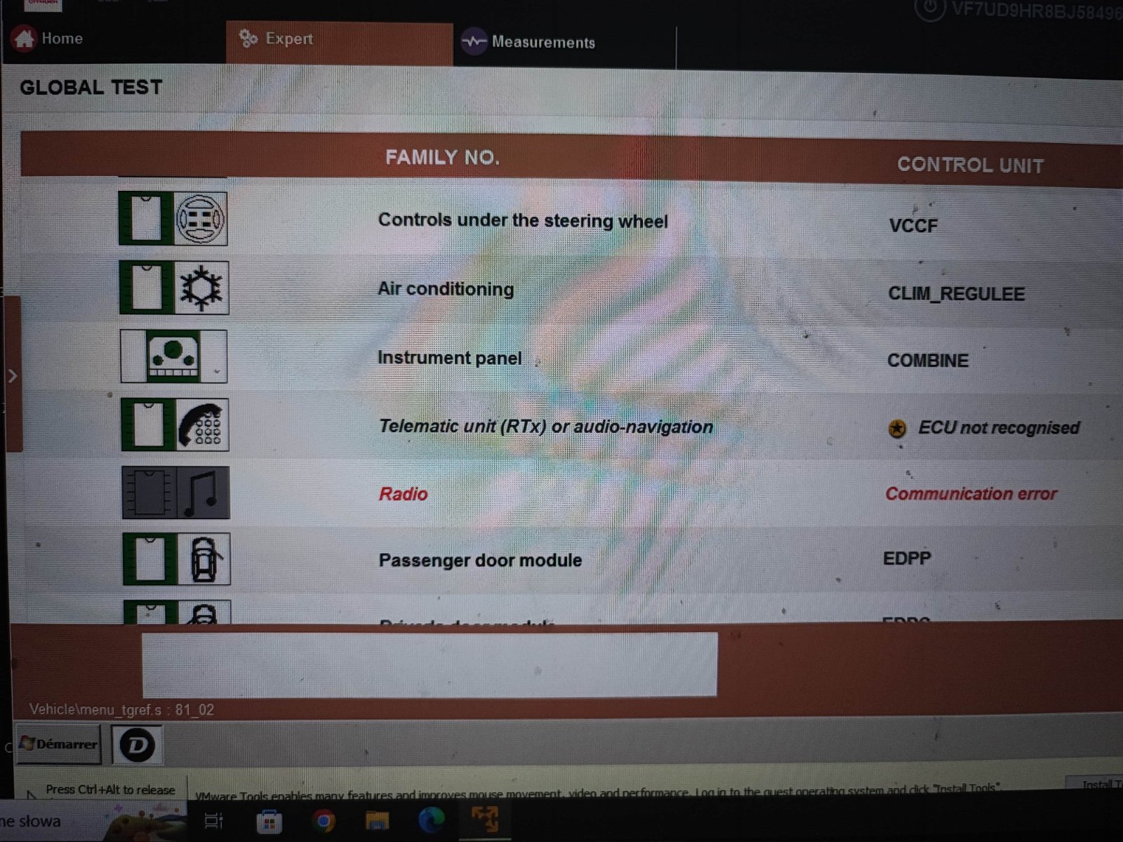

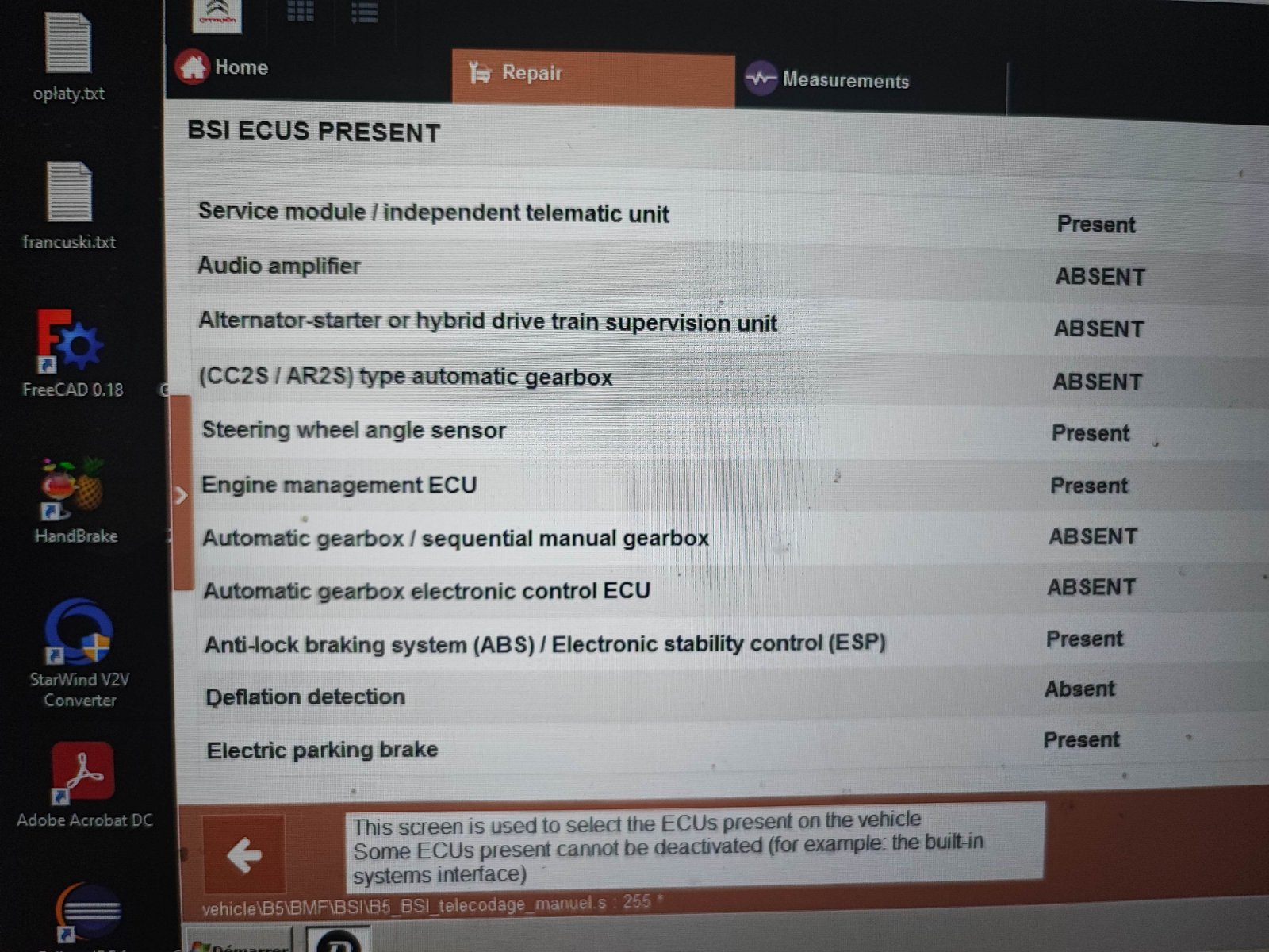

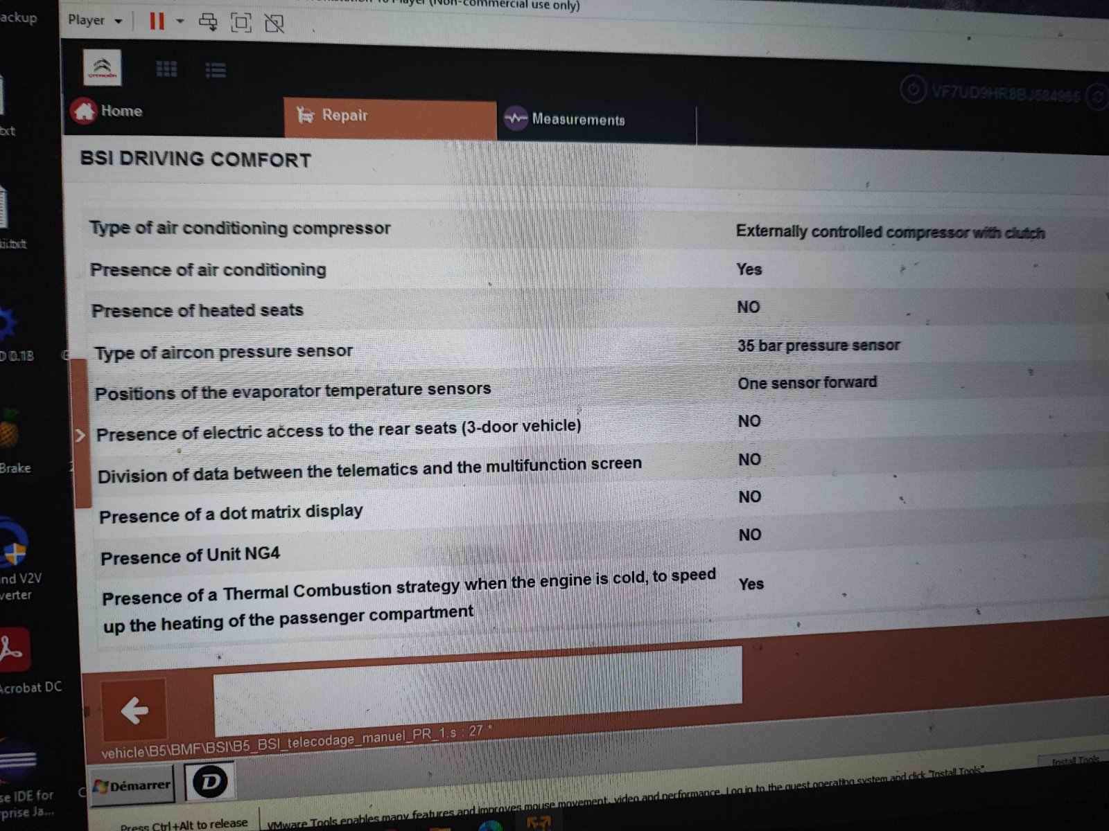

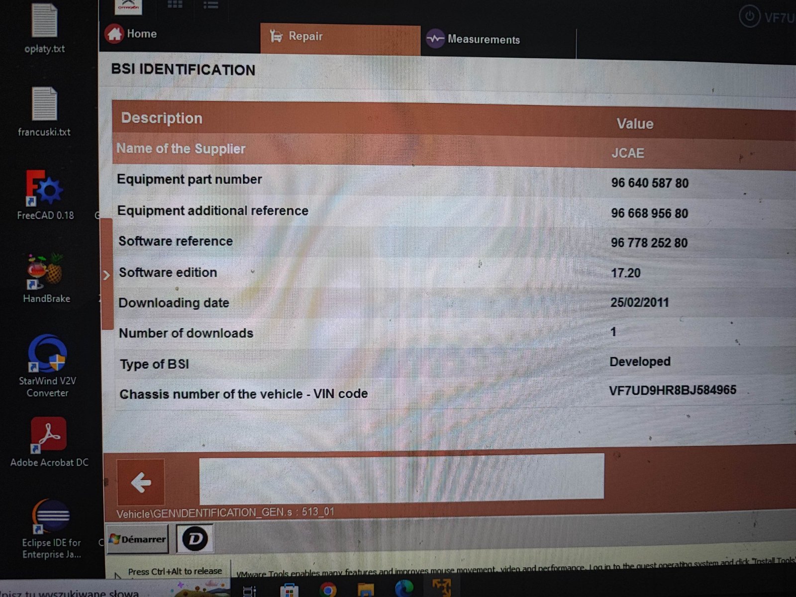

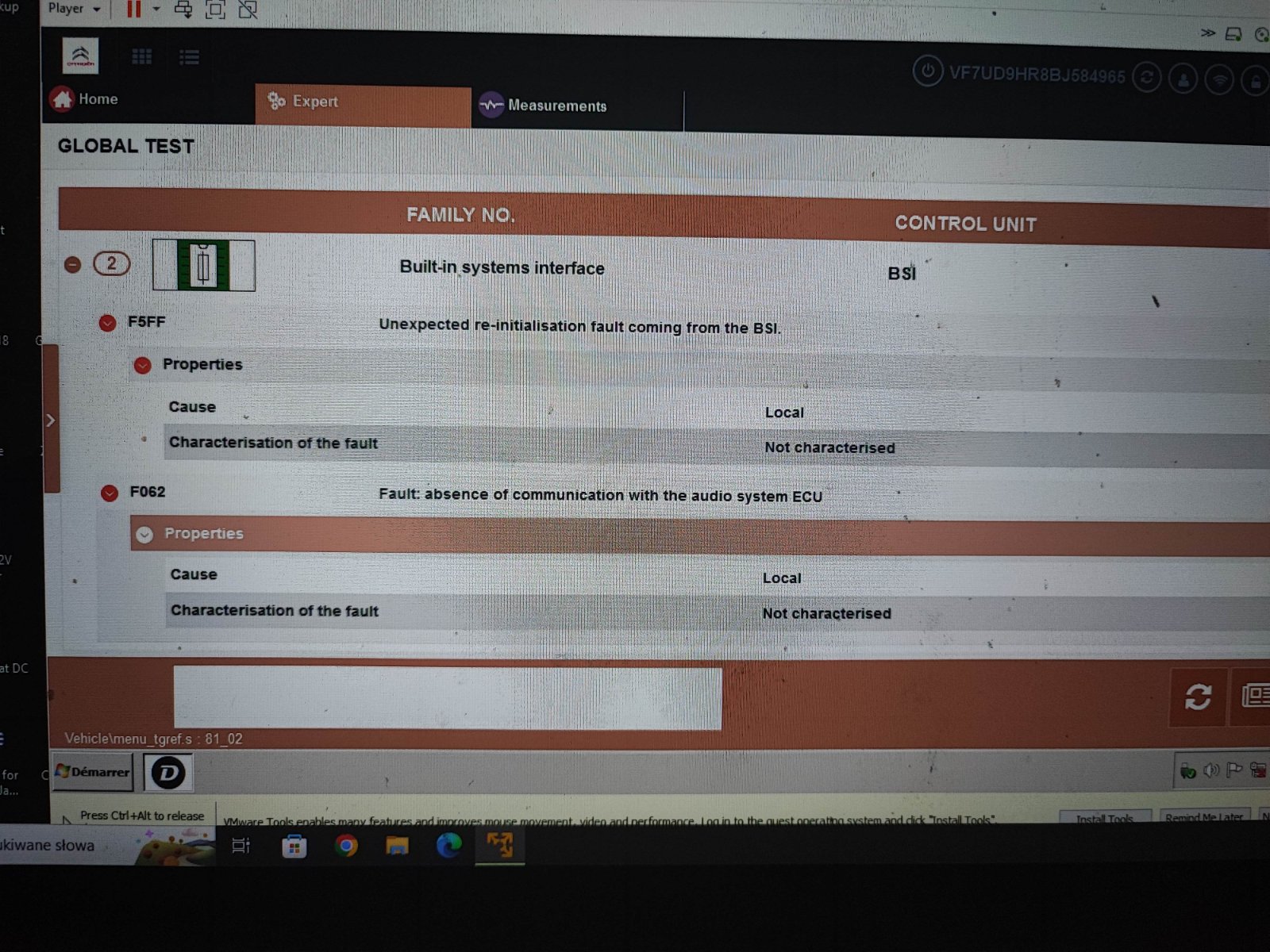

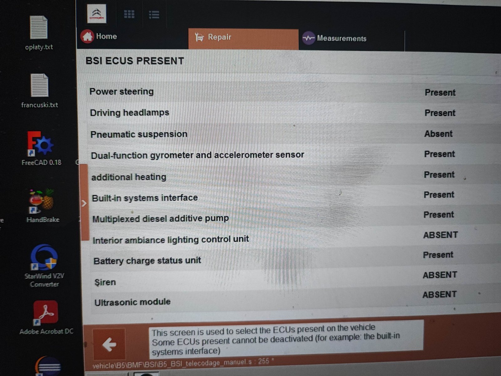

I've just taken some photos from Diagbox. Hopefully the right ones. First of all here are some things that may be important.
BSI identification: Some errors in BSI: Telematic unit not recognized and radio not present. This is strange: After entering telematic unit I see this. I did not try to go deeper at this time: BSI ECUS present: BSI driving comfort as it also seemed to be interesting: Once again thank you for help.

Re: RNEG - trip computer
First you need to change the Telematic unit to RADIONAV_RNEG.
Apply the changes, exit Diagbox turn off ignition and then see if this resolves the issue. If not please read the private message I am sending you concerning this.
You probably think about three options after entering "unrecognized" telematic unit? I am not sure but they did not look like something to set but I think that just all possible options were shown as telematic unit was not recognized. I probably can enter each of these submenus. However, yesterday I did not try as car went into eco mode already and as far as I remember there was notification that it cannot be in eco.

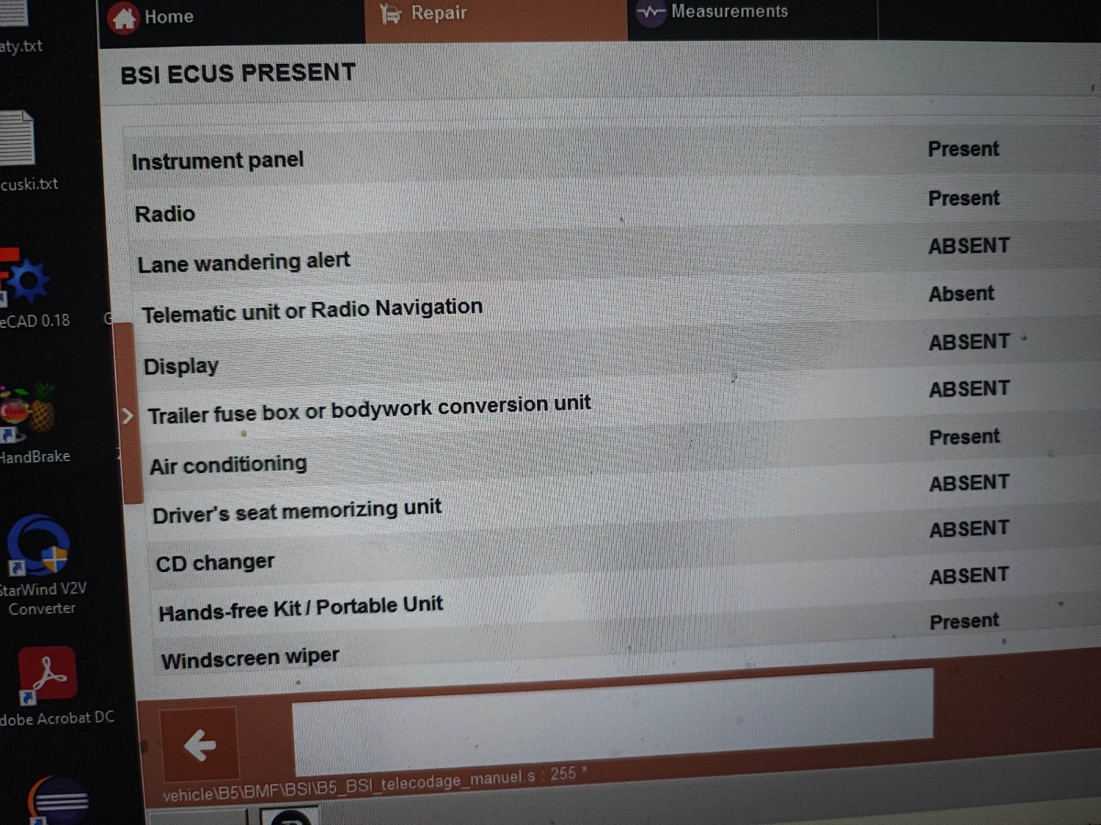

You MUST set the telematic unit to RADIONAV_RNEG. At present it thinks there is an RD4 radio that has been set (Radio). This must not be set to present if a telematics unit is present like the RADIONAV_RNEG.
There are a lot of configuration settings for the RNEG - I have these, but cannot tell you what other options are incorrectly set in the actual BSI at present for the reasons in my PM.

Ok, I will try to set RNEG. Maybe I will find this somewhere. At the moment in the driving comfort RD4 is set. Should I disable that option if it is even possible? It Is strange that there is no RNEG there to set while RD4 is there.
P.S. Now I noticed that "telematic unit or radio navigation" option which is absent. I assume that it should be set to present.

- x 6945
It won't be until you have set RADIONAV_RNEG to be present as in screenshot number 4.

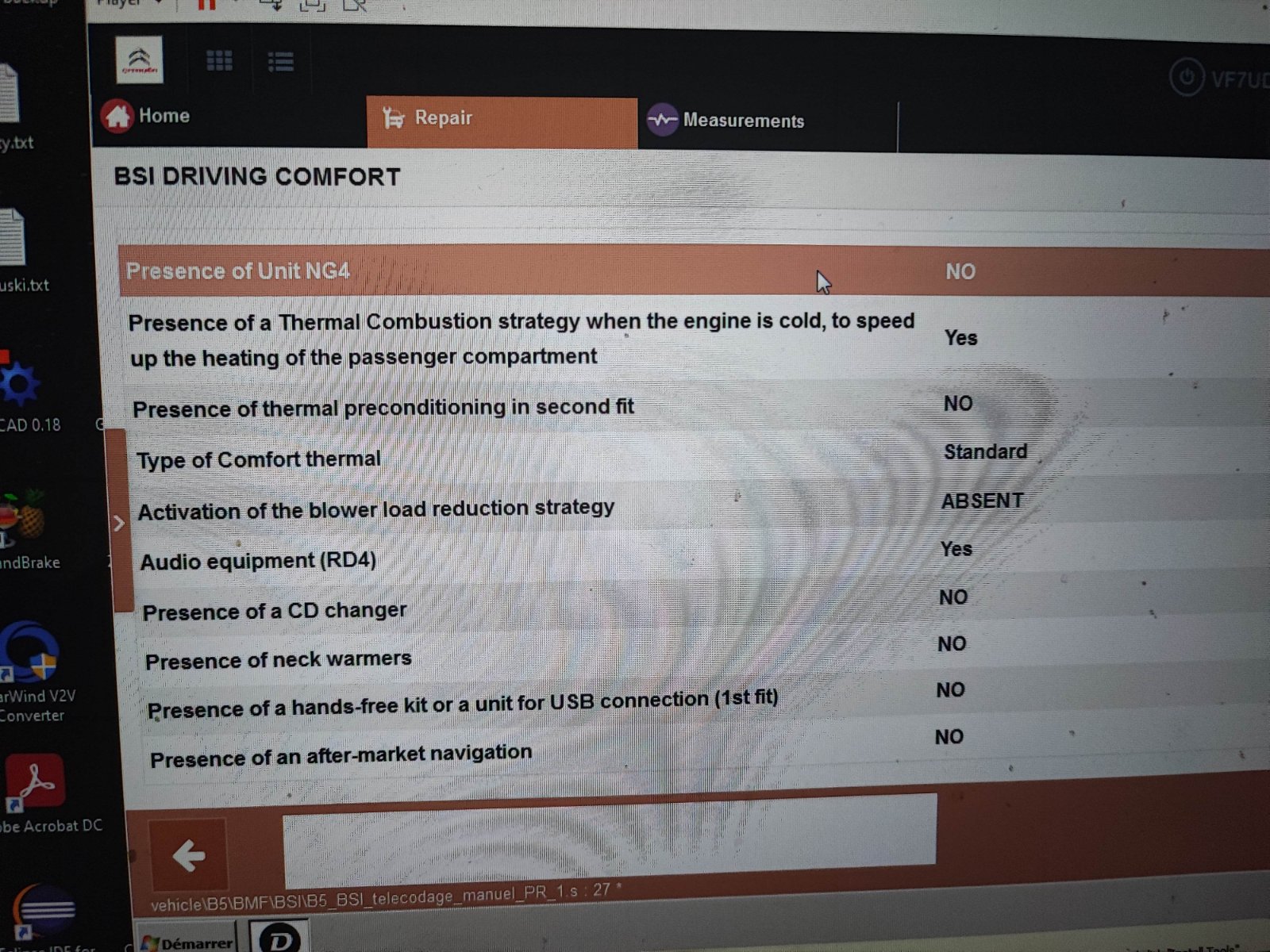

Today I tried to set "Radio" to absent and "Telematic unit or Radio navigation" to present in BSI ECUS (screenshot number 6). I also tried to switch to off RD4 on screenshot 12. These changes made no difference. Everything worked as earlier. That was strange because I assumed that I may loose some functions like radio but it was always ok. I also entered RADIONAV_RNEG (screenshot 4) but there was nothing interesting there.
What is strange to me is that I was always advised to switch on "trip computer" option in BSI but I have looked for it many times and there is no such option anywhere. I will expect it in ECUS present but it is not there.
You already had the section to change the system to the RADIONAV_RNEG in the screenshot. Make sure you choose this one and not RNEG2010 which is for RT6 units.
You will need to make sure you are in BSI manual configuration mode to do this - but I just noticed you are using Diagbox V9.**. As far as I'm aware you cannot telecode (make any configuration changes) with this version without paid tokens and a log in to PSA servers.
You are better off with Diagbox Version 7.62 (don't go higher) for the age of your car that supports vehicles at least to January 2015. Past this version manual configuration becomes restricted.
These three options are shown after I enter ECU not recognized option (screenshot 3). However, it is not something that I can set. For me it is like "I do not know your ECU so I will show all possible submenus". I can enter any of these and change some things but not change system itself.
