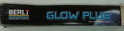

Re: Hard starting diesel
Be careful when buying Beru plugs on ebay. I thought I was buying some but when they arrived I realized I hadn't looked close enough.
