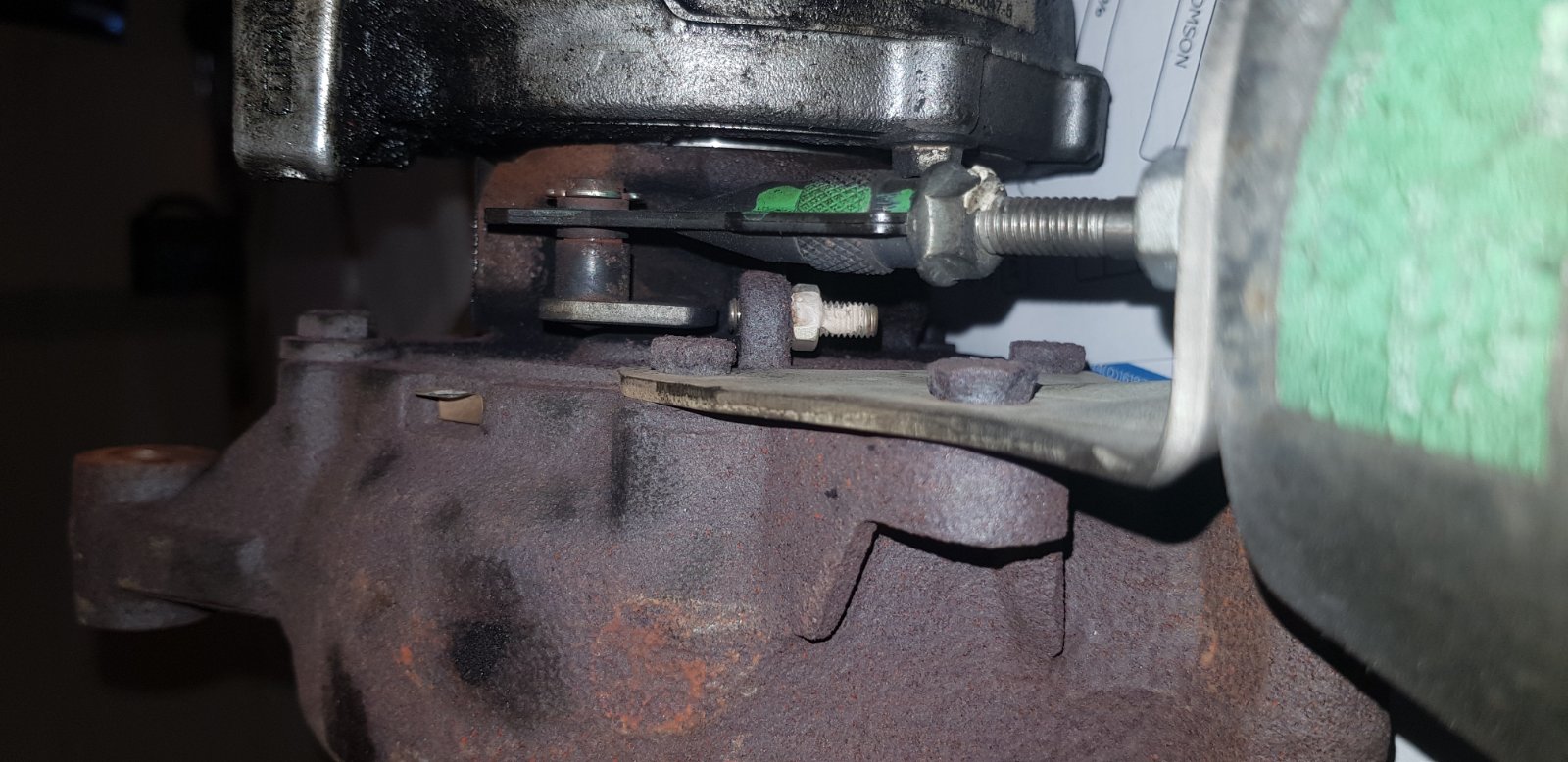

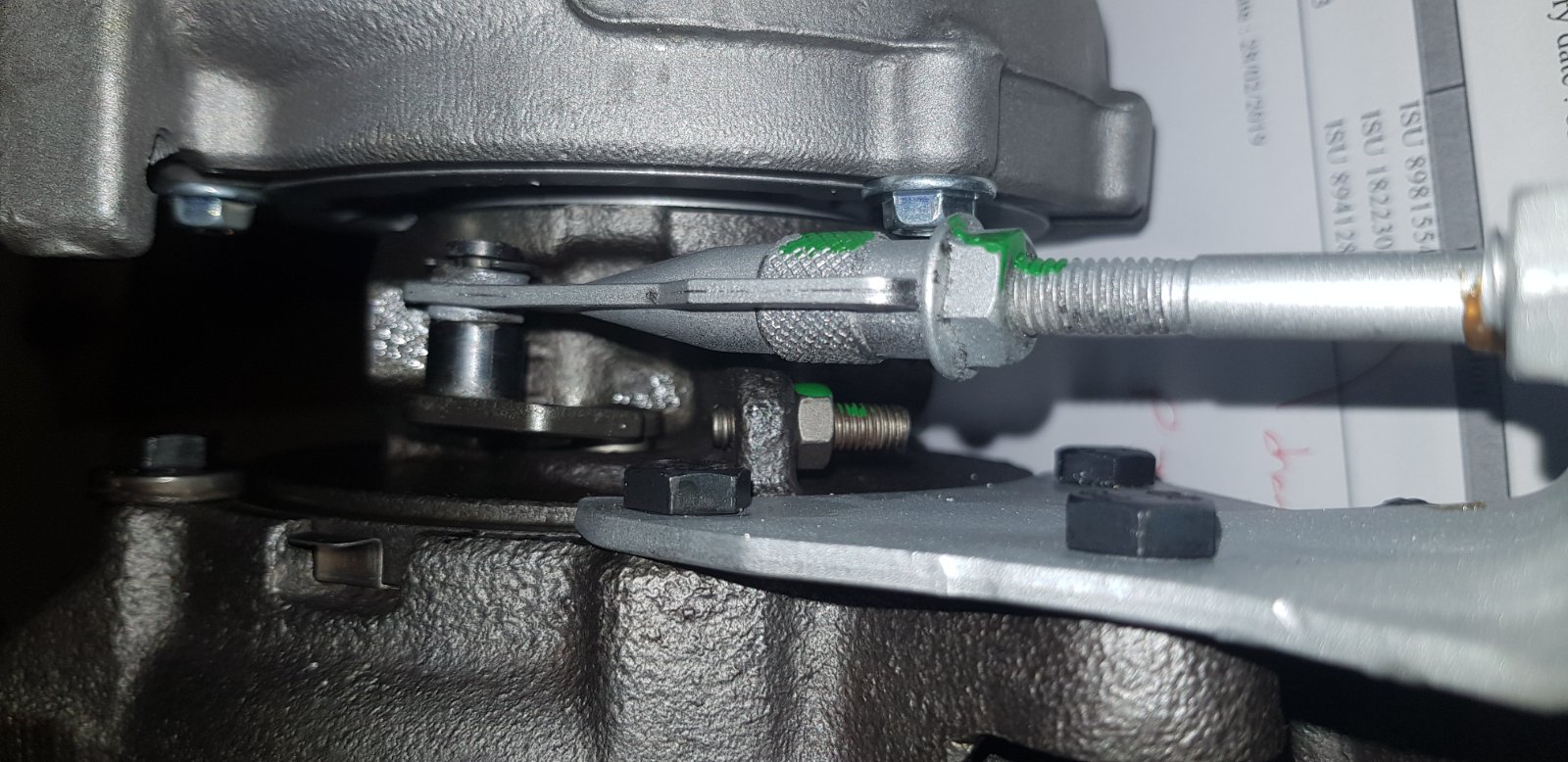

Just compared my old turbo to my possibly new warranty one the just turned up.
Old one - actuator starts to move at about 20kpa and hits the stop at about 50kpa. Total arm travel is around 5mm
New one - actuator starts to move at pretty much 5kpa and hits the stop at around 60kpa. Total arm travel is around 13mm
Attached a couple of pics, the arm on both naturally sit very different with 0 vac on them

Should be Marc, 16 years and I've never got a turbo for a vehicle wrong yet. Numbers all match. Unless you've spotted something I haven't mate
x 6955
Re: Turbo.... oh yey
It's just that they look a bit different in your pictures - maybe the angle.

That'll be my amazingly shocking photography skills :rofl2: :rofl2:
Not sure if it's relevant, but I did notice yesterday in a moment of trying to not so nicely force her to behave, there's very little boost at all in 1st.
Starting to think that actuator arm is set wrong
