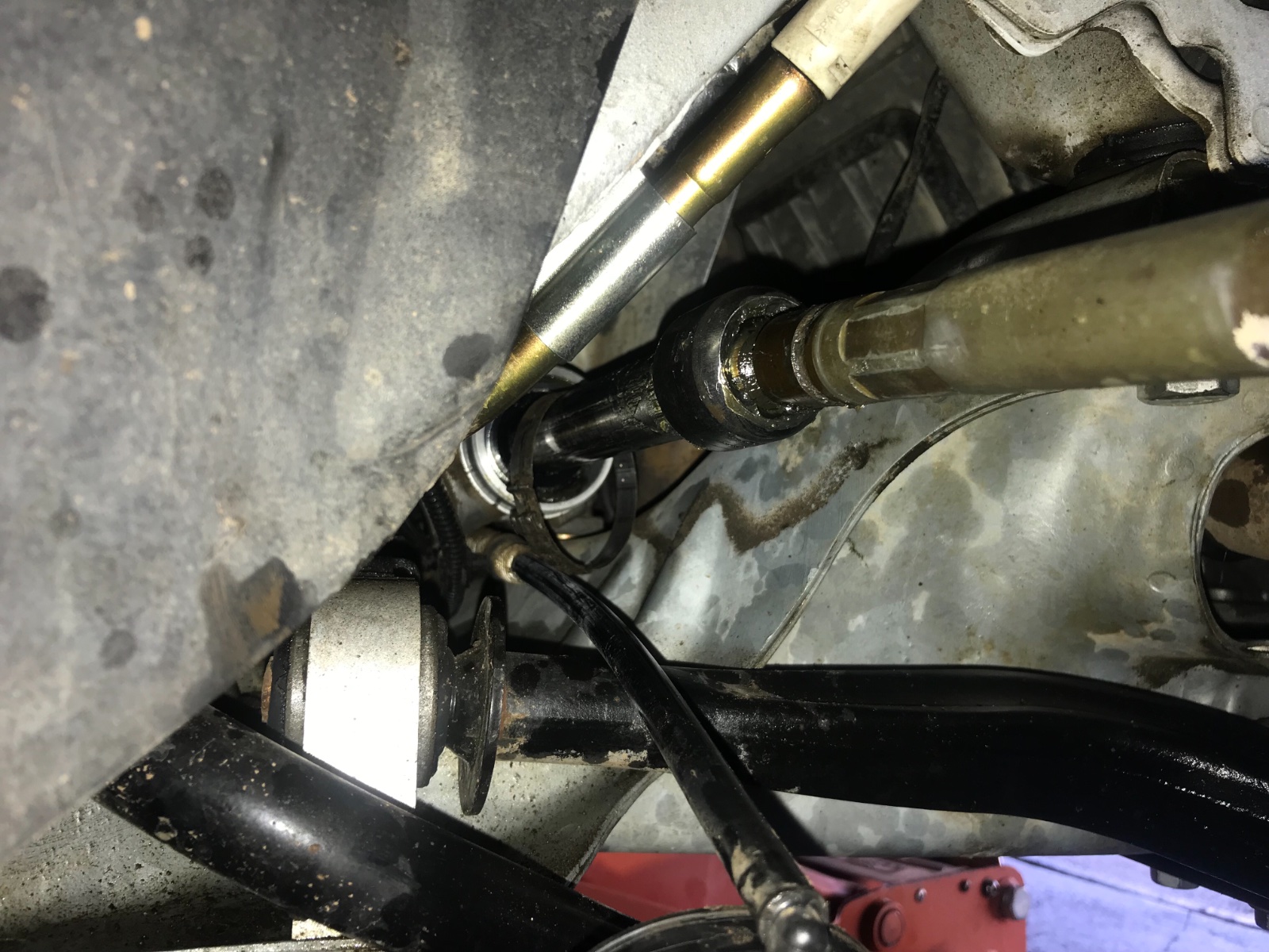

Replaced my inner tierod end. It was straight forward. The idea of no lockingplate to keep the inner tierod in place is quite alarming....
Anycase. My old tierod end did not seem to have mich play. But replaced it anycase and it made a significant difference. I include a picture of the boot. Notice the return pipe which seems to extend as I pulled the boot off. I did not remove the boot completely but enough to get the boot off the tierod end. No leakage from the rack.
It seems I have some play on the knuckle or the spline shaft under the dash too. There is a bit of play. After some lube spray it quiet down but the play is still there. So seemingly that needs replacement too. Basically the unit on the inside of the car. Under the dash, which connects to the steering rack, the knuckle and the upper spline shaft unit is worn out.
Guess next in line that will need replacement. Clearly miles done don’t kill a car but the age even worse! She has done 50000miles from new.

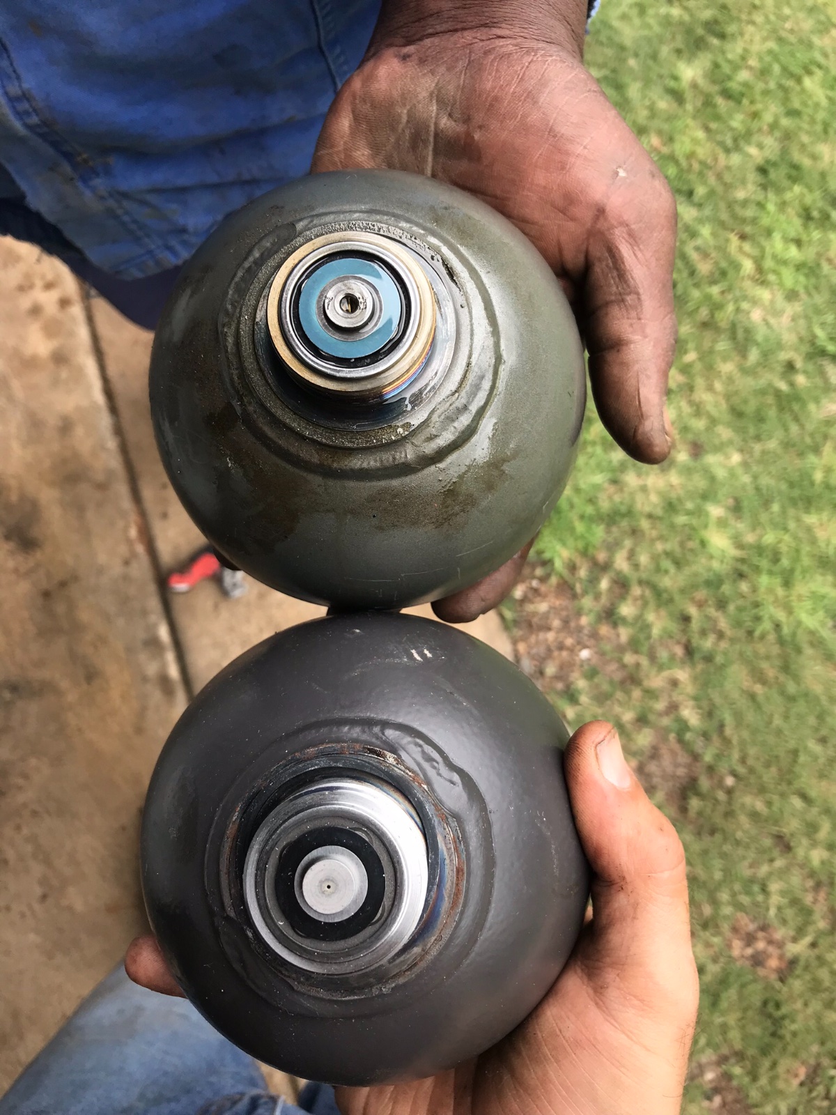

Im not keen on opening another thread so here goes another story... the spheres...
I replaced my c5’s front spheres with units from IFHS.
My diagnostic tool just don’t want to read the suspension ECU. So I went at it manually. Weirdly enough. After lowering and getting wheels in air with the battery disconnected there were absolutely zero pressure in the suspension. I say that because when I opened the bleed nipple on the front central sphere regulator there were no fluid coming out at all.
Ok. Continued to loosening the suspension spheres at the front. They were on pretty tight. Got them off and apon removal and turning it I heard a metallic sound inside the sphere. I shook it and it sounded exactly as a dead DS sphere. Is that a normal thing on a c5 sphere?
I put the old oem sphere next to the IFHS sphere. First of all. The new one was lighter (old one full of oil possibly?) and secondly. The IFHS had a smaller central hole in the shock. It seems as if there is a small wire in the bigger central hole of the OEM sphere.
Went ahead. Installed them.
Got underneath for the central sphere. That was a mission. Space is limited. After loosening the regulator I got exactly one position to get the old one out and new one in. After a while it was in position. While doing all this the LDS got replaced. Well 4 liters of the stuff.(steering rack also emptied by slowly turning wheel lock to lock) Lowered car and did the whole connect battery and leave a while. As soon as I opened the door the pump started to prime. It needed some pressure. Eventually voila. She was at normal height. Moved on to bleeding the suspension from the front central sphere bleed nipple. Alot of airbubbles escaped there. Wow. Thought it won’t end. After about a liter of foam/oil came out I added a bit of fluid and took car for a drive and it felt horrible. Front suspension felt exactly like a car with shocks that are finished. Wheel bounced if I hit a slight imperfection on the road but also. The ride was very harsh. Steering was also a bit notchy at certain positions.. Came home and bled the system some more. Way less air came out. But quite a bit did. Eventually a clear stream came out. Took her for a drive and it felt better. Then you could clearly hear the inner tierod end which I replaced yesterday.
Took her for a 20 km drive on some bad roads. The drive was a bit too harsh for my taste. Turned around drove back and she seemed smoother... after a bit of thinking. Do you guys think that the central hole on the OEM sphere that is bigger can be a more plush ride than the IFHS spheres?
I include a picture of the oem and IFHS sphere

2 things, did you get the correct spheres with the correct pressures, volume and diameter and secondly bleeding.
To bleed the system remove the LDS cap then raise to the highest setting, then lower to the lowest setting.
Keep the engine running and turn the steering wheel very slowly full lock left to right for 10 cycles, then return to centre position. Check the LDS level is correct. This should allow all the fizz and air bubbles to escape. Repeat for another 5 cycles until all the fizz stops.
the car should be on the lowest setting, undo the LFS cap

I gave them my car’s VIN and they sent me these spheres. Ons the box it specifically states it is for a 3.0 v6 and the 2.2 HDI. I can give the specs of the new spheres?
I did axactly that. Lowered and raised the car quite a few times and the steering turn lock to lock. More than 10 times. Steering is now perfect. But the spheres is still suspect. Will send the new spheres specs. Possibly someone with the knowledge will be able to tell if they are indeed correct...

I’ll look them up shortly, but no need to keep raising and lowering to bleed. Only do this once and then the lock to lock must be done slowly in the lowest position only.
- x 6945
Re: Mk1 c5 driver side inner tierod end
Corne: I've posted the Sphere types, part numbers and pressures for your specific 3.0 here, to keep the thread separate:
