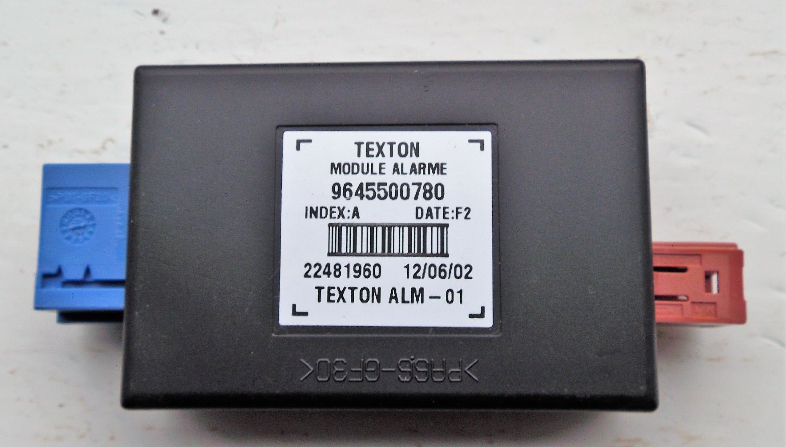

I found it anyway Marc.
- x 6955
Re: Citroen Synergie Immobiliser fault Jan 2019
Yes, that's the one - far too new for a Synergie Gibbo - but at least you found it - time for an ebay session me thinks
- x 2941
GiveMeABreak wrote: 20 Jan 2019, 11:42 Yes, that's the one - far too new for a Synergie Gibbo - but at least you found it - time for an ebay session me thinks![]()
If anyone wants it they can have it free gratis Marc it's just another bit of stuff taking up space, very little space.

That picture is an alarm ECU not a CPH. The CPH is about double the size & has 2 bigger connectors.
- x 6955
The OP started to talk about the Texton alarm, which kicked this side topic off.
