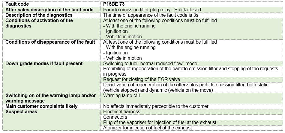

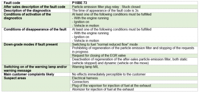

Ok, so here is the P15BE (73) code. Now Iknow there is a TSB (Technical Service Bulletin) that was issued for this problem - but I don't have that document. It would seem it is a problem with this setup.

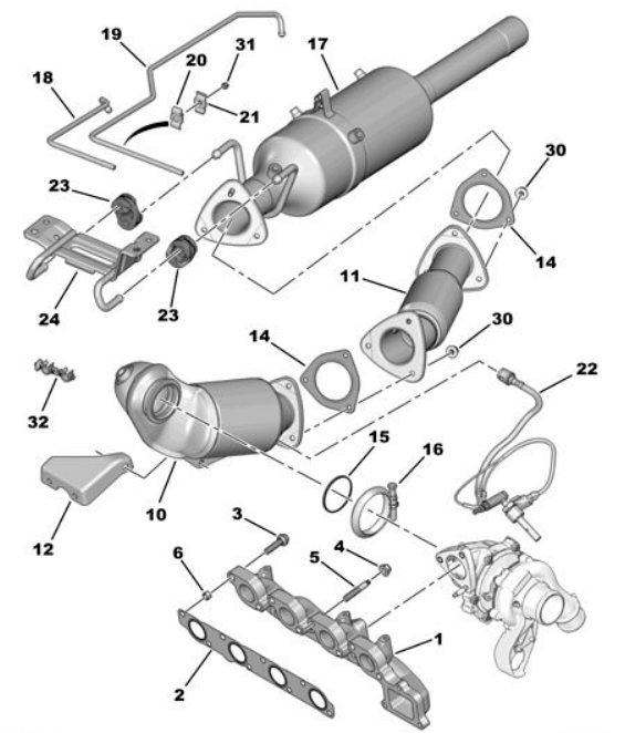

What does make sense is that for whatever reason (wire shorting / heat damage) etc., it is likely affecting the diesel fuel atomiser. A problem with this will put the van into limp mode and if shorting - will of course blow your fuse after a while. If the engine ECU detects an issue with the system it will of course put it into limp mode as I already mentioned a few posts back.
Click the picture to Zoom
Here you can see the fuel atomiser on the diagram - item 22, and a replacement part has been issued - 9816547280
So I can't tell you what the recommendation was that went out to the dealers to remedy the problem, but may be worth a ring to the dealer to see if it was part of a recall?
