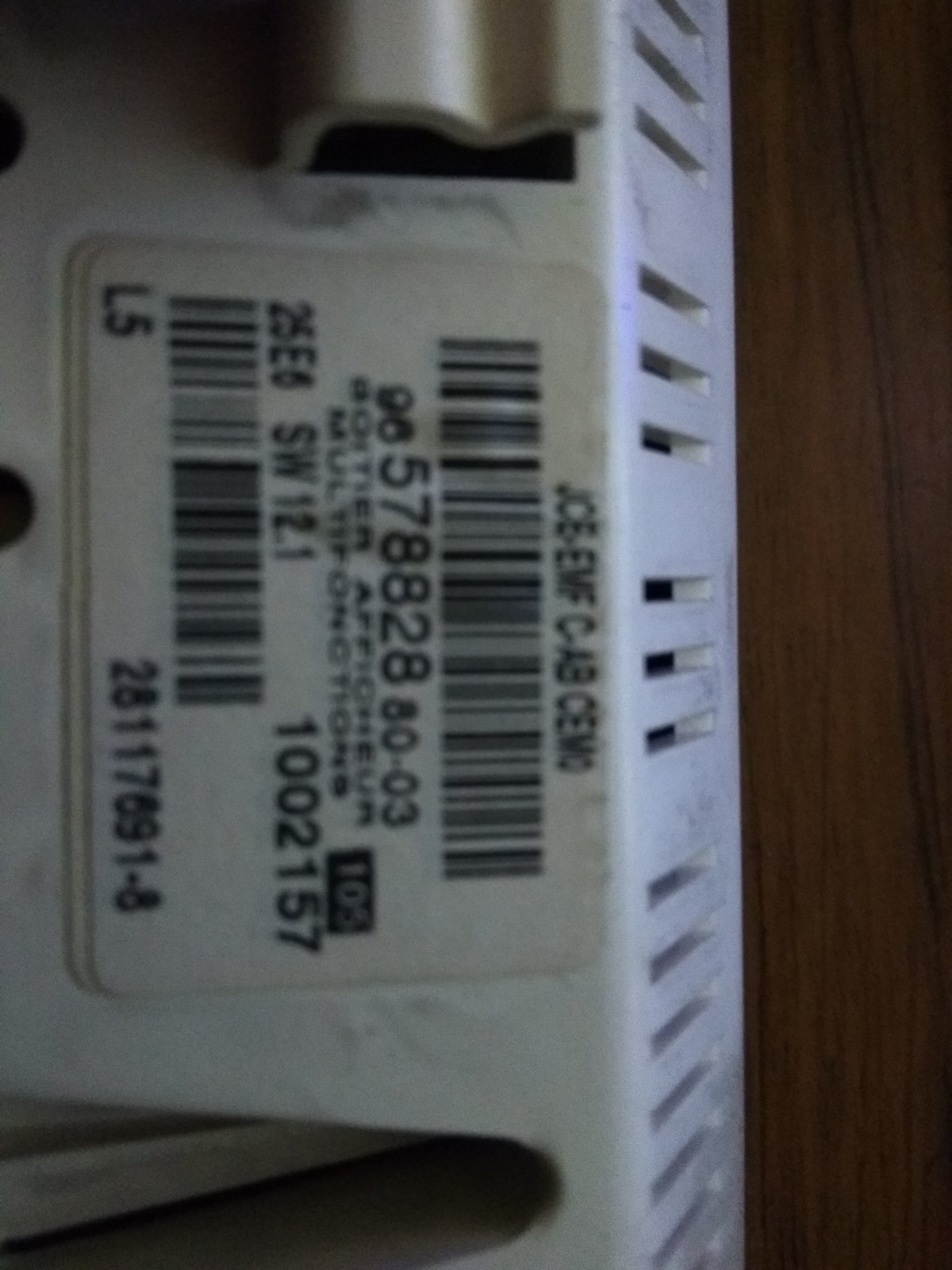

Thanx to both of you. in order to make it clearer, I pictured the label of the MFD that I took from the C5 mkii. I can't guarantee that it was not replaced by the previous owner, but I guess that it's the original part. as per "upgrading" to RD45, I think I'll pass, since it seems to be too complicated, so my main concern now is only to replace the MFD.

Judging by the fact that the rear casing is white I would guess this is made by Borg. If this is the case, don't bother, it will die. The later screens were made by Johnson Controls and had a black case. I'd advise following Marc's suggestions and try and source a black one. To see the issues with the Borg units google '407 mfd'. It is more common on the 407 because the screen is fully exposed to sunlight. It's a little more sheltered on the Citroens but the heat will eventually kill it.
