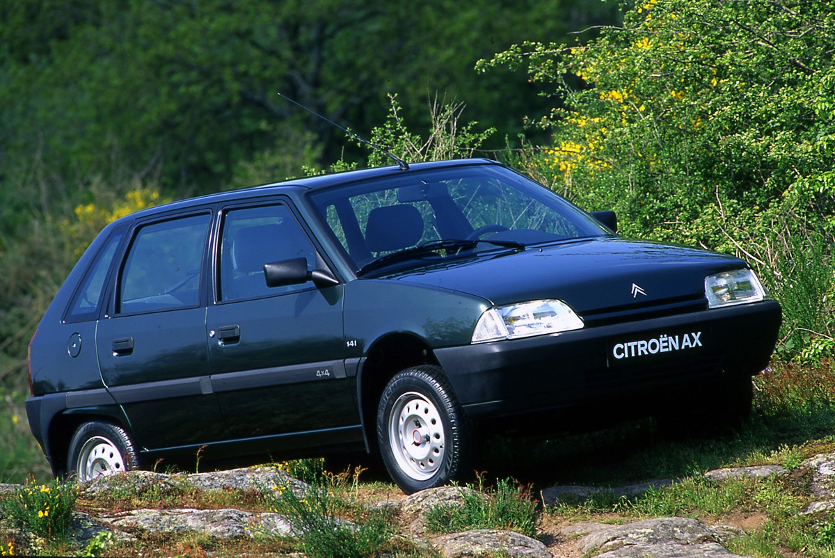

This has been a fascinating thread, I must say, not least my discovering there was a 4x4 AX (although not for the UK). Wikipedia has it all.
