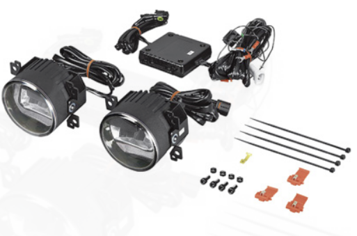

I'm sure your wiring skills are legendary Sparksie
(sincerely meant) and my comments about aftermarket DRLs is a personal one from the many awful ones I have seen on the roads fitted to older cars that just look stuck on with a bit of velcro jobbies. I know that OSRAM and other companies to some tidy retro EU legal kits that fit into the round fog light recesses of cars - and these do come with some advanced electronics to ensure they work properly with the vehicles lighting systems:
https://www.nightbreaker.co.uk/ledriving-fog
But like anything half decent, it has a cost - a few pence short of £250 for this kit for the LED Fog and DRL function combined.
