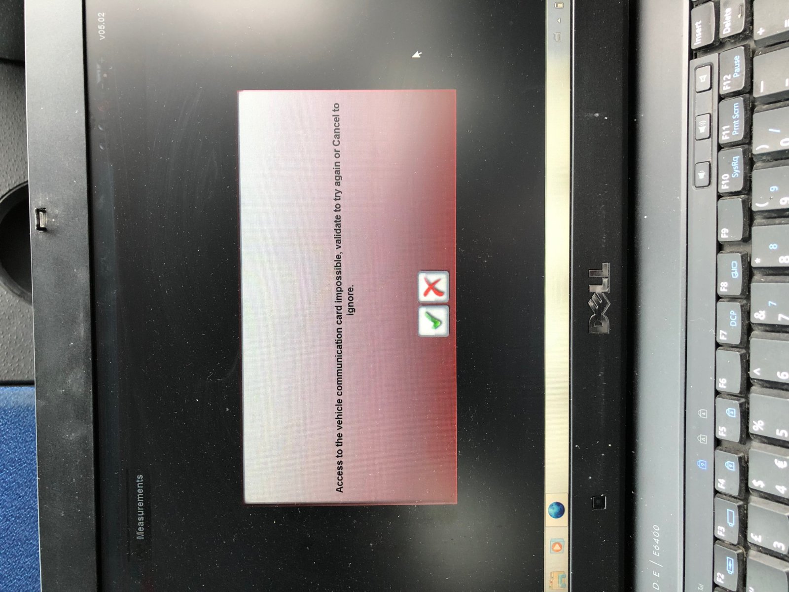

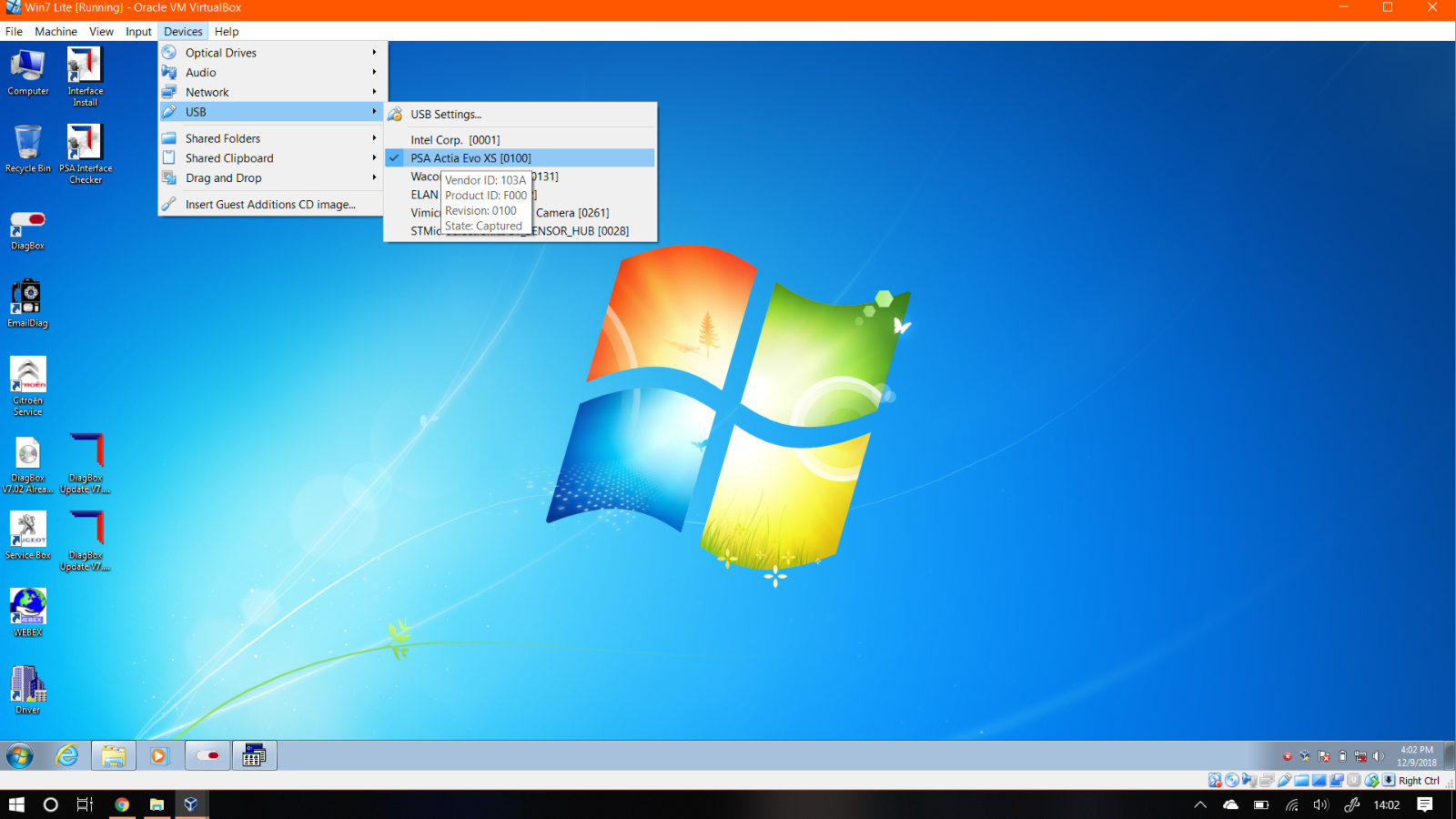

Re: Lexia making me want to tear my hair out.
Sorry Marc, thought i'd mentioned it!
The old laptop i've set up is causing me more issues than my virtual box, and is considerably heavier, slower and worse battery than my thinkpad!

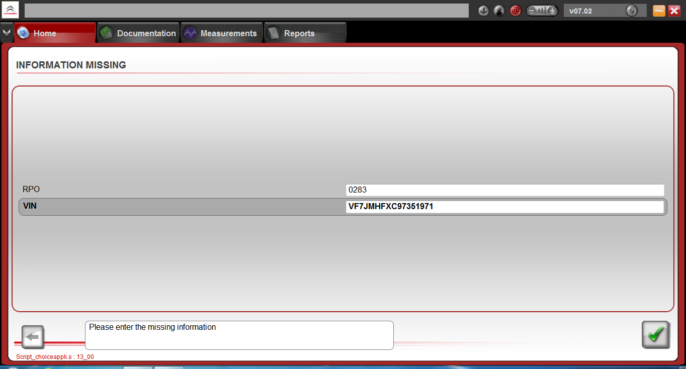

I've posted a screenshot below, the tool seems to mount just fine.

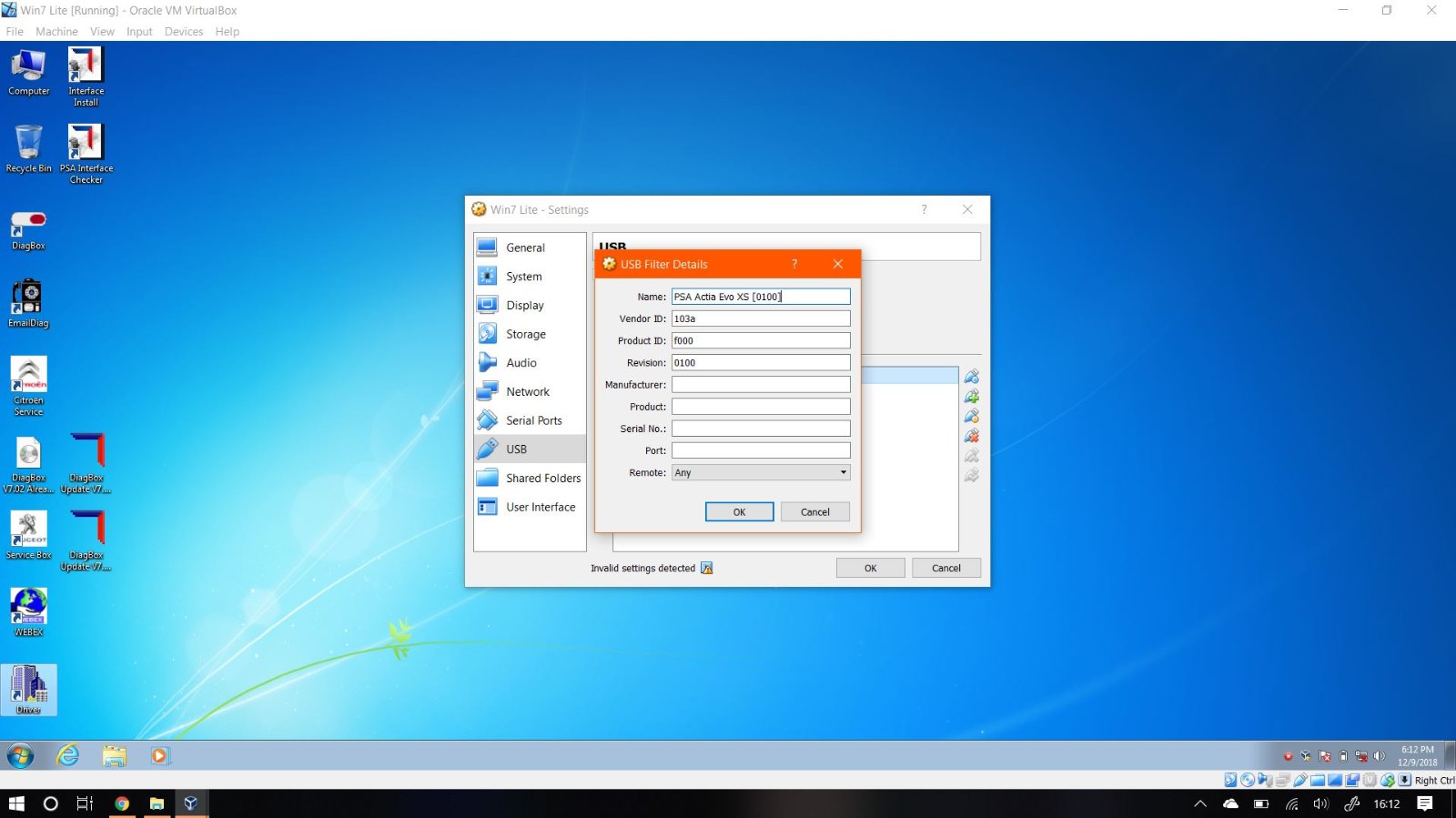

- x 6963
Ok, but in the virtual Box Manager, under the USB filter properties for the Actia, did you go to properties and set the REMOTE property to ANY? This can affect whether communication on the port is allowed.

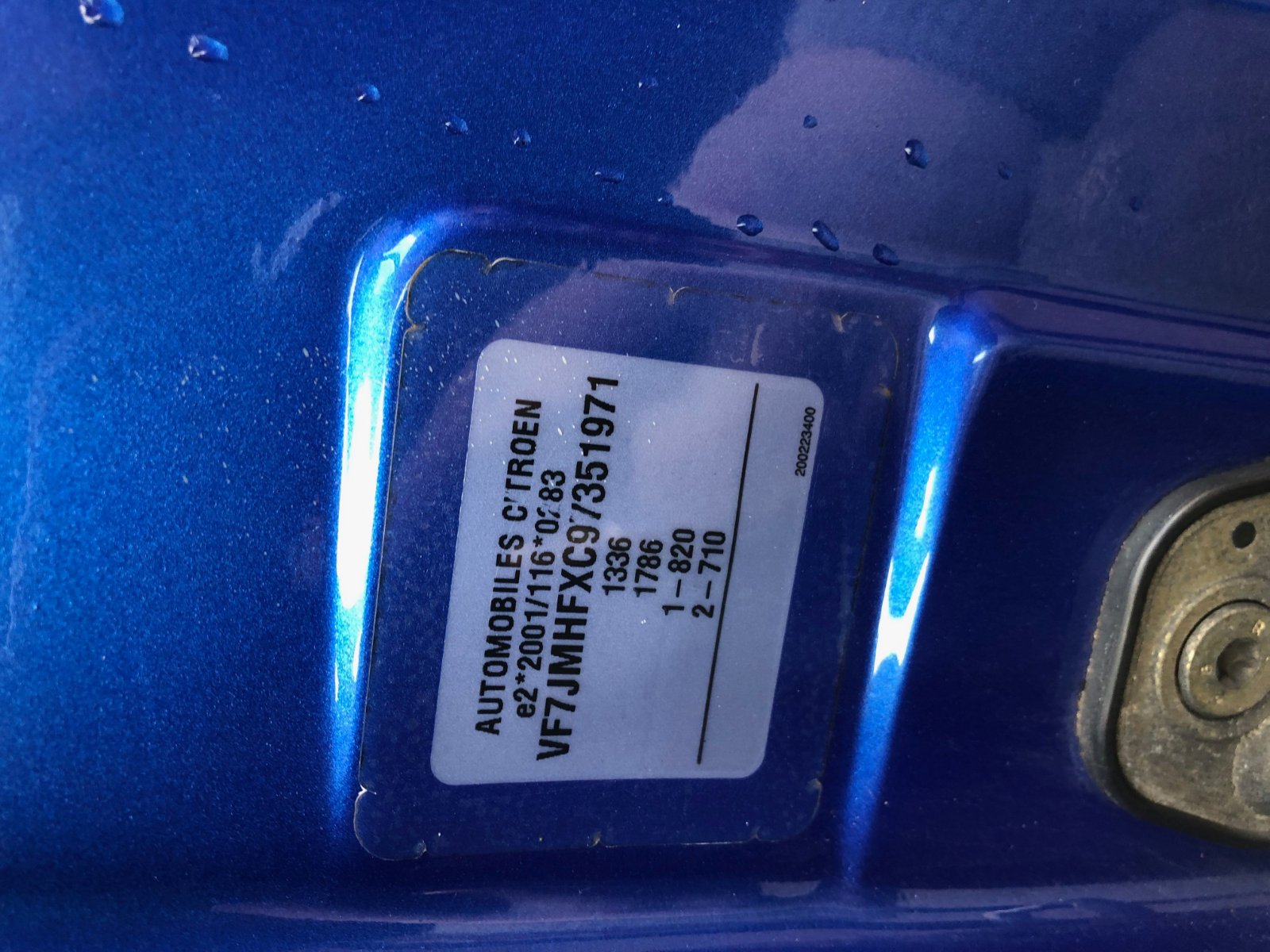

So my other machine has decided to let me run 7.02. I put the USB in and it seemed to mount. Still no communication with the car.
Just to confirm - my RPO is 0283?

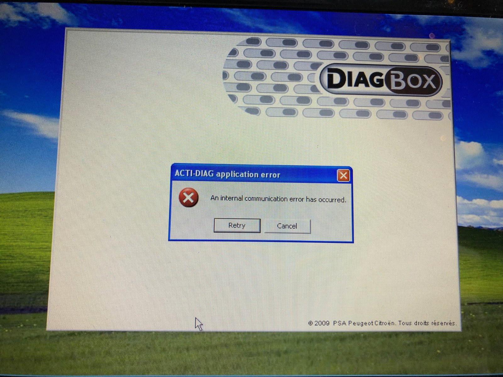

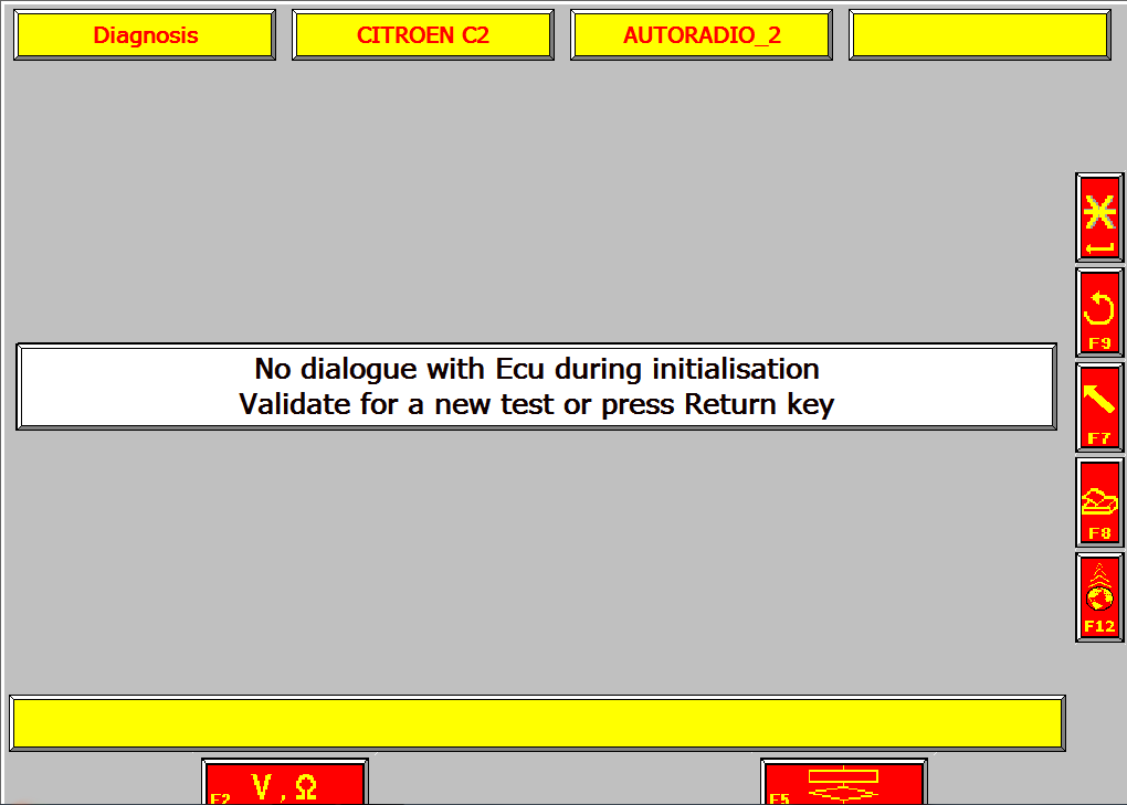

Good afternoon all, hope you're having a great Christmas!

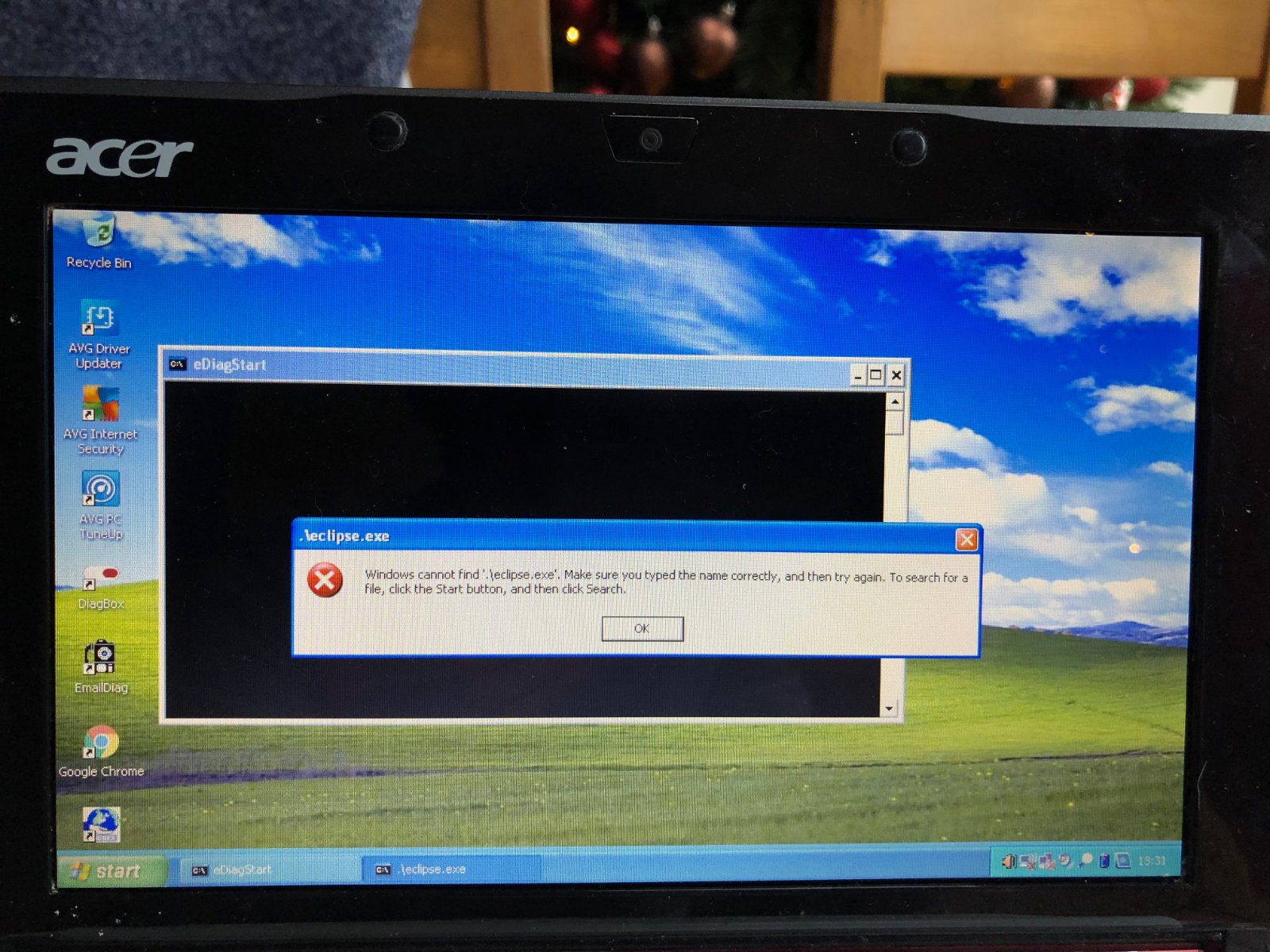

I've got my hands on a Windows XP netbook, and a windows 7 laptop (which has 5.02 installed- wow!) and i'm still getting errors. I'm beginning to think it might be my car?
Errors posted below if anyone has any ideas!
No, if this is the C2, your RPO (build date) is: 10661 (16th Jan 2006)

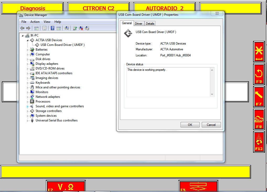

I think you have some other issues going on there - communication issues for sure. On these netbooks / laptops are the evolution USB drivers showing as installed in device manager without any yellow exclamation marks?
XP machine showing drivers exactly as I'd expect them to look- but I can't load Lexia.
I think I might reinstall Lexia and see how that goes.

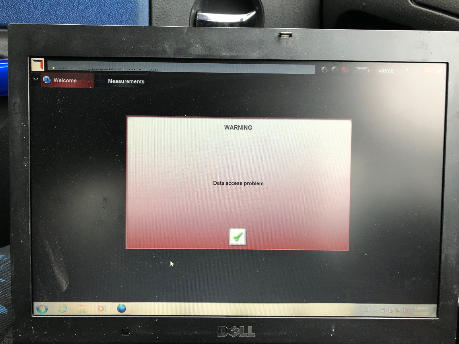

tomjyoutwit
- Posts: 127
- Joined: 17 Nov 2018, 13:11
- x 5

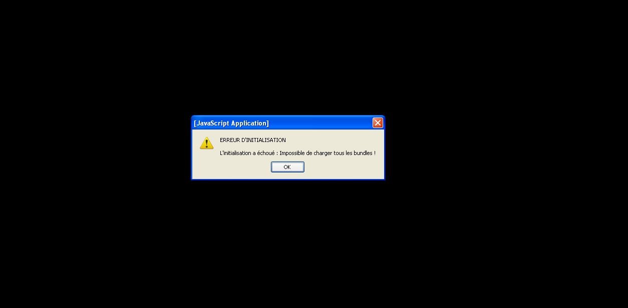

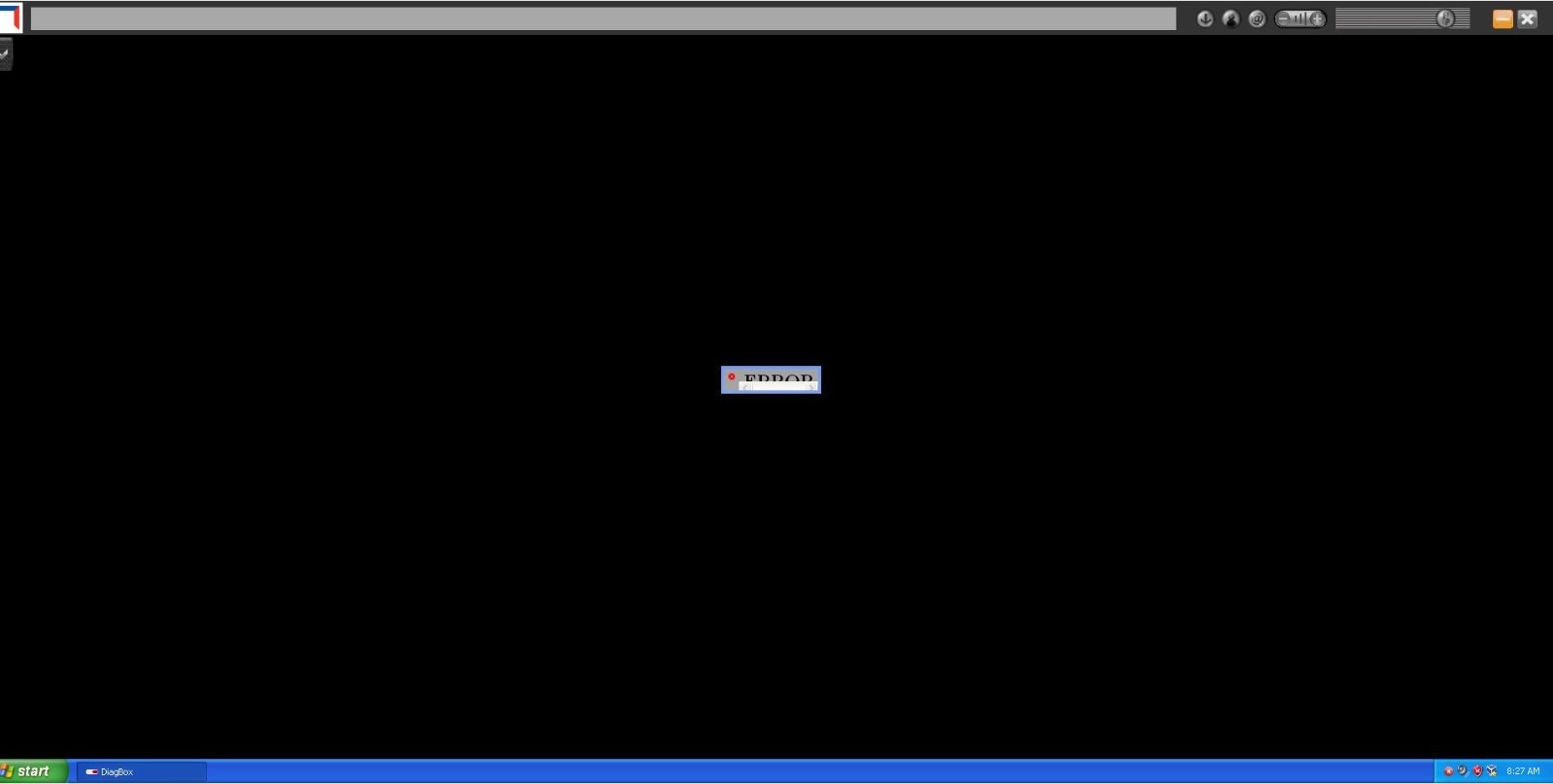

So i've made an XP virtual machine on my Thinkpad, the netbook I was using was throwing up too many issues. I have installed Diagbox, activated it, the extra files were then installed, diagbox launched and then I closed it, plugged in my Actia cable, opened Diagbox let it "Update From Internet" and now these are the errors I have.
Should I update from 7.02 to a newer Diagbox and hope that cures it? I'm a bit cautious of doing this as I won't be able to roll it back if I have any issues.
Thanks again for your patience and help all, I do appreciate it!
