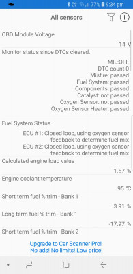

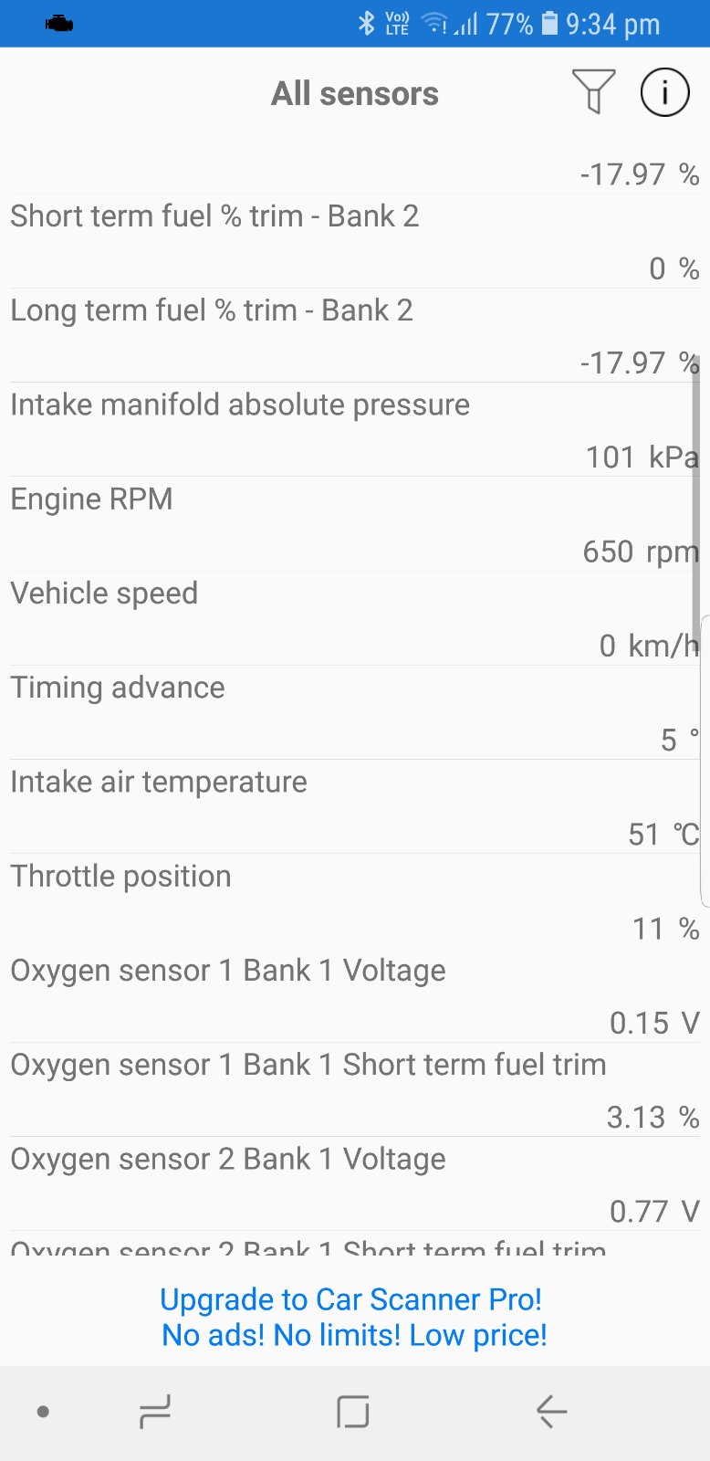

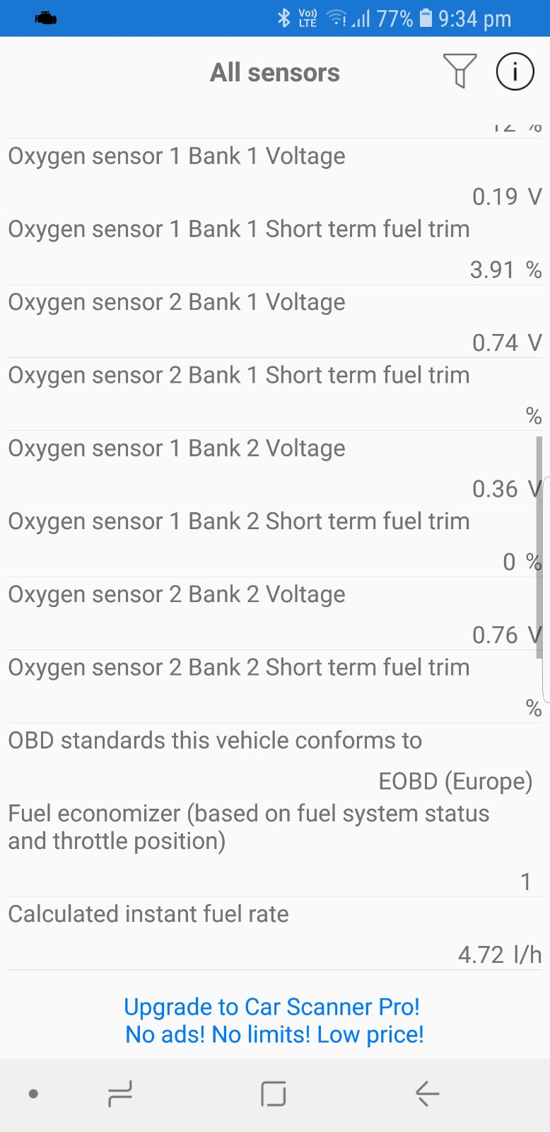

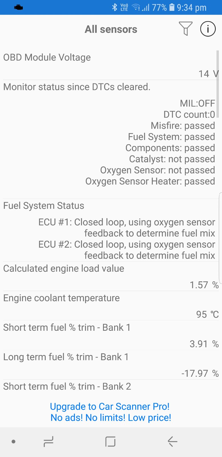

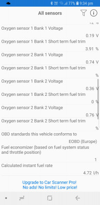

I was able to read sensor data using generic obd2 but dont know if it is accurate or not. I can hear vaccume leak but not sure where it is coming from. If it is leaking from intake manifold then how to fix it. It also shows P0171 error when i scanned this morning.
While fixing rocker cover leak, rear platic cover oil breather pipe cracked and i have to use rtv to fix. I also applied rtv to other hose where i suspected could leaking too. Does rtv damage oxygen sensor?
Image order: 2,3,1

I have checked voltage of both o2 sensor and they are not steady. Also read about short term fuel trim that also suggest MAF or catalyst. I had this issue before but it used to come up around 1000km but now it comes up every 100km after clearing code. Does cleaning MAF makes any difference?
Thanks
Thanks

P0171 isn't a specific fault code that comes up for this engine - but relates to the fuel mixture being too lean (not enough fuel).
But as I mentioned before, P0430 relates to the ageing of the pre-catalyst (rear cylinder bank) so you need to connect your scanner and go for a spin and check the data for the Downstream sensor; the voltage should remain steady as you can see on the blue line in the example in the video (not for the same car obviously). If the Downstream line or voltage starts fluctuating like the upstream one in Red, then more than likely, your CAT is at end of life and needs replacing. It's not done bad for an 18 year old car if on the original - but these things have a finite life.
You have separate issues going on here - a leak and a Cat problem.
If you had a MAF issue, then I would expect a code related to the air system that would indicate that. Although cleaning the MAF is recommended (with caution, using appropriate cleaner and not touching the sensor wire), this is not going to resolve the main issue that your CAT needs replacing.
How many miles has your car done?
The average life of a Catalytic converter is about 100,000 miles or 161,000 Km

So on the money there then, it’s about end of life and if the readings for the downstream are fluctuating then that would confirm it.
