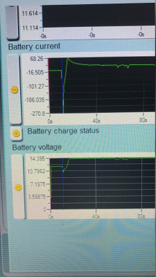

This pic here is the starting sequence of my engine showing battery current and voltage that I recorded with diagbox.
From the smooth way the voltage climbs to 14v once the engine finished cranking I'd say that the control signal to the alternator might be PWM or analogue rather than a digital signal?
