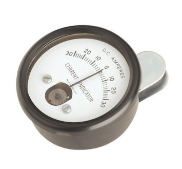

If you have a high-rated DC ammeter handy, you can check what the GP relay is delivering to the plugs.
There is a 75A version of this, by Sealey (available from Amazon, etc.) It simply clips on to the wire, and doesn't involve cutting it.
