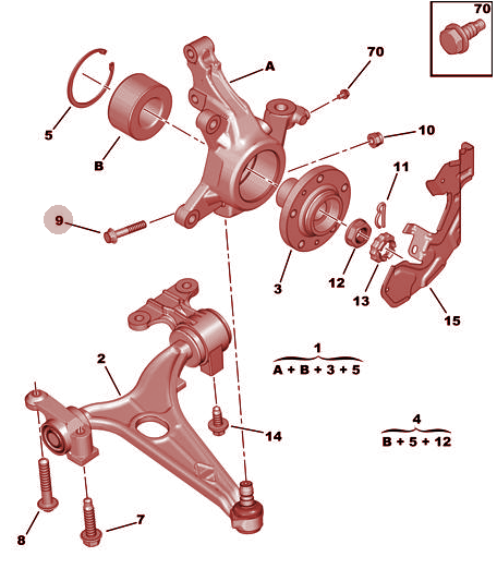

- x 6945
Re: Knock on front suspension Dispatch 1.6
The bolt is shown as number 9 Rich on the diagram below: Part 362264 for the bolt and 362233 for the nut (item 10)
£2.74 & £2.95 inc. VAT Respectively.
That is the bolt, it is threaded halfway but don't be surprised if you are offered one threaded all the way. I prefer the half way of the two.
