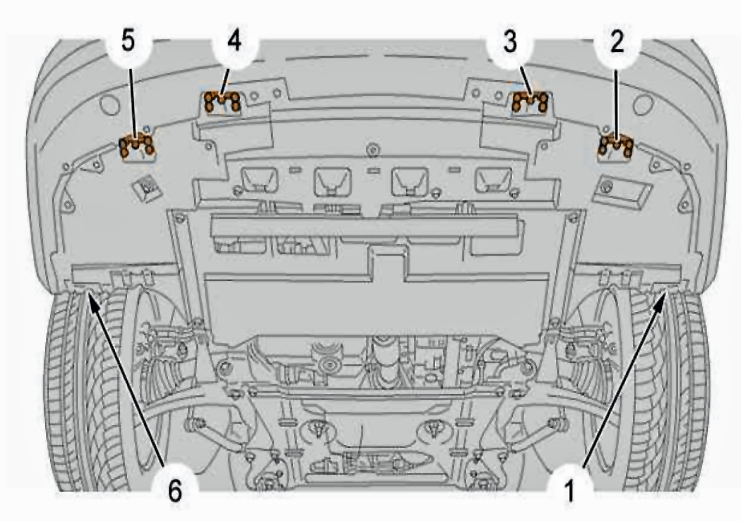

As an aside, both these cars have Lane Departure detection. Where are the sensors to detect lane departure or are the same parking sensors used for this function?

Hi Bob - no, the Lane Deaprture Warning System (AFIL) Lateral Trajectory Monitoring sensors are located on the underside of the front skirt and sides, 1 to 6 as shown:
