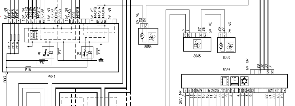

GiveMeABreak wrote: 09 Sep 2018, 17:24 To confirm then - you are getting the lighting up of the segments of the blower motor on the panel, but no fan at any speed?
Yes, you are right. Display shows the normal increment of fan speed but actually, nothing practically is happening. :cry:

GiveMeABreak wrote: 09 Sep 2018, 11:52
  • 8045: Blower Control Module
  • 8050: Blower Motor
  • 8085: Blower Motor Power
  • 8025: Is the Climate Control Panel

Re: Citroen C3 aircon fan problem
The C3 Aircross diagrams are not widely available, mostly to the trade that have to pay for access to these From Citroen. Some more general diagrams can be found from publishers of technical manuals:
For example:
https://haynes.com/en-gb/citroen/c3-air ... sel-439932
But these only cover some petrols and the 1.6 Diesel engines
