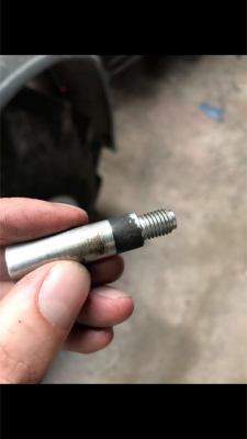

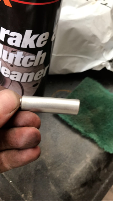

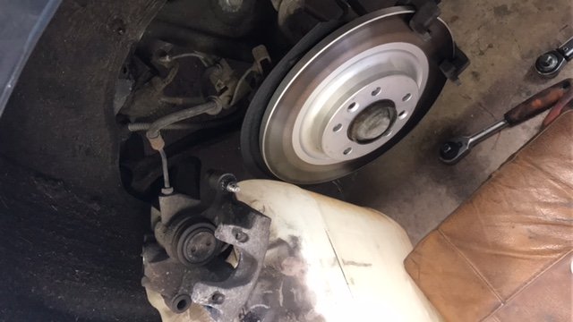

A follow up a mere day after fitting the new brakes.
I went for a short drive, around 10 miles on a dual carriageway but upon arriving I could smell brakes burning. I found that the rear passenger side wheel was hot! bad news. I gave the caliper a few knocks with the tyre wrench before returning to base slowly. When I got back the brake caliper on that side was hot but not overheating.
I had an idea that it may be the slide pins which were to blame so I took one off for a look:
It had a layer of filth on it preventing smooth motion of the caliper.
I cleaned them up with brake cleaner as a slightly abrasive pad before a liberal application of grease and refitting the whole calipers.
I've been for a short drive now and all appears well. I'll have to repeat the longer journey tomorrow to confirm.
Just wish I'd remembered to do it yesterday
