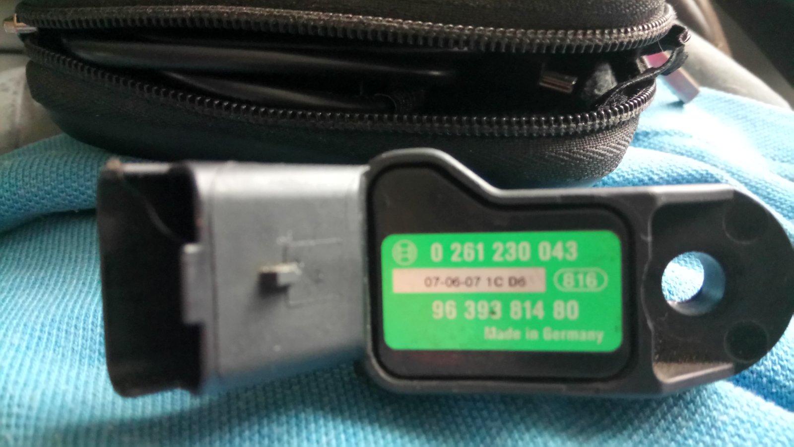

To date this is where I am with this Saxo Map Sensor[or not problem]. I awaited delivery of a brand new Map sensor which when received I fitted, then before driving the car I tested it with the Autel OBD No codes were returned, so I thought great, tried it out on a two mile run and it ran perfectly, idled perfectly, so I assumed it would test perfectly,nevertheless I tested it and it again returned a fault. Took it out ten miles and it was dropping the revs as before and had I not give it some throttle I am sure it would have stalled. So that is that I need to look elsewhere as three Map sensors cannot be wrong and I just do not get it, unless it is an earth fault and I am not about to test three Map sensors, [wouldnt even know where to start] or get a new wiring loom, the expense is getting to me now, so I will cut my losses and take it to an auto electrician, that is if I can get it there, certainly it will not go to Citroen where I know it will cost me an arm and a leg so to speak to even check it. Again any advice would be very much appreciated, for tbh I think I may well have to scrap this car because of this problem as it is looking like an ECU problem, or is it?
New Bosch Map Sensor
