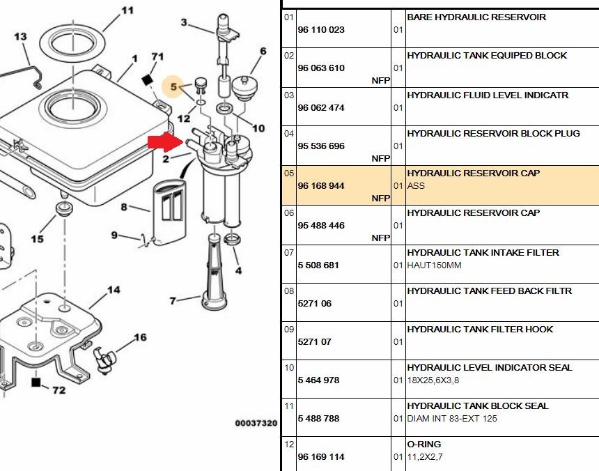

Click on Diagram to view clearly So far as I know, you were right, the (suction) supply pipe to the pump is the front one - arrowed red.
I also remember that someone a while back reported a leak on #5 (Reservoir Cap) and its O-ring #12, which allowed air to be sucked in. Cap no longer available, but the O-ring is. I think it was easily re-sealed.
>>> If I'm off the mark here, one of the team will correct the info.
