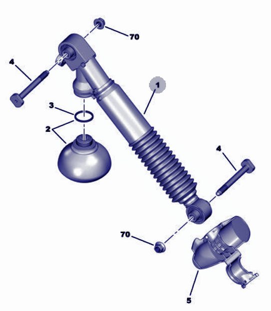

Hi Vlad - 527299 is the part number of the strut for your X7 - there is no difference between left and right :wink:
But - also consider that the leak may be coming from the suspension sphere - to strut seal (number (3) in the diagram. I guess you won't know for sure until you can confirm it.

Do You know if I can buy the part 3 from the imageV I have not identified it up to now...
x 6957
Re: Citroën C5 X7 OSR hydraulic leak
Yes Vlad, the square seal is part 527215 (37.4 x 42 x 2.6) and is always recommended to be replaced when the sphere is replaced or removed. It costs £5.26 inc 20% VAT in the UK from Citroen - so should be a similar price or less over there with you.

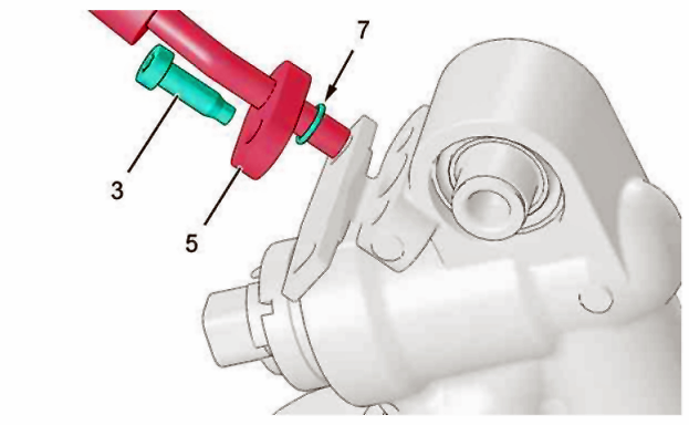

Good evening!

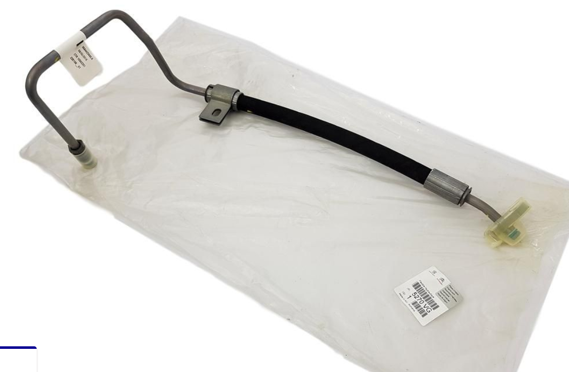

After 180.000 km I faced with the need to replace rear pipes from regulator to struts.
So pipes are prepared but I can not find part number of T40 bolt - pos.3 on the picture from manual, which fixes the pipe to the cylinder top.
Is it necessary to purchase O- rings, or new pipe comes with rings?
Thanks in advance for your help
You'll have to load a picture up so we know exactly what you are referring to. But if it's the hydraulic tube (this one shown here is for the left side only as an example) then it would appear they include all the fixings and 'O' rings as you can see: (click image to zoom).

Thanks
Got it about the O-rings
And what about bolt?
As I see it's not included

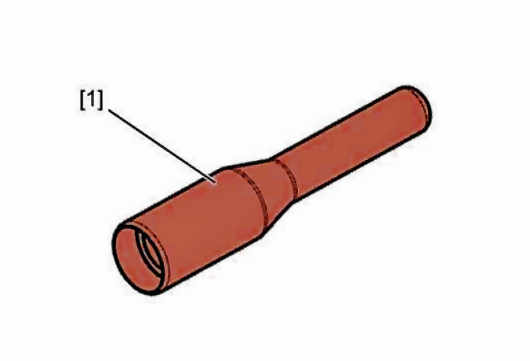

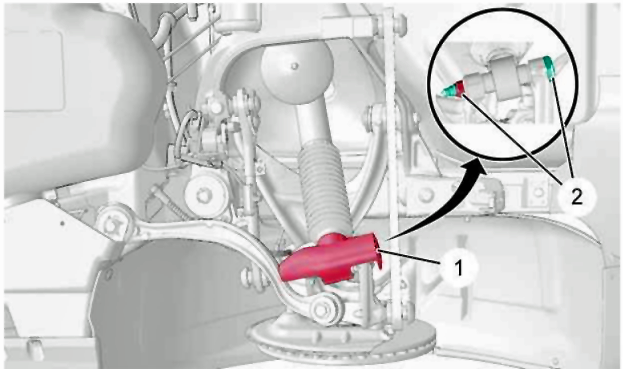

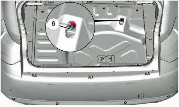

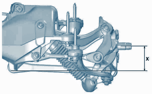

GiveMeABreak wrote: 15 Oct 2018, 20:02 Ok, here you go: I know you have Diagbox, so in your case it will be easier to depressurise the system using that - although you can disconnect the battery and depressurise the rear axle manually only if you want. Let me know if you want to do that.
[1] Drift for fitting seal on pipe (Suspension cylinder side).Removing
  • Depressurise the Rear Circuit
  • Disconnect the battery.
  • Raise the vehicle and support on axle stands, wheels free.
  • Remove the rear wheel.
Remove:
  • The protector (1)
  • The bolt/nut assembly (2)
  • Close the hydraulic unit openings using caps.
  • Remove bolts (3).
  • Uncouple the hydraulic pipe (5).
  • Remove the bolt/nut assembly (4).
Removing: Right-hand upper fixing
Operations to be performed for access to the
bolt and nut assembly (6) on RH side:
  • Lift the spare wheel carpet
  • Remove the spare wheel
  • Remove the blanking piece
  • Remove the bolt/nut assembly (6)
Remove the suspension cylinder.
Refitting
Refit without tightening:
  • The suspension cylinder
  • The bolt/nut assembly (6)
N.B.: Refit a new seal (7); Using tool [1].
  • Couple the high pressure piping (5).
  • Fit the bolt (3) ; Tighten to 2 ± 0,2 daN.m.
"X": Dimension between the measuring zone under the rear axle crossmember and the centre of the wheel = 111 ± 1 mm.
Position the longitudinal suspension arm to the dimension "X".
Tightening torque:
  • Tighten the bolt and nut assembly (4) to 7 ± 0,7 m.daN
  • Tighten the bolt and nut assembly (2) to 7 ± 0,7 m.daN
Operations to be performed ( right hand side):
  • Fit the closer
  • Fit the spare wheel
I meant this manual and bolts pos.3
x 6957
No, they are not supplied, but should be reusable as they are only bolts.
