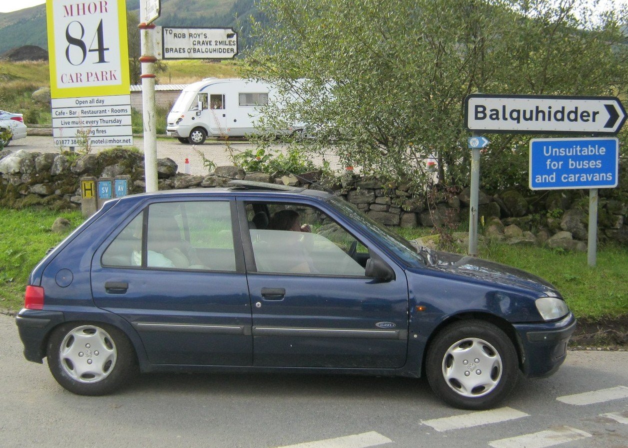

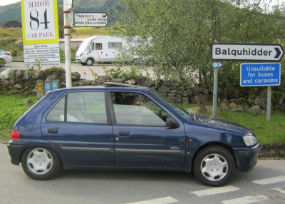

Daughter's Mk2, pictured 4Up, on the way to Rob Roy's Grave. It returned a not particularly impressive low-mid 40's mpg on that run, about 1000miles in all, but it was 4 Up (all Adults) and Luggage, mostly at 75mph to 80mph on the motorway.
