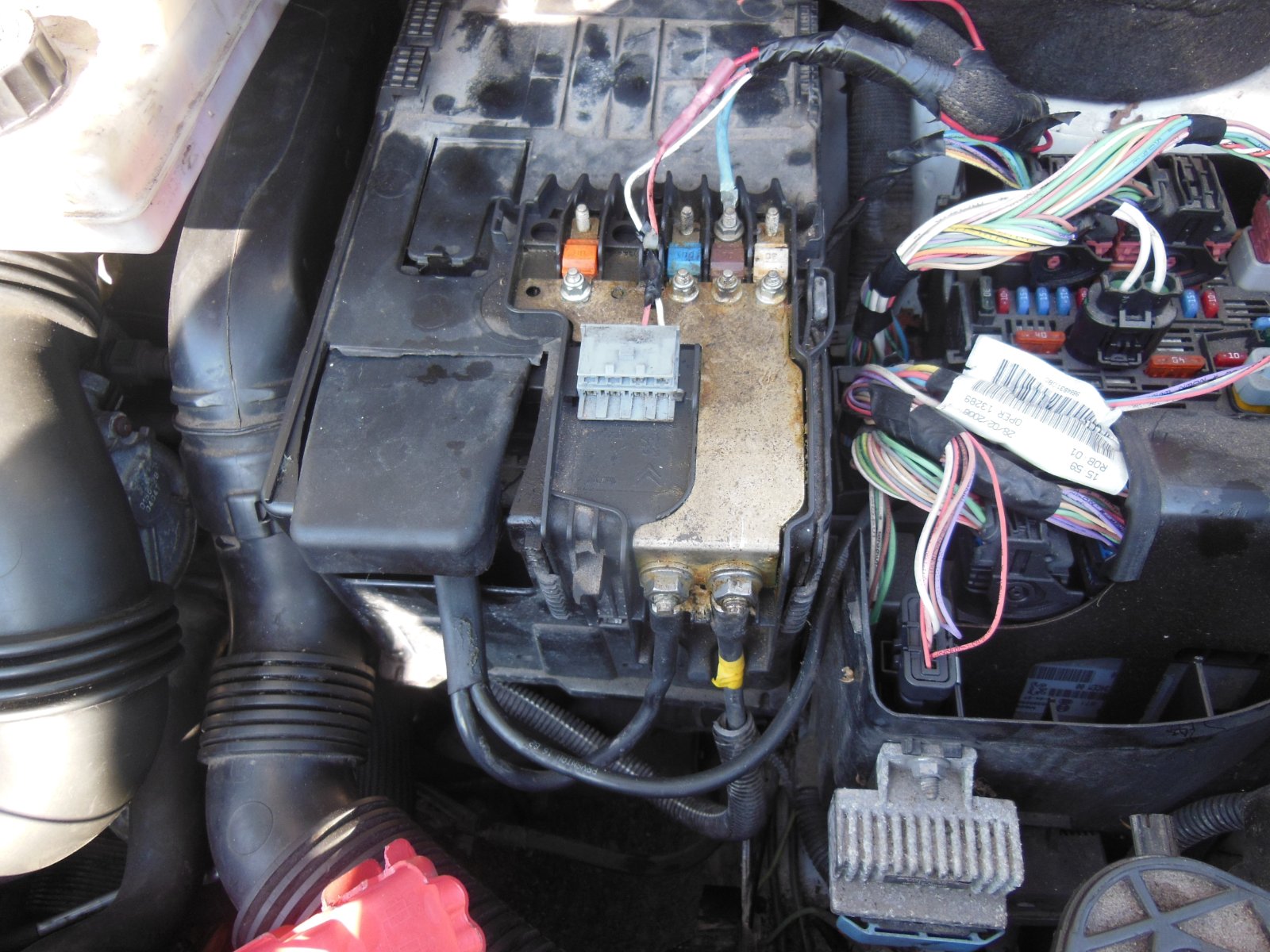

Left the van well alone all week as it was driving me mad. Had a look this morning, I now know the switch is good and pin 1 should have a permanent 12v feed (with ignition on) that flows through to pin 2 when the plunger is depressed. PIn 1 is dead, I took out all fuses in Engine bay and Glove Box, I tested all fuses with a meter and all were good, I then back probed pin 1 and checked all the fuse holders for continuity and got nothing, so assumed there must be a break in the wire from switch to fuse, for some reason probably frustration, I decided check the "fuse box" on top of the battery, and found that there is a grey 8 pin connector on top of the battery and the wire from pin 1 went here. But...................there is no voltage at the wire, so gents can anyone enlighten me as to what this battery fuse cover does, or rather should do because I have feeling my wire shouldn't be there and someone has run it here for an unknown reason. Along with the grey connector block, there is a metal plate which has 4 threaded bolts with 10mm? nuts on them, what appears to be different coloured fuses? and then the same 4 threaded bolts with nuts on the otherside, one has a blue cable running from it.

That's the correct location - see my post a few days ago. Is there a cover on the front of the connector? Just looked on my C4 and once the top cover is off, there are a handful of fuses on the front of the connector. Can you post a pic of it?

So looks like this is the problem. The wire goes into the top of the connector and the connector directly below has voltage, so a trip to the breakers to get that yellow bit that clips on and a couple of fuses and I should be good to go. Out of interest what does the other wire into that connector feed?

Richard having re read your posts, I see you did say about the fuses on top of the battery but since there weren't any there. I assumed you meant the main box beside it, hindsights a great thing, makes sense now.
Now I have power to pin 1, always a but, but..........still no lights, I cant get the power to transfer to pin two through the switch, I can get lights by bridging the connector on pins 1 and 2 but not to work when pressing the plunger, so logically it must be the switch. But the switch bells out OK and worked when I tried it in my sons van. It's the same regardless whether I try the original one or the two new ones.

Okay this is an old thread but if you look at the picture posted by Richard it shows a non molested set of fuses and engine fusebox.
Compare that picture with the one posted by Tex and you can clearly see additional wiring which should not be there and has probably been added as a work around to an issue with the main engine fusebox which is clearly visible on the right in the picture posted by Tex.
Hagrid's post is way above my pay grade electrics baffle me but when i had an issue with my old C4 2005 fusebox i had the brake pedal being pressed causing the engine to stall and the wipers to come on etc. and yes my engine fusebox had been molested before my ownership
Colin
