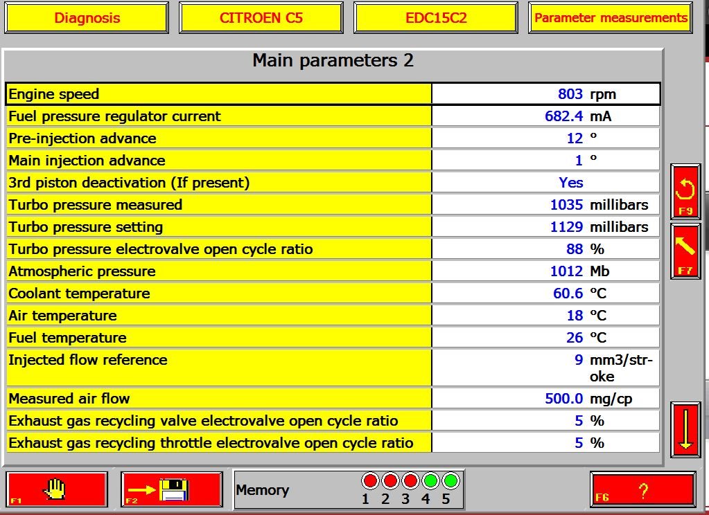

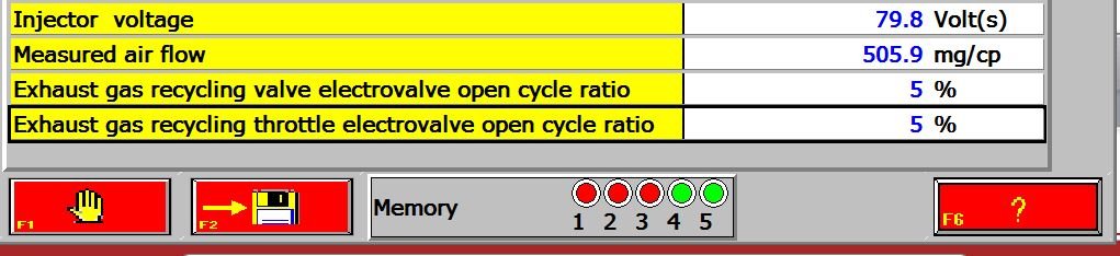

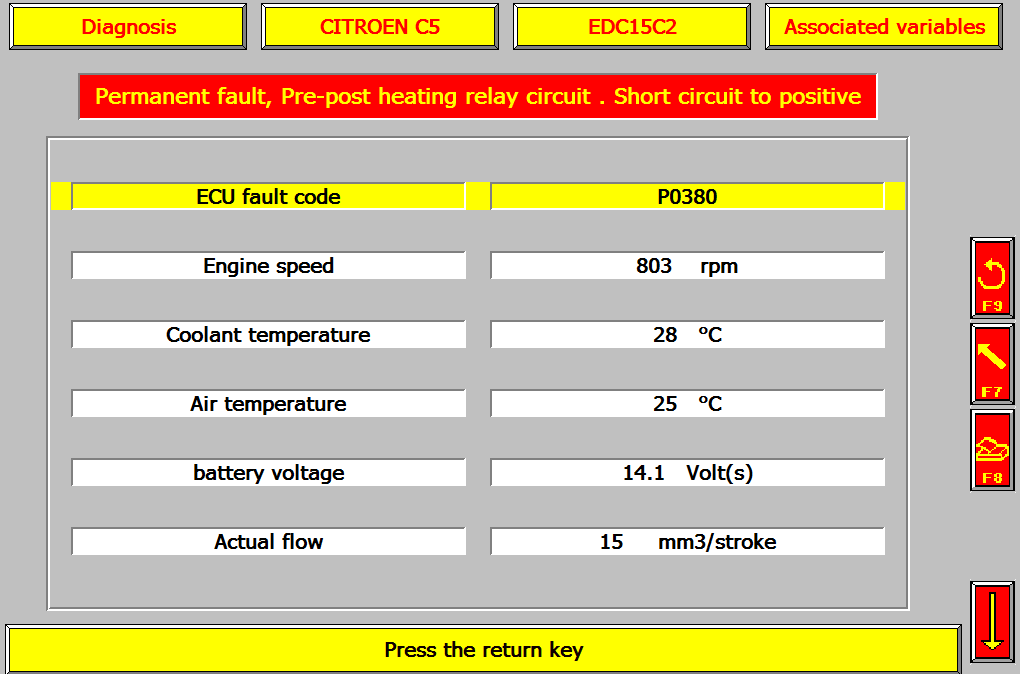

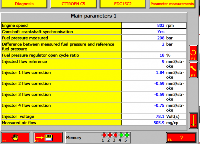

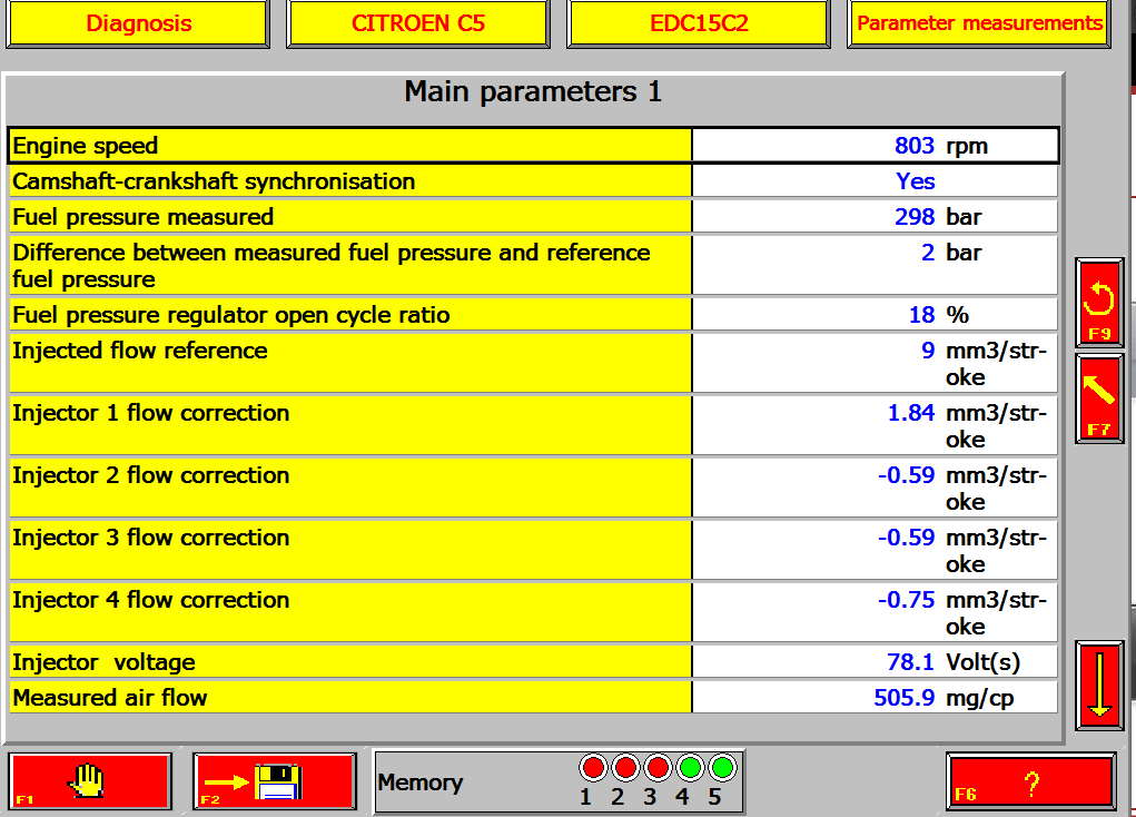

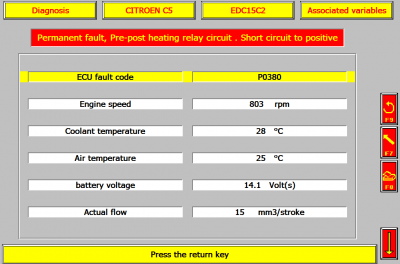

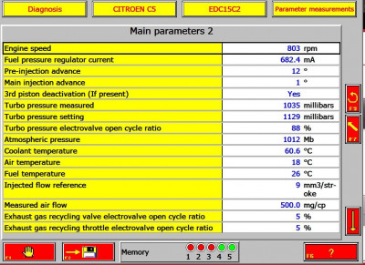

Hi, well after help from Easydiagnostics, big thanks, and several re-installs I now have a working copy of Lexia3 and it is very good.
I have captured some data and I wondered if those who have experience would be kind enough to check the data values for me and offer some advice on how to put things right.
Thanks
