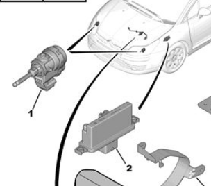

Also, is there such thing as an ECU for directional headlamps? I thought BSI and headlamps communicate directly, without an additional ECU.
I was trying something in Diagbox and have gotten directional headlamps ECU error. It went away, but I'd still like to know if there is in fact a physical ECU.
- x 6950
Re: Interior lights in a c4
Hi
Yes there is a separate ECU. If you look at the post in the following link, I have put up the flowchart for somebody thinking about a conversion, which is not really practical. If you look in the table for 6608 that is the Directional Headlight ECU, which is separate to the BSI.
viewtopic.php?f=3&t=60287#p577335
| Here's the ECU, shown at (2) |
Thank you very much Marc
Found anything useful for dimmer fault?
