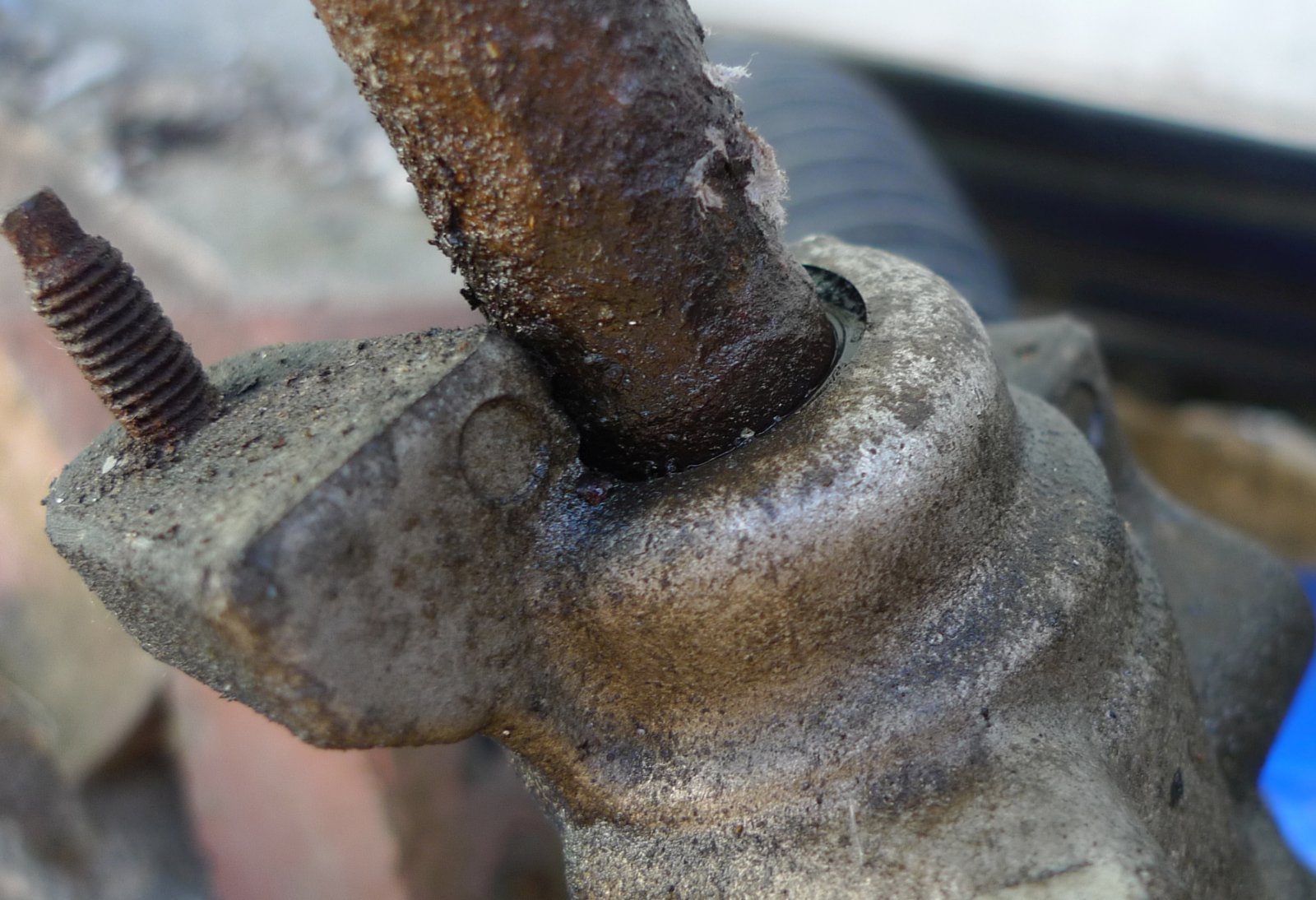

Bear in mind though that this is what the shaft looks like.... so finding a sound bit of metal to measure off might prove a little tricky
Measuring the diameter shouldn't be a problem, but getting the shaft out might prove a little more time consuming - and I'm a bit short of time for the next week or so

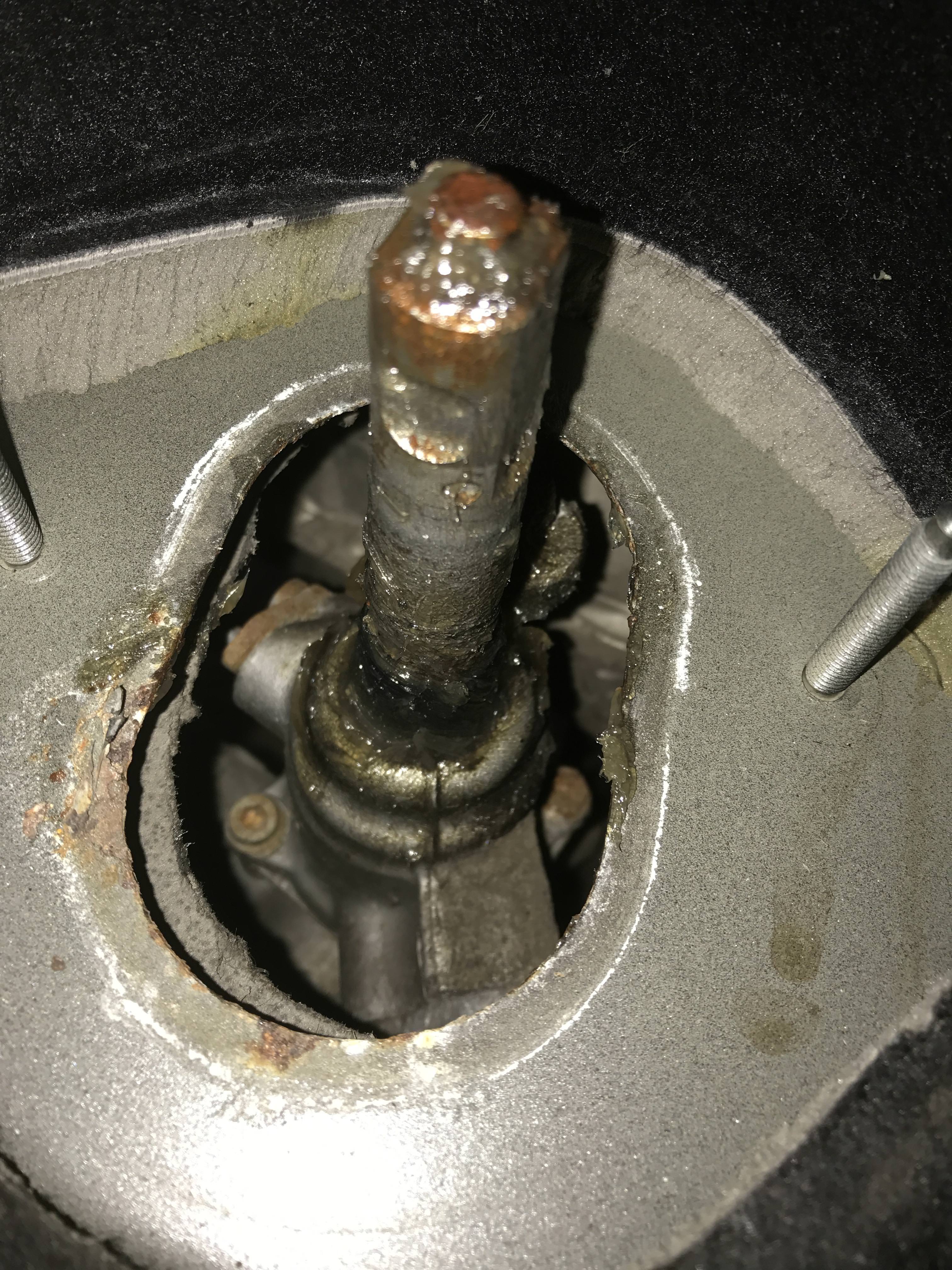

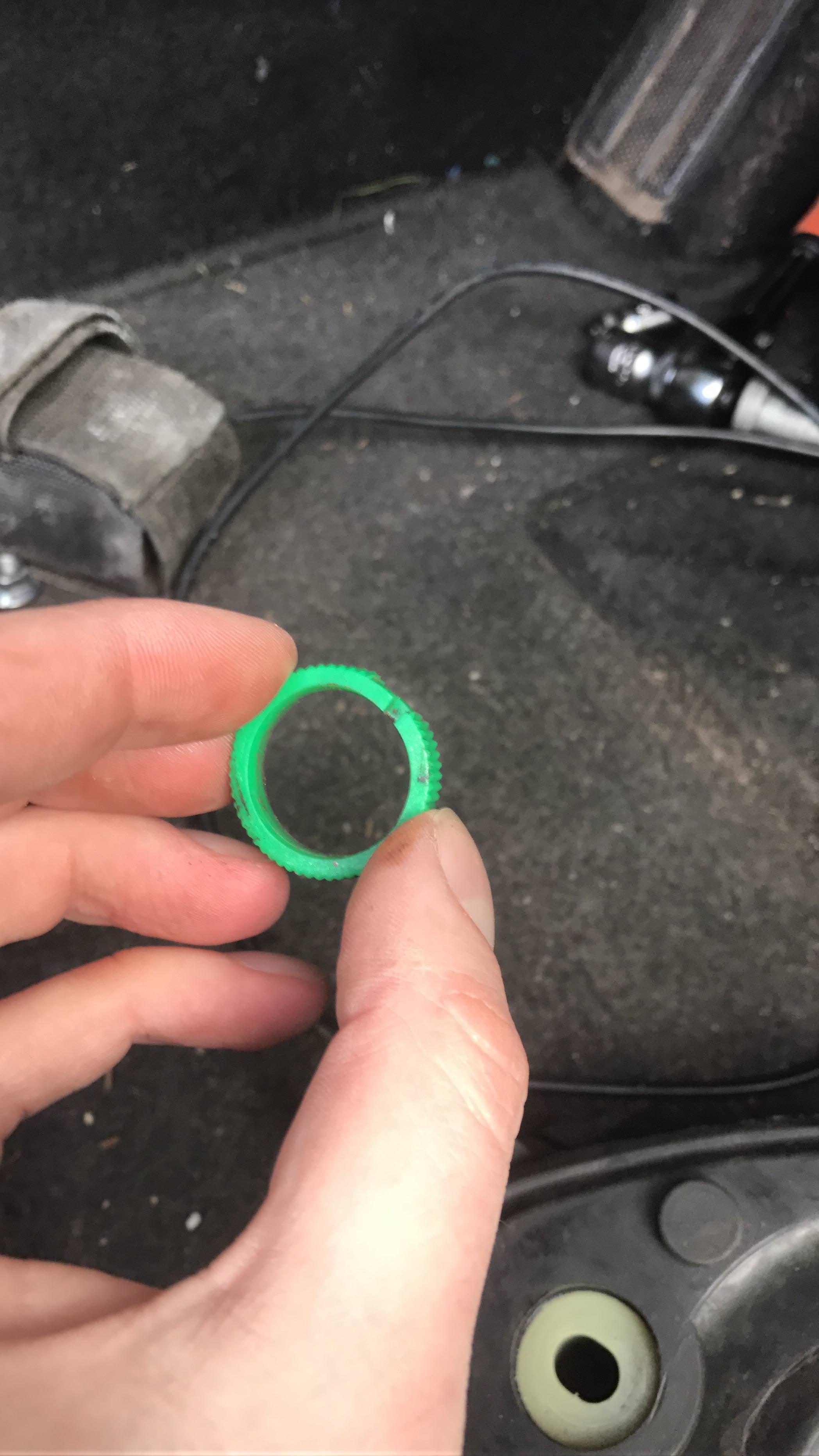

Right then, so today I decided to investigate the steering fully. I detached the steering linkage properly and was greeted with this:
I was very relieved as I was fearing the worst

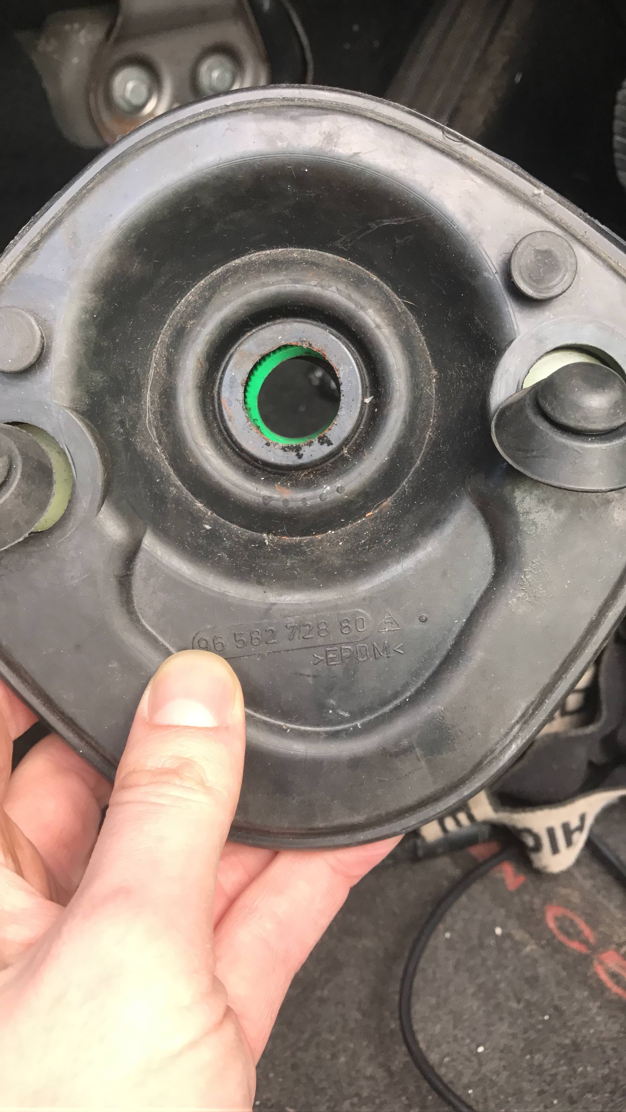

The rubber bung also came wihth a bright green washer that was mentioned earlier:
As Marc pointed out to me the steering rack shaft has a black sleeve on it that starts about an inch before the actual rack. I suspect this rack has already been replaced with the modified new PSA part. In addition, the green washer has a seat in the rubber bung... so I'm not sure if the rubber bung was updated too to allow the green washer to sit in it.
Even though everything looked good I greased everything up liberally and put it all back:
So, I can sleep well tonight

Yes, definitely looks different to Bobin's rack from the other thread Elis - the one he shows doesn't seem to have that additional grey collar that I can see on your one.
That's one less thing to think about anyway!

Looking at Elis' first picture - is that something bonded onto the shaft between the grey rubber ring and the small hole drilled in about 2" down from the top of the shaft ? It looks like it could be some sort of fibre reinforced protection bonded on.... or it's just a trick of the camera

bobins wrote: 30 Mar 2018, 19:48 Looking at Elis' first picture - is that something bonded onto the shaft between the grey rubber ring and the small hole drilled in about 2" down from the top of the shaft ? It looks like it could be some sort of fibre reinforced protection bonded on.... or it's just a trick of the camera![]()
I know what you mean, it lookes almost like chipguard texture. Here's another pic with different lighting that might help:

Is that a recon rack with a pitted rusty shaft that has been sleeved where the seal rubs?

xantia_v6 wrote: 30 Mar 2018, 20:15 Is that a recon rack with a pitted rusty shaft that has been sleeved where the seal rubs?
Potentially, however it was fitted with a green seal / washer that I assume only comes with new PSA parts? I'm not sure though.
