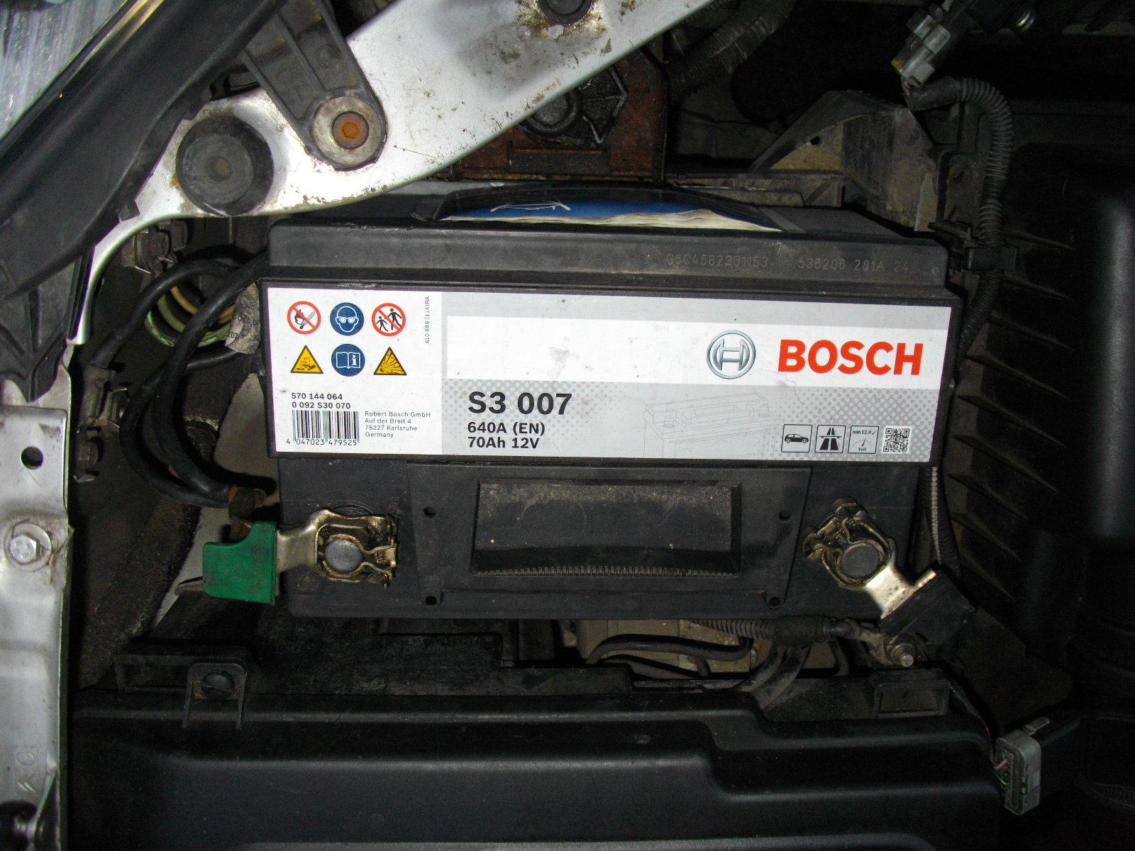

This is mine - been perfect (only just remembered to look)

myglaren wrote: 20 Feb 2018, 17:15 This is mine - been perfect (only just remembered to look)
That looks like a good old fashioned flooded cell to me.
I still think they're more robust than the modern variants of lead acid.
Also a crude way of comparing batteries is by looking at their weights. More lead makes for a better battery.
