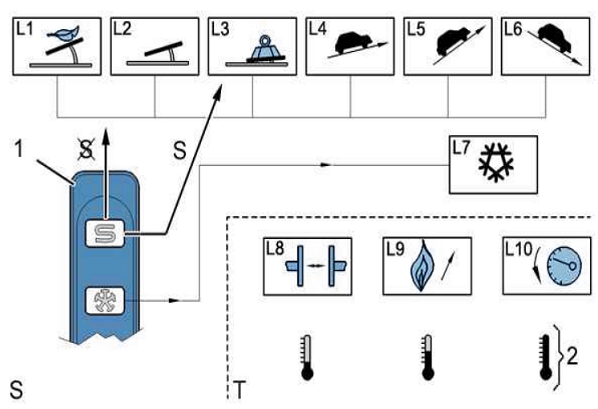

S - "normal" operating laws.
T - Gearbox reheating and protection laws.
" 1" Programme selector connection.
" 2" Gearbox oil temperature information.
(L1) Economy pattern.
(L2) Medium law.
(L3) SPORT pattern.
(L4) BRAKING pattern 1.
(L5) BRAKING pattern 2.
(L6) DESCENT pattern.
(L7) SNOW pattern.
(L8) Unlocked pattern.
(L9) Heating pattern.
(L10) Thermal protection pattern.
The ECU uses 10 selection laws :
  • 6 Auto-adaptive laws
  • 1 Law specific to the "snow" program
  • 1 Unlocked pattern
  • 1 Engine and gearbox reheating law
  • 1 Gearbox Overheating Protection pattern
