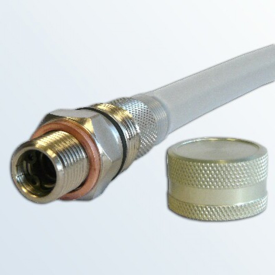

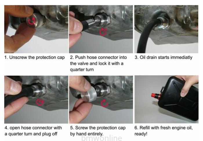

I am tempted by one of these though:
I think the drain plug thread on the 2.0 HDi is M14 x 1.25, so it's about 35 euros..... bit pricey.
