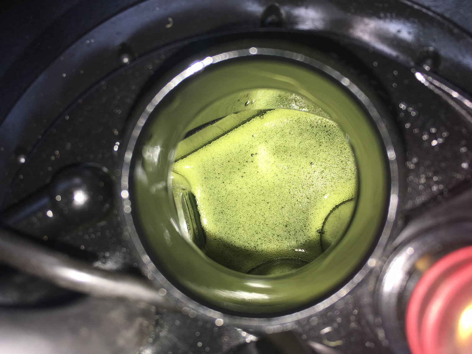

Thanks for the reply by the way Mike.
I didnt actually follow your instructions and REMOVE the dog bone and really get in there to clean it. Ill endeavour to do it this afternoon.

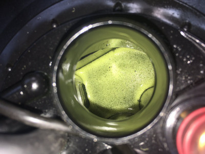

Is it normal for fluid coming back to the tank to be filled with small bubbles?
The bubbles dissipate fairly quickly fwiw

I don't think a failed sphere would cause such symptoms but others would know better.
The plastic dogbone links the height corrector to the ball clamped onto the torsion/rollbar. The clamped ball is the adjustment and is used to set the normal ride height. There is a specified procedure to measure (and correct if necessary) the factory-recommended ride height if you suspect it's too high or low.
Not sure about the foaming either, looks a bit excessive to me though it's been awhile since I've had the pleasures of a Xantia.

Its a Hydractive 2 car. HA2. 98 Model which is the last of the S1 shape with the HA2 system. Both electrovalves are working and opening and closing the circuits from soft to hard mode. I had this issues which was the diodes but I have replaced them and all is well with how that is operating. The issue is not that the car is sinking but raising up a couple of inches which tricks the car into thinking its about to come down and the rear stiffen up to save it from potentially bottoming out. Its not rock hard like when the electrovalves shut but its definitely stiffer.
