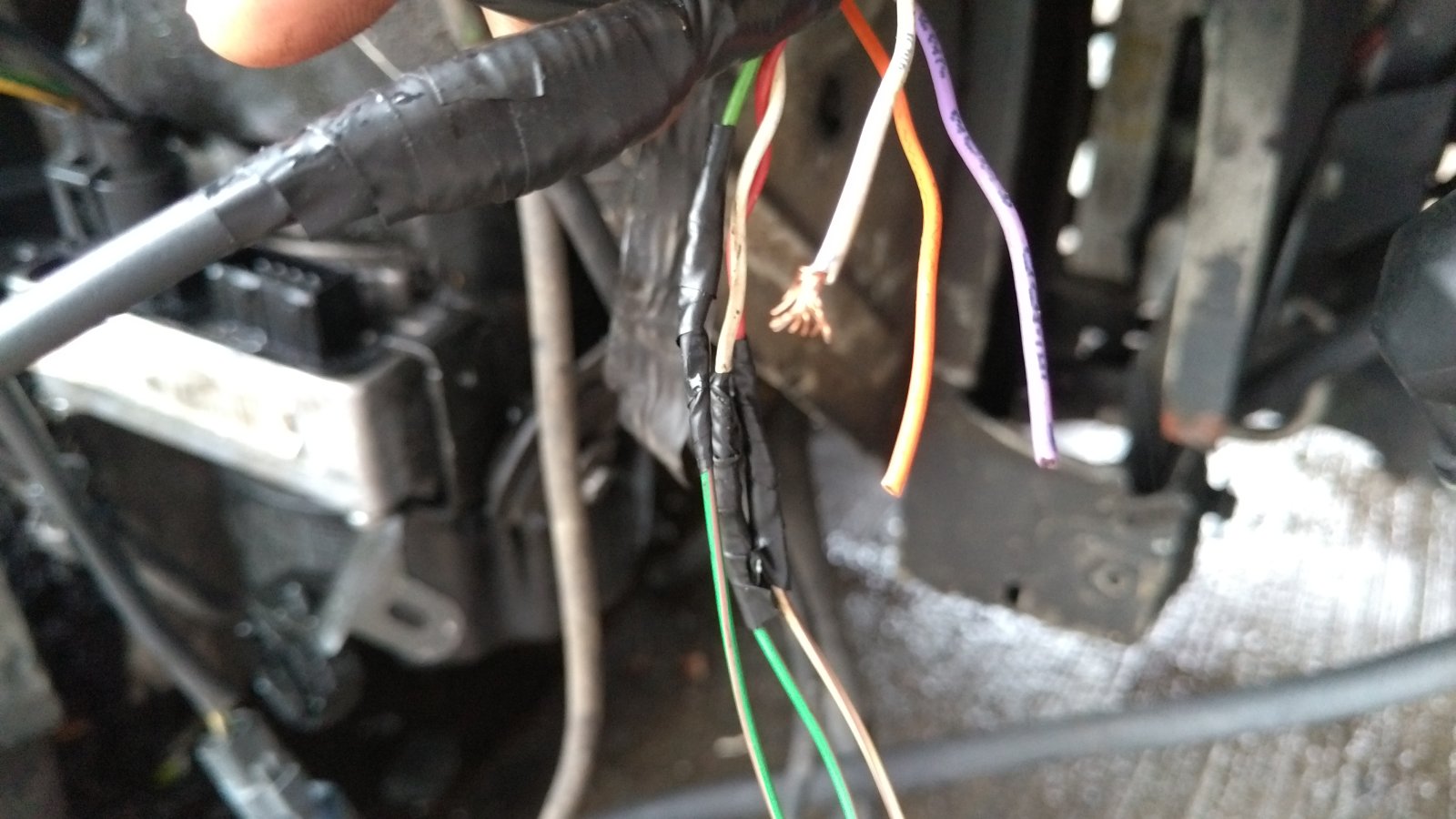

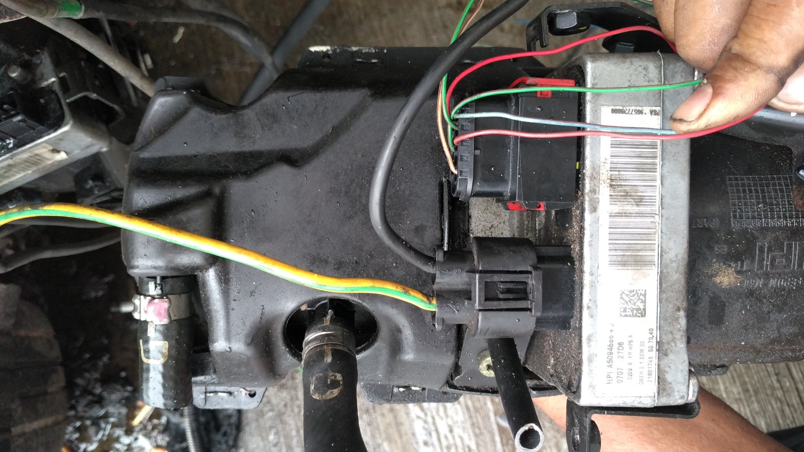

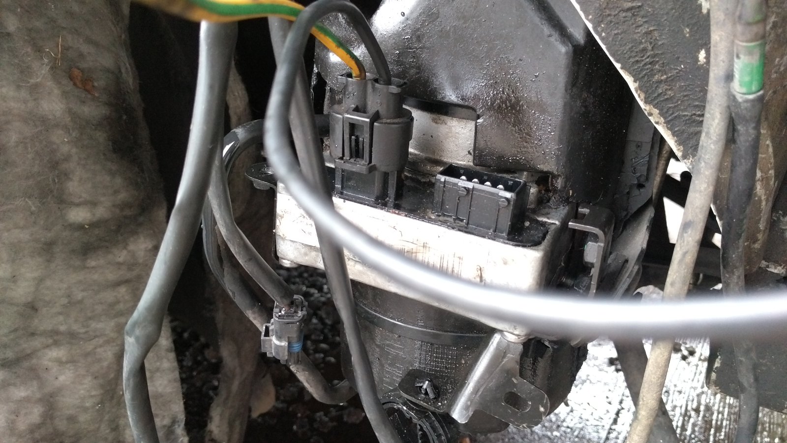

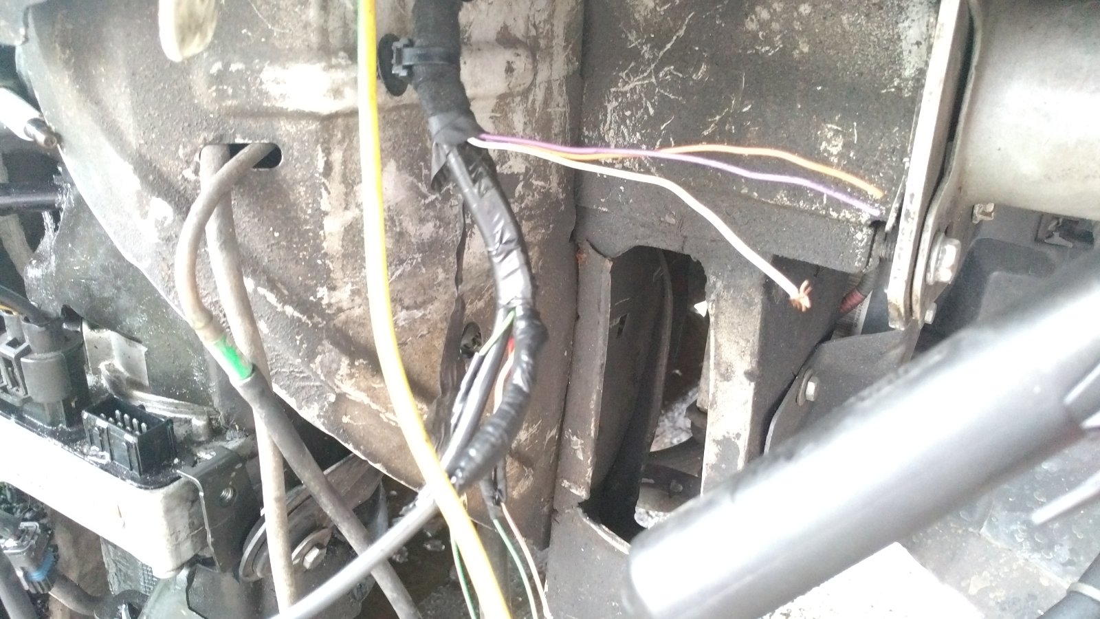

Re: CITROEN C5 MK2 Power steering pump wires
Hi Guys,
My mechanic & Other guy (Thomes fr Indonesia)
Have checked the digrem & comment
They have found & fix the Cable .....
Is only used 3 wires NOT 6 Wires
I have attached the pictures for reference
Thanks for all your help & reply
