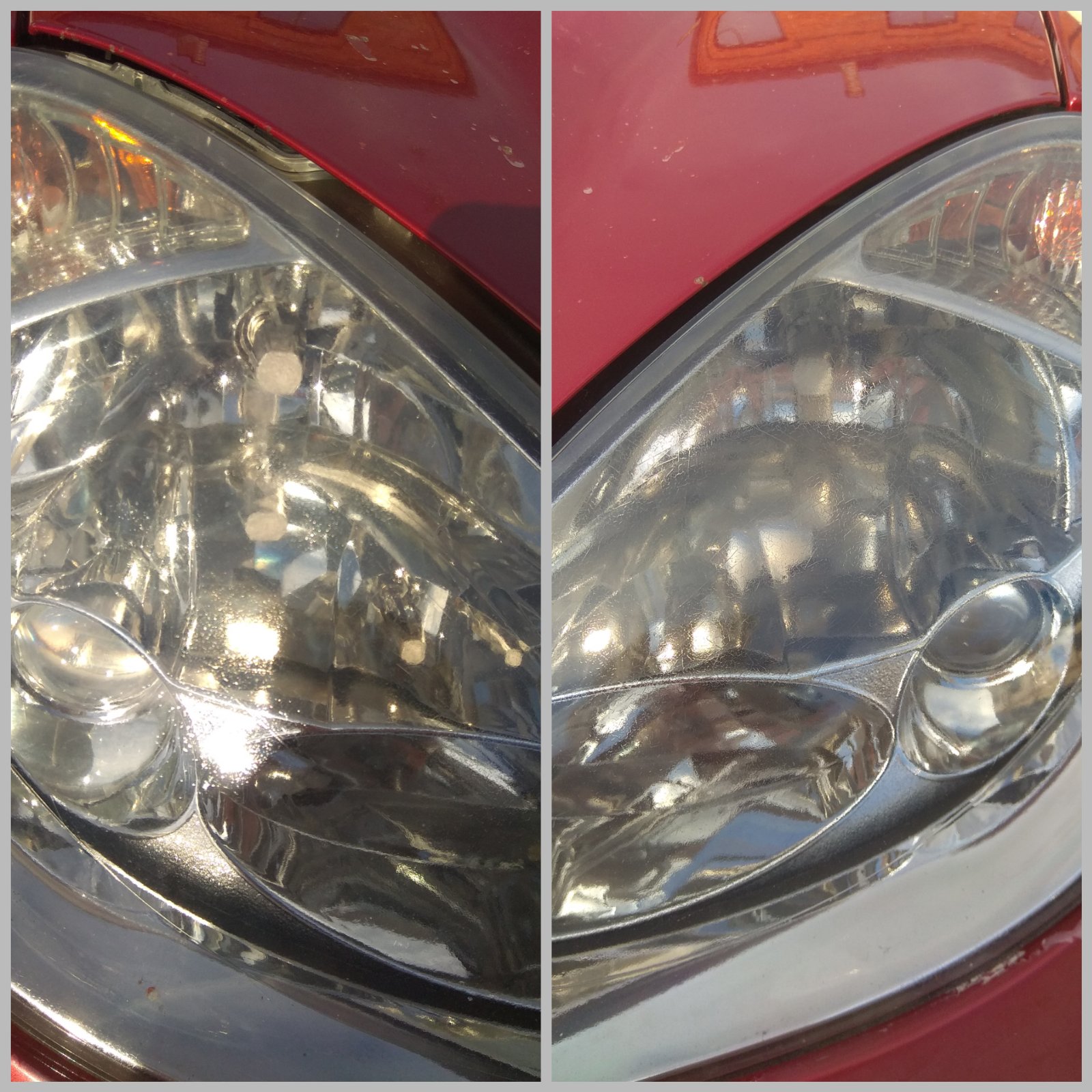

ive done our partner and pops accord units with wet and dry and the machine polisher, 1200 and 2000g then machined with G3, repeated till happy and sealed with carnuaba wax, will pop the pictures up in a bit as on the phone,

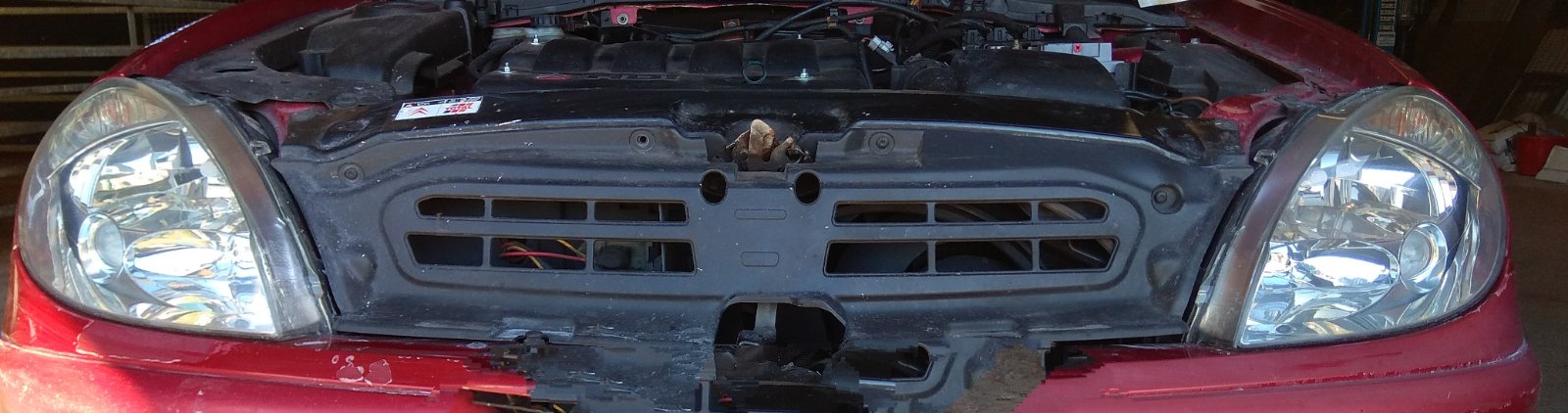

Severe yellowing on V70 cracks and blisters at top, used wet n dry paper started off with a coarse 400, but if yours are just yellow without the cracks/ blisters you can use 600. I didnt use a polisher or grinder for the sanding, best to go one way side to side, but with the c5 ovalish shape i would go up and down change to 800 keep the headlight and paper well soaked then work your way up to 1200 and finish at 2000, then polish off with a drill attachment polish sponge or buffer and shine, you could wax them to stop sun damage. Makes a huge difference when you see the results.
