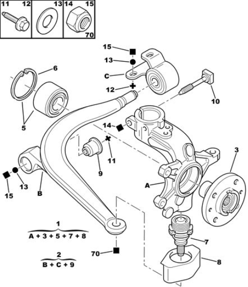

So I went to see the wonderful CitroJim on Thursday.
Oh dear. The front bush does need doing as I suspected but also the front flexible mounting of the nearside rear subframe too!!! You wouldn't believe it. Just hope the part is still available otherwise I'll be trying to stabilise the mount with some silicone sealant. Might actually try that first.
x 6957
Re: Xantia - Replacing strut tops and hydraulic pipes
If it's any of these, let me have the item number and I'll check what's available:
Posts: 14308
x 3306
You might find it easier to replace the wishbone (rather than the bushes), as everything will (assuming a decent maker) be lined up properly. If the 'P' bush (item C) is not aligned correctly it will wear out fairly quickly (although I am sure CitroJim would have told you this).
