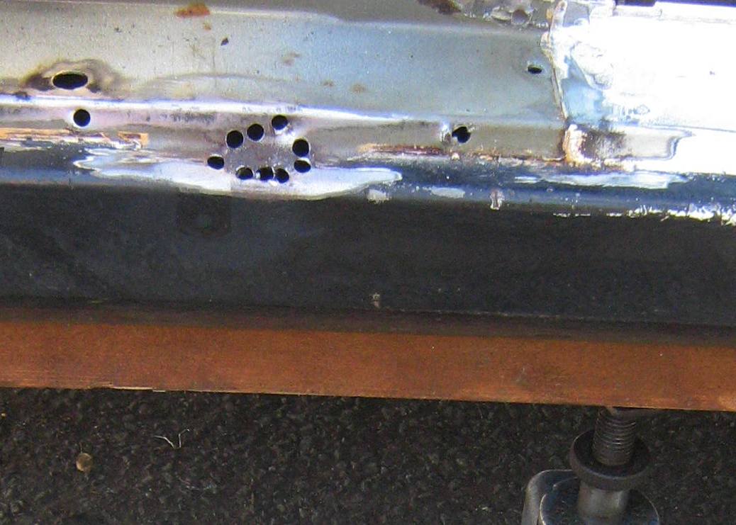

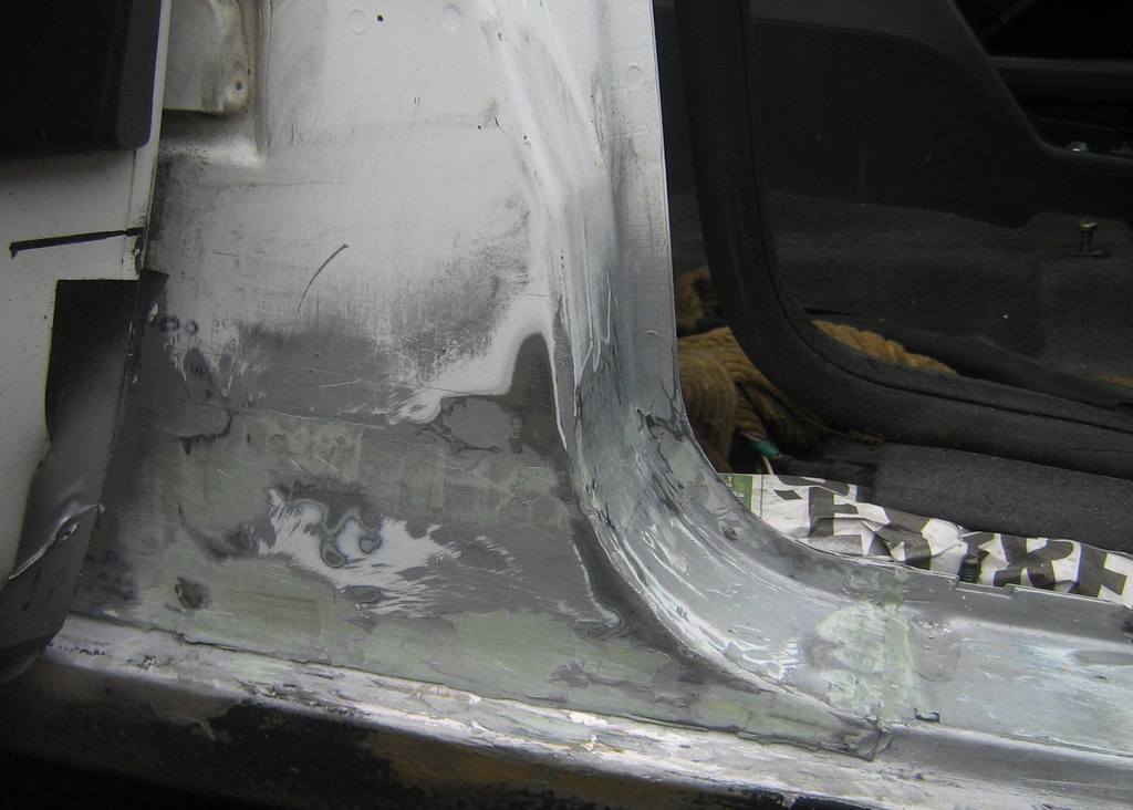

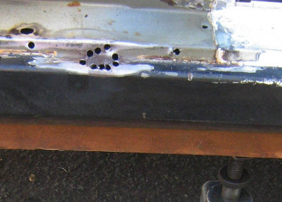

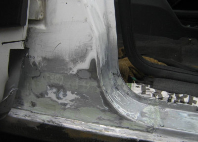

Uploading the latest pics to my PC, thought I'd attach a couple of copies as a 'FYI Update'
Puxa

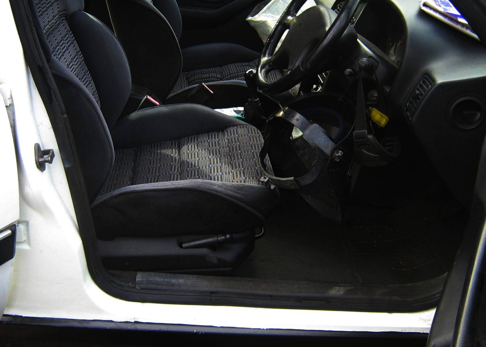

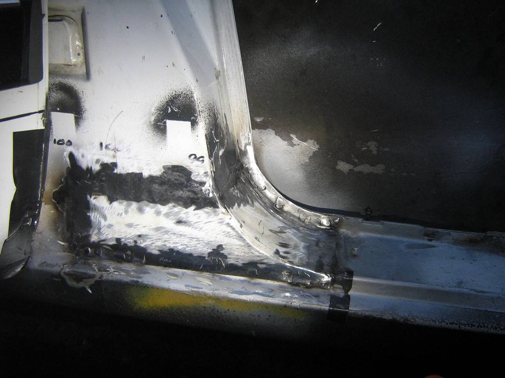

Further pic, nearly there
....that's the 'proper' and very common (in its day) white rather than the creamy white
I could pay 20squid or thereabouts to have Alpine White mixed, but that's not gonna happen. Barring advice here its probably gonna be Ford Diamond White
Puxa

No progress today, hoping to avoid removing the rear door in the course of getting it all flatted & skimmed (filler) tomorrow. I did already remove the card though, so will have the 'joy' of refitting the interior button at a later date, proper PITA job.
Nipped into an independent accessory shop earlier, it seems the whole 'paints' thing has changed, there's various 'shades' of metallics and non-metallics in the different colours. I've picked up a can of Holts HCR03, its a white and it's one of about three that have been in use since the 1980's, so fingers crossed
..and at the end of the day, it is only a B Pillar.

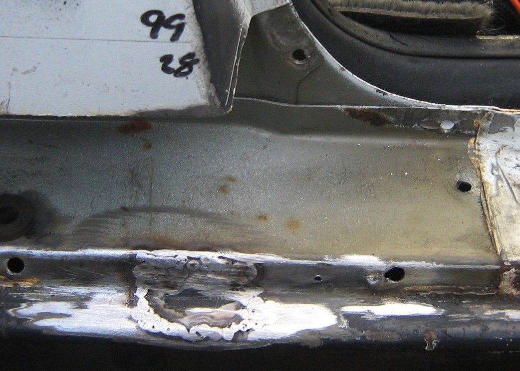

further couple of pix just to 'close' this thread....
Just a slight skim of filler
then lots of time faffing about with sandpaper, paint & masking tape
Its not perfect, but its not half bad...
