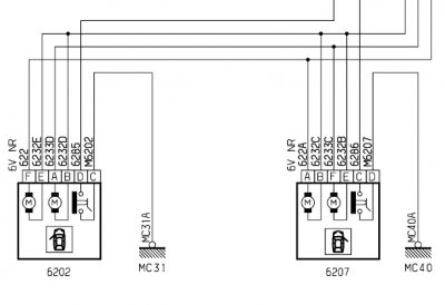

Ok, the most common areas are a broken wire inside the rubber tubing that protects the wires - these can break. You may be able to remove the grommet and check the wires that way -
On this diagram, the wiring plug should be a 6 pin black plug.
6202 : front left-hand door lock assembly
The wires are:
622 : deadlocking + control
6232 : closing locking output
6233 : opening locking output
6285 : Left-hand front door open switch input (BSI)
M6202 : EARTH m6202
click to zoom

C2 central/deadlock help if possible please...driver and passenger doors suddenly won’t work with key fob. Tailgate works however...can not open doors from inside car...solenoid operating but doors not unlocking...forced to open driver’s window and manually unlock.Any solutions out there?
